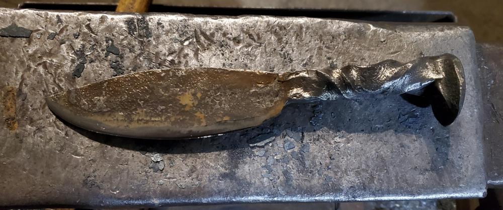

I just started forging a couple of weeks ago and started with a Forge a Railroad Knife class.  It was very accessible and fun.  I've since joined the community forge in my area and spent a few hours last week just making a couple of leaves which let me practice some skills and start building some arm strength.  This week I'll probably try making some scrolls.  I'm definitely hooked :)

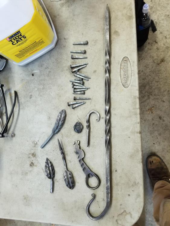

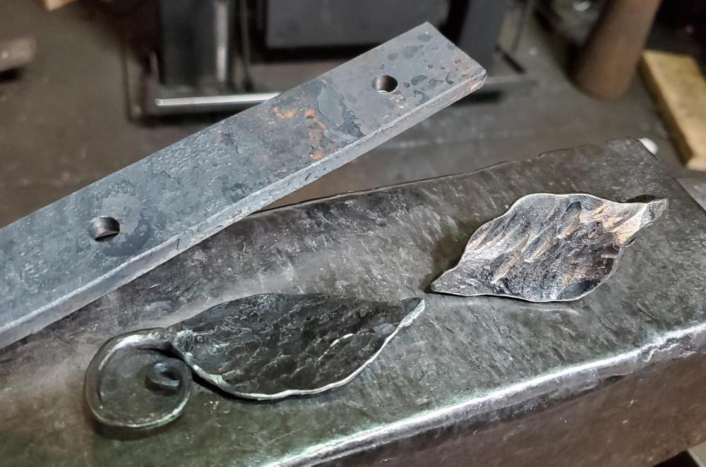

First things I made at my first class were nails. Lots of nails. Then leaves, several of them. Then a flower. Then, a horse head bottle opener. At that point, we were allowed to do what we wanted so I made a fire poker, a wall hook, and another opener.
Very enjoyable, and highly educational!

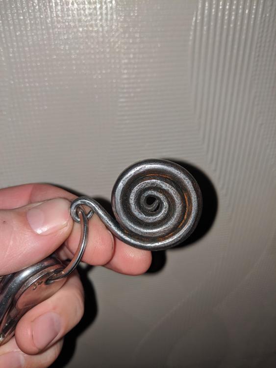

The first thing I forged when I went on my first course was a scroll / snail key ring.  I thought it was a great first project. 6mm round bar, draw out and taper both ends, coil it in to as tight a scroll as you can (I took great pride in not having gaps in mine) then a reverse loop on the end to form the head that goes on your keys. It's been on my keys ever since.
It's a great first project because it only takes a hour to make, has a few different skills and every time I pick up my keys in the last few years I remember making it.

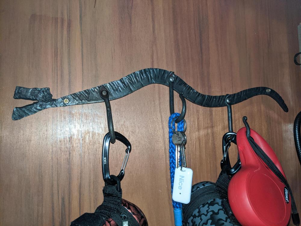

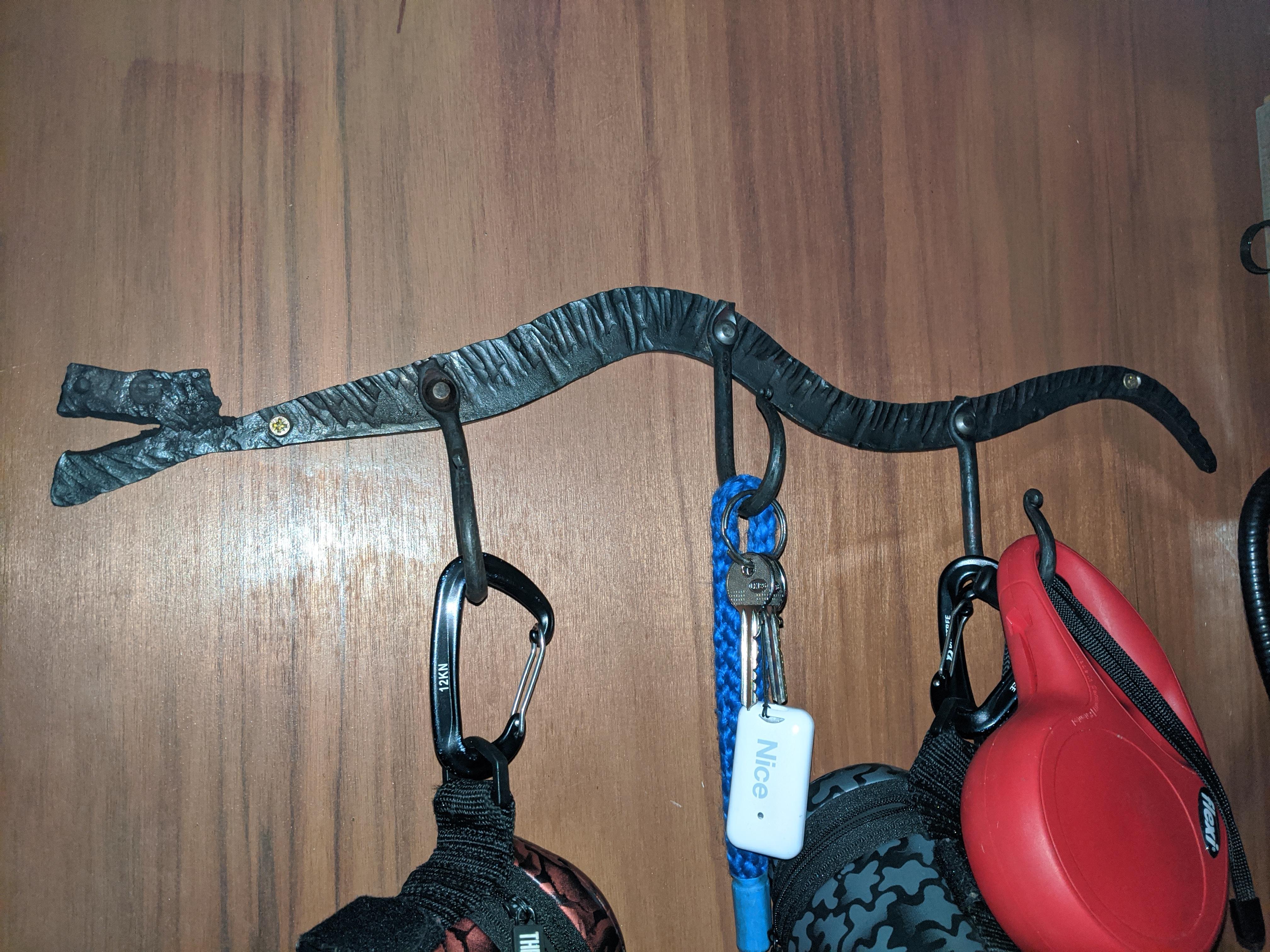

That was the first hour of the course, after we all made a dragon coat rack. 25mm flat bar, isolated  a head off the edge of the anvil, split it to form a mouth, punched an eye, drew out and tapered the tail, bent the whole thing in to a more sinuous shape, made 3 hooks, punched holes in them and the dragon and riveted them in place.
That sits by my door with the dogs lead hanging on it.

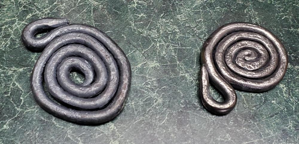

I liked the spiral idea so tried it yesterday.  Definitely tougher that I originally thought.  My 2nd attempt is the one with the tighter spirals.
Great practice idea.
I have a tool to help make them---it's a flat plate with a piece of angle iron or a sq bar welded across the bottom and a hole a little larger than the wire size drilled right next to the outside leg of the angleiron.  Put it in your postvise, heat the wire and make a 90 deg bend in the end, reheat, drop the bent in in the hole and close the vise to trap it between the dependent angle/bar and run around the vise scrolling it. When cool, reheat and repeat.
I also freehand them using light hammers. You can help pull them tight by flipping one over and pulling it against the side of the anvil and with pressure on the straight wire tap it a bit on the wound part against the side of the anvil.
I've done spiral ended pins for my mortise and tenon post and beam tent frame and even pillar candle holders with the part held by the vise trimmed as a spike to mount the candle on and then the loose end bent up and over to make the handle.  I found that the heavy wire used to ship rebar bundles with makes a great thing to recycle.  Very soft under the hammer and often free.  (Not rebar tie wire, shipping wire from places that don't use banding.)
I don't remember who posted it, but a few years ago one of our members posted a way to get tight spirals just using the jaws of the post vise.  I think he was making small candle holders at the time, but the same principle applies.
You can draw a short taper on the end of the rod and turn it for the center of the scroll, then you heat the stock and clamp the scroll's center in the vise and bend the standing end over it. When you get to the vise loosen it, rotate the scroll in the vise, tighten, bend it down, loosen rotate, repeat. One trick to making this a really fast method is rotating the scroll till the standing end (the part you're holding) is almost in the vise jaws on the far side of the scroll this way you get the most turned onto the existing scroll. The larger the scroll the more stock gets turned and faster it goes. When you close the vise on what you just turned they flatten it all nicely so it's flat and even.
I hope I've muddied things sufficiently, if not let me know. :)
I do mine with a hammer and anvil and the final loop is formed with a pair of long nosed pliers.
The best way I have found of tightening the spiral is hooking it over the horn and a few taps with the hammer.  Probably not the most efficient way but I'm still learning to move the metal.

As for the spiral, best way is with a jig like Thomas and others have mentioned to avoid hammer marks on the face of the spiral.
I do mine like Dax, hammer & anvil although I use the edge of the anvil to taper and make the first tight scroll. Then the step to get the first several coils. After that I move to the vise to make it larger (more coils) and a rawhide or wood mallet to keep it aligned on the anvil.
