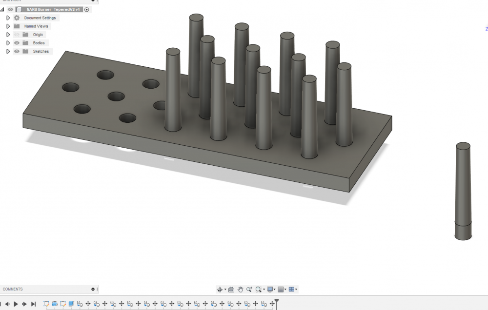

I was thinking of trying an experiment with 3d printing the NARB form instead of using Crayons. Then I could make it all one piece, and maybe create a small cone on each orifice. Not sure if that would do anything to aid in performance, but all other burner designs have a flared end.
Thanks again.

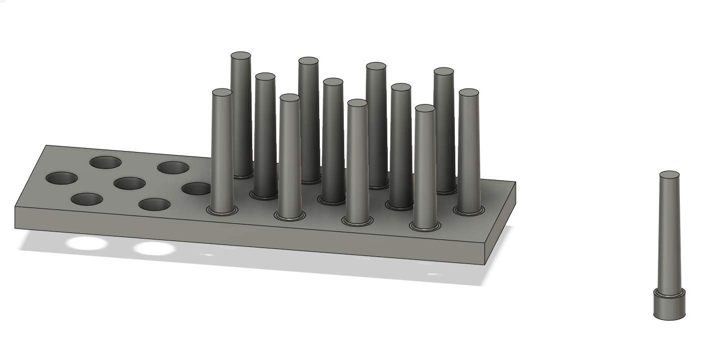

If you're going to 3D print the burner block form why not taper the entire length of the outlet nozzles? Just make sure they don't exceed a 1:12 ratio.
Keep us in the loop please. :)
Good point. If I were to taper the entire hole length, what are you thinking would be appropriate for outlet diameter? Thinking maybe the small diameter should be 5/16", and taper to 3/8" on the outlet end? Just thinking out loud as I have know idea how the flow would react to being tapered in this type of burner. Thanks!
No idea and it'd be a bear to model the way I did before. Taper the Increase a few thousandths and see what happens?
I was modifingmy post above with dimensions as you were posting. LOL!
Did a quick model. This has a base plate that would be removable from the plugs. That way, in theory anyways, you could pop the plate off and maybe be able to twist out the burner orifice plugs one at a time. The plugs are 2" long tapered from 5/16" diameter at the small end to 3/8" diameter at the large end. The tenon on the bottom is .500" diameter and .375" long. Spacing side to side is 1.080" and .928" diagonally. (Don't ask why I used odd spacing. LOL!)
Thoughts?

Of course I have thoughts,:rolleyes: it helps keep the voices from arguing.
Yeah, How about using tapered wooden pins with a thinnish rubber outer sheath for outlet cores. They could maybe insert into the board with a tapered head similar to your rendering so they're reasonably liquid tight. I wouldn't extend the rubber onto the tapered head you want it to come free easily.
When you make up the mold each core has a well lubed wooden pin to hold it's shape. When the refractory sets up, a pass with an air hose over the ends of the pins in the base board will break contact with the rubber skin and with the pins removed the rubber skin should just pull out.
Another thought would be to rig a fitting to inject water under pressure into the plenum through the fuel air inlet and force the cores out of the bock hydraulically. Once the wooden pins are removed that is.
Hmmm? What do your voices think?
Well the voices in my head are arguing right at the moment, so it is making it hard for me to find the right thoughts. LOL!
Yes a barrier between the plug and the refractory would be a way to go. Not sure how the rubber lining would be made. Perhaps via dipping it in an aqueous solution of latex?
The thought that comes to mind is being able to make this as simple as possible. It would be nice if the tapered plug would come loose without damage. Then the whole unit can be used again. That would be another benefit of a tapered plug is that you would just barely need to break it free and then it would come out easily.
This leads me to thinking that I could make the plugs with the tenon being the same diameter as the base of the plug. So instead of having it .500" make it .375". Only problem with this and the reason I went .500" is that it allows me to have a fillet at the junction of these two points to make the casting more clean. However my reasoning behind a .375" tenon is that I can print it with a very thin and continuous spiralized wall. This would serve two functions. One is that it would essentially produce a very fine thread if you will on the outer surface which might make removal easier, maybe even screw it out. Secondly, it would be thin enough that it might be possible to twist up and remove, yet still be strong enough to hold its shape. Like twisting up a plastic straw.
Oh, too much thinking and complicating me doth do.:D
Edit:
Here I quickly changed it to what I was describing.
You should buy some of the refractory you wish to use and find out how sticky the stuff is. I used Kastolite 30 and have never been able to pull anything out of it. Dowels dipped in wax wouldn't come out until the test coupon was hot enough to melt the wax. I tried coating it in stiff grease, that one is still stuck, Crisco seems to be the best release agent I've tried so far.
Not being able to pull cores is why I use crayons.
Other guys have made cores and pulled them but they don't wait till it sets completely I believe.
There are other guys who have gone way farther than I did and are much better at making multiple outlet burners. WAY BETTER at it.
I still have thoughts, can't seem to help it.
