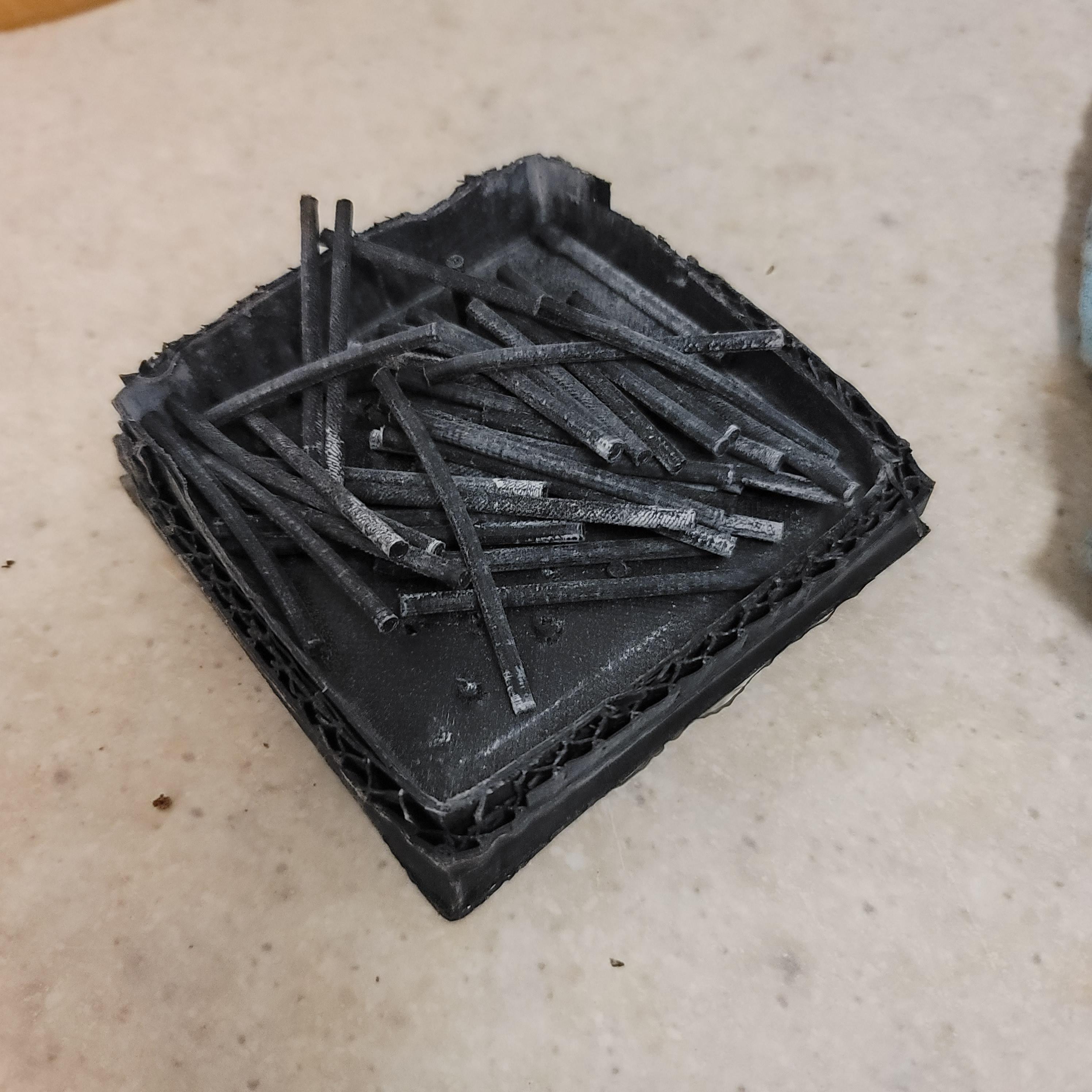

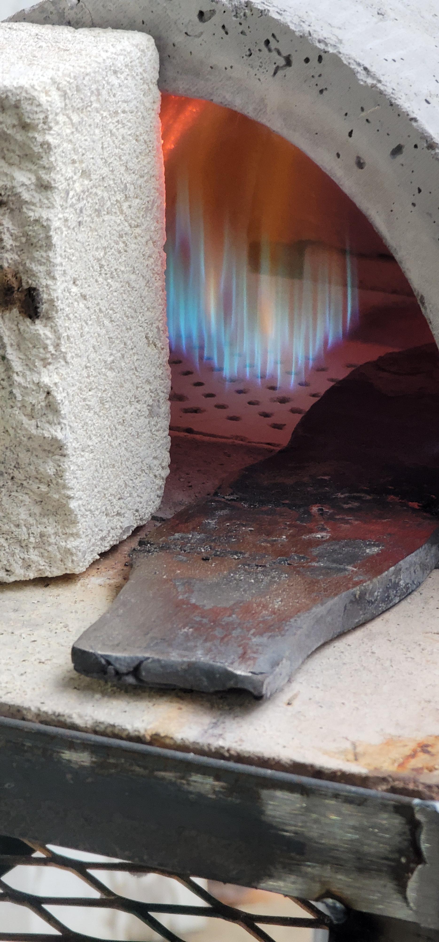

I had some leaks in the last one at the plenum refractory junction so I rebuilt it.  This one came out much nicer aesthetically.
I sprayed the pla mold with WD-40 for a release agent and the sprues pulled out without any incident.

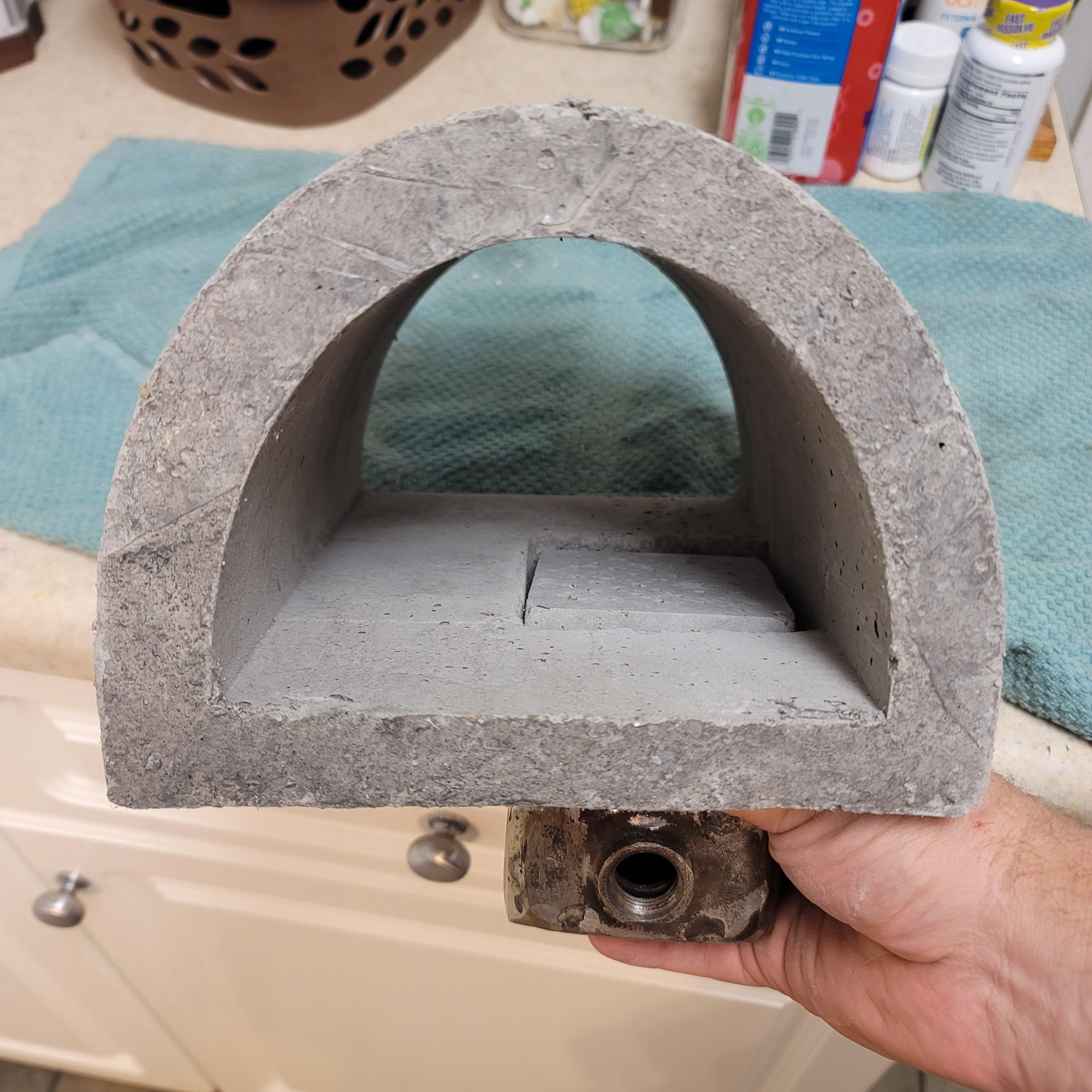

I also cast a new forge body.  I realize by making it of refractory and being so thick it will take some time to heat up, but it should make it more resilient to travel.  I am looking forward to firing it up this weekend but it still has some drying and a coat of ITC-100 to go before that.
The volume comes out to 155.455 in³.  It should be a good weekend.
If I do have to make another ribbon burner mold, I need to extend the sprues or tines or whatever you want to call them and make them stick above the level of the edge of the mold.  I had to drill out the holes to get air flow through them.  Learning is fun.
That makes it easier. I'm surprised you got WD 40 to work as a release agent, I had to settle on sticky grease to keep the refractory from actually bonding to the mold.

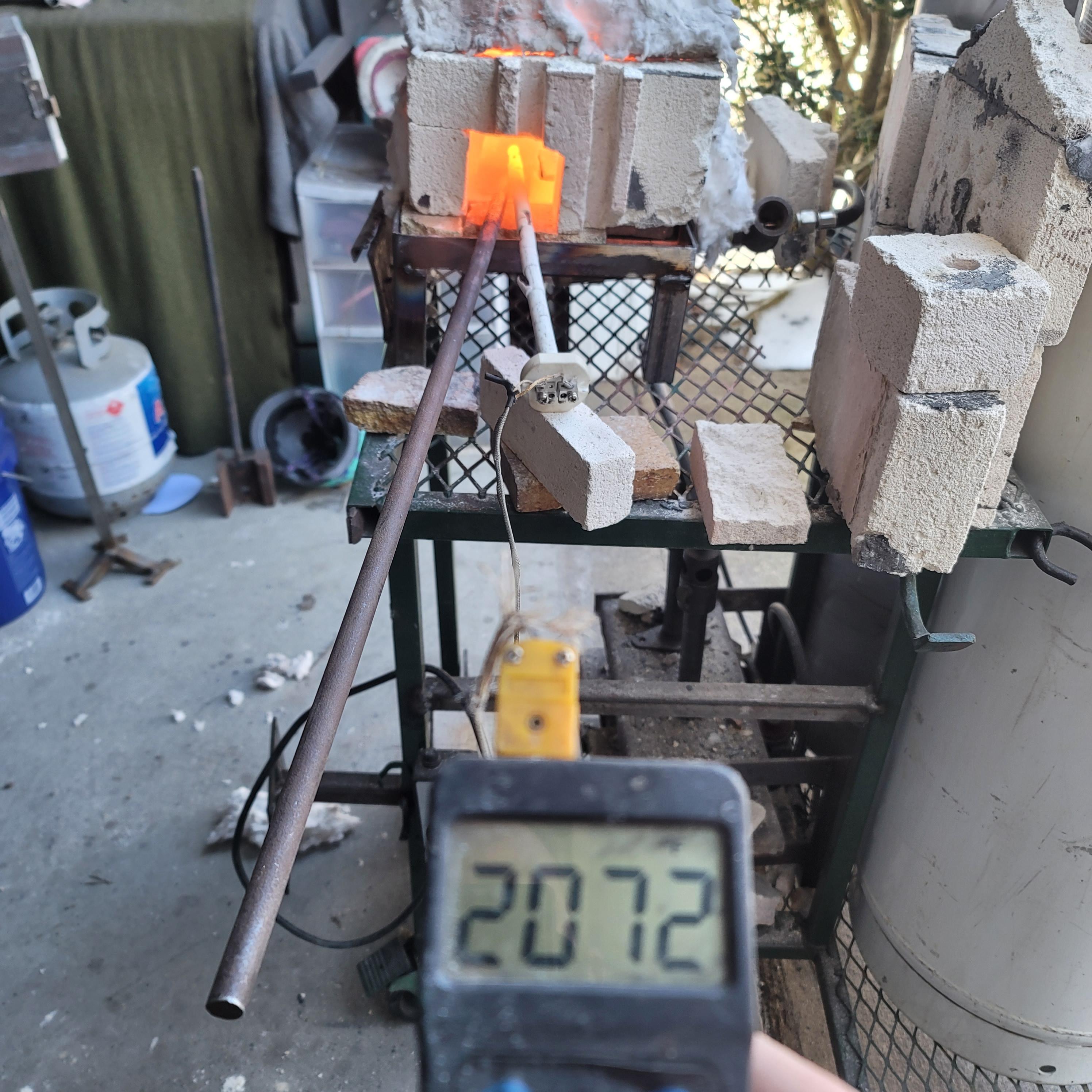

I fire up the forge yesterday.  It does take forever to heat up because of how thick the refractory is but it seemed to be working well.

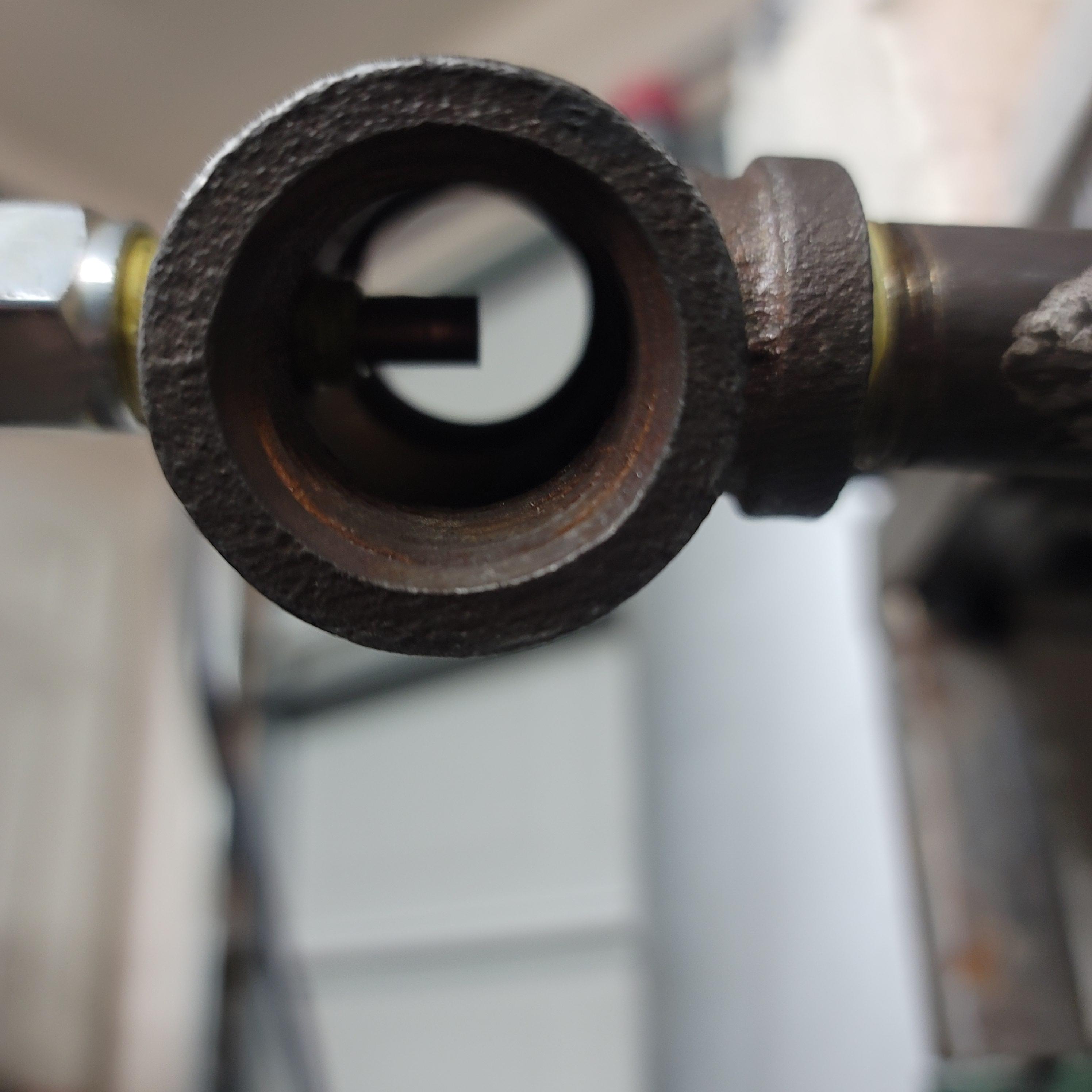

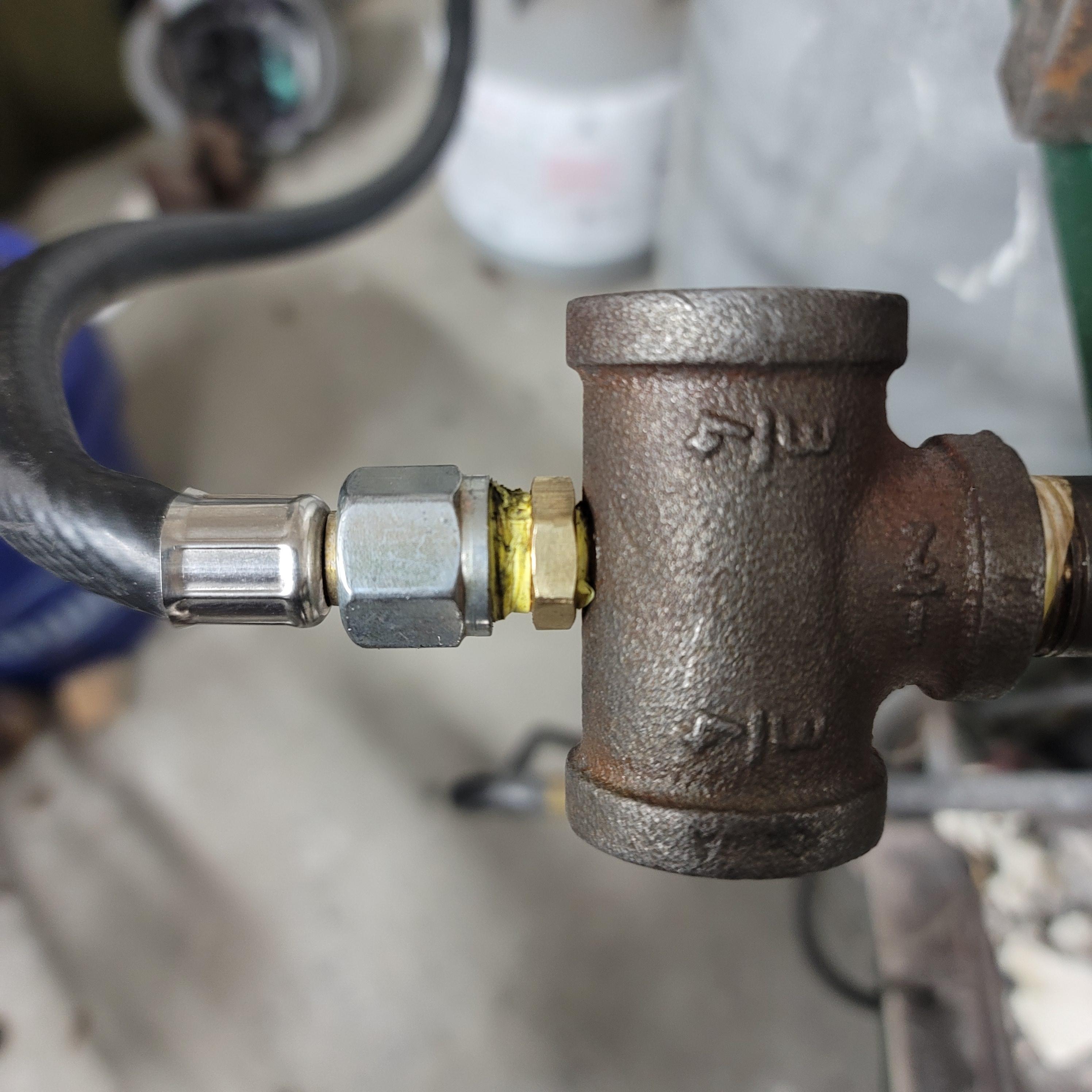

Since is was still running slightly rich I decided to try amd tune it for a more neutral flame.  I ground a bit off the tip of the MIG tip, put it back in and now, for some reason it is running super rich.  I didn't get any pictures but something went bad.  I wanted to keep working on the problem but it got really cold and I was coming down with something, so I stopped for the night.  Still a little under the weather and it's still cold so I don't think I'll get to troubleshooting what went wrong until some later date.   I'll post pictures of how rich it ran next time I'm out in the shop.
This may seem a little counterintuitive, but I'd start by making sure the mig tip orifice was free of burrs and debris.  We shorten the tips to help induce more air, but if there is any restriction or deflection of the fuel stream it can have the effect of inducing less air.   If you did run a torch tip cleaner or something similar through the mig tip I guess it's possible you increased the orifice size a bit which could produce the effect you are seeing.
Another thing to check is the axial alignment of the tip with the mixing tube.  Sometimes things don't get lined up when we replace the tips as they were before we removed them.
P.S.  I know it's just a photographic perspective thing, but your first pic looks like the back wall of your forge is the propane tank and it's glowing. It made me shudder a bit when I first saw it.
Ha, that would make me shudder too.  No, it was a fire brick.  It also had another wall of fire brick between it and the tank.  I do some stupid things in my life but I've seen too many of my friends blown up to want to blow myself up.
That said, I did run a tip cleaner through it.  The issue was, most likely, a small leak at a junction which was lowering the pressure at the MIG tip and thus lowered the mixture of oxygen.

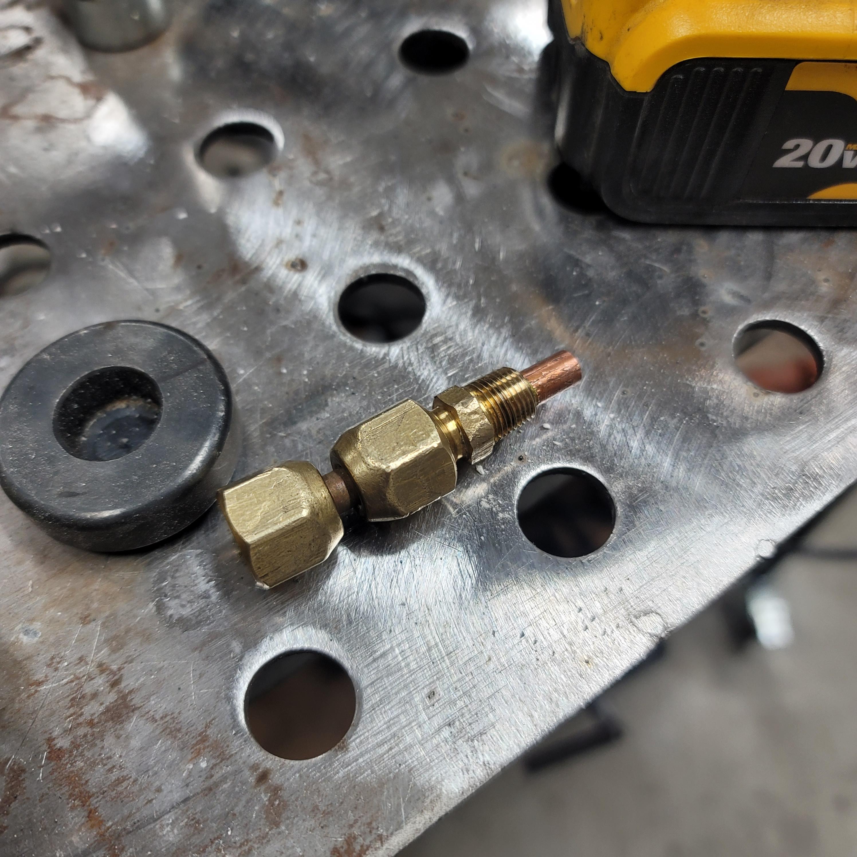

I took out some superfluous parts and re-tooled the attachment of the MIG tip to the T burner.  It was slightly crooked before as I tapped it by hand.  Now that I've got a lathe it made tapping straight much easier.
The extraneous parts
the new attachment
20220122_135029.thumb.jpg.4042cbf4705a01ee5f069427a5c24d5e.jpg20220122_135044.thumb.jpg.45196f9347e4da34a515127200047546.jpg
I've, since this picture, ground the MIG tip back a bit more.  I think I'm still having an issue with velocity.  I figured out the my area with the 41 1/8 inch holes is roughly half what you, Buzzkill, have with your 14 9/32 inch holes.  So I'm printing another mold to cast another burner with 14 9/32 inch holes.  Should be ready in a few days to try out.

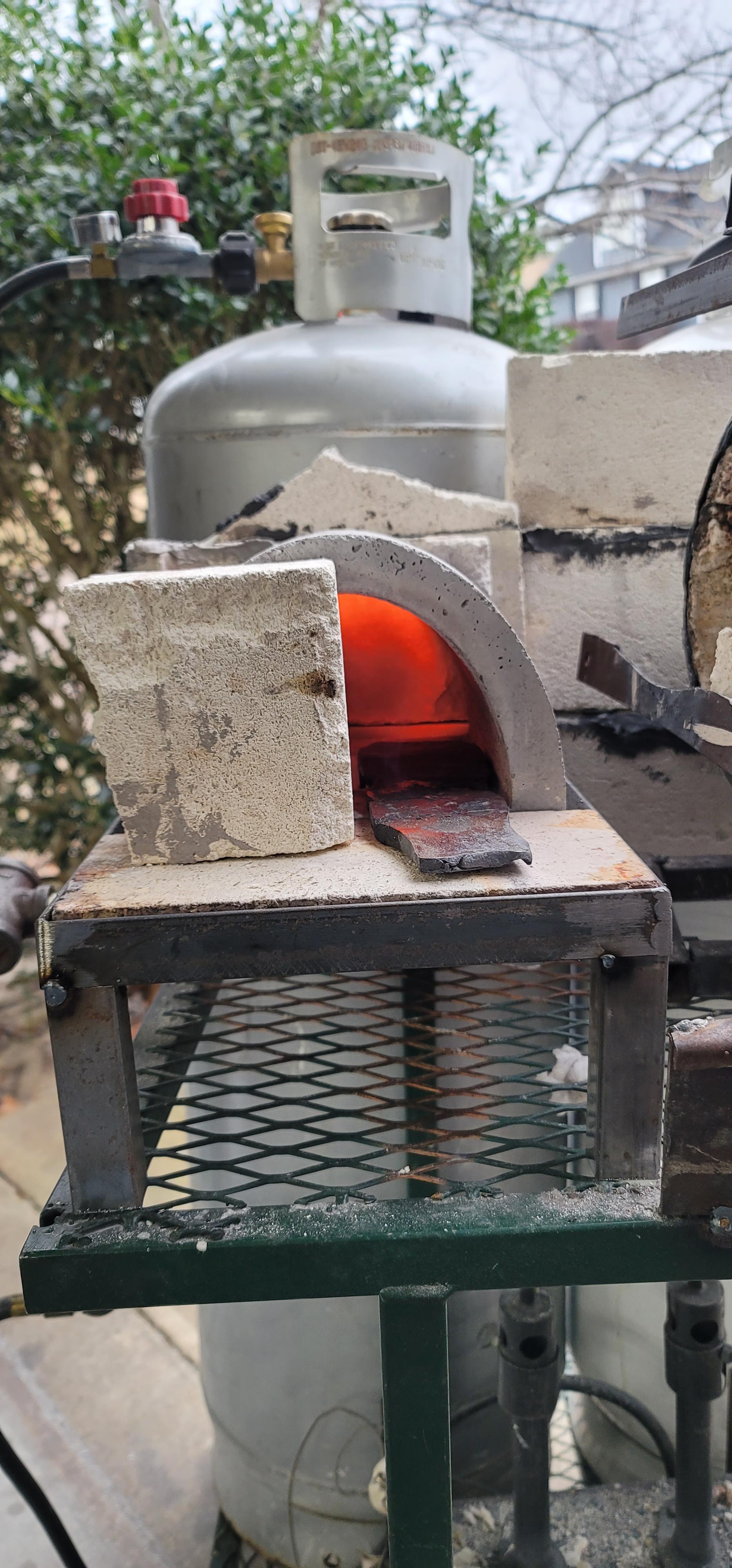

I also am continuing the build.  It needs a lot more insulation.  I'm going to build a box to surround the refractory so I can have a minimum of 3 inches of kaowool above it.  The bottom is only going to have 1 inch of kaowool under the refractory which will hopefully be good.
Despite all that I was able to get bordering forge weld temps with only 1 inch kaowool draped over it.20220123_133053.thumb.jpg.457c9d474b49dbf240d4c4e62956099e.jpg

I really liked the idea of the floor mounted burner in a D shaped forge, and it did perform well, but the loss of so much floor space changed my mind so I went back to a side mounted NARB for my latest build.

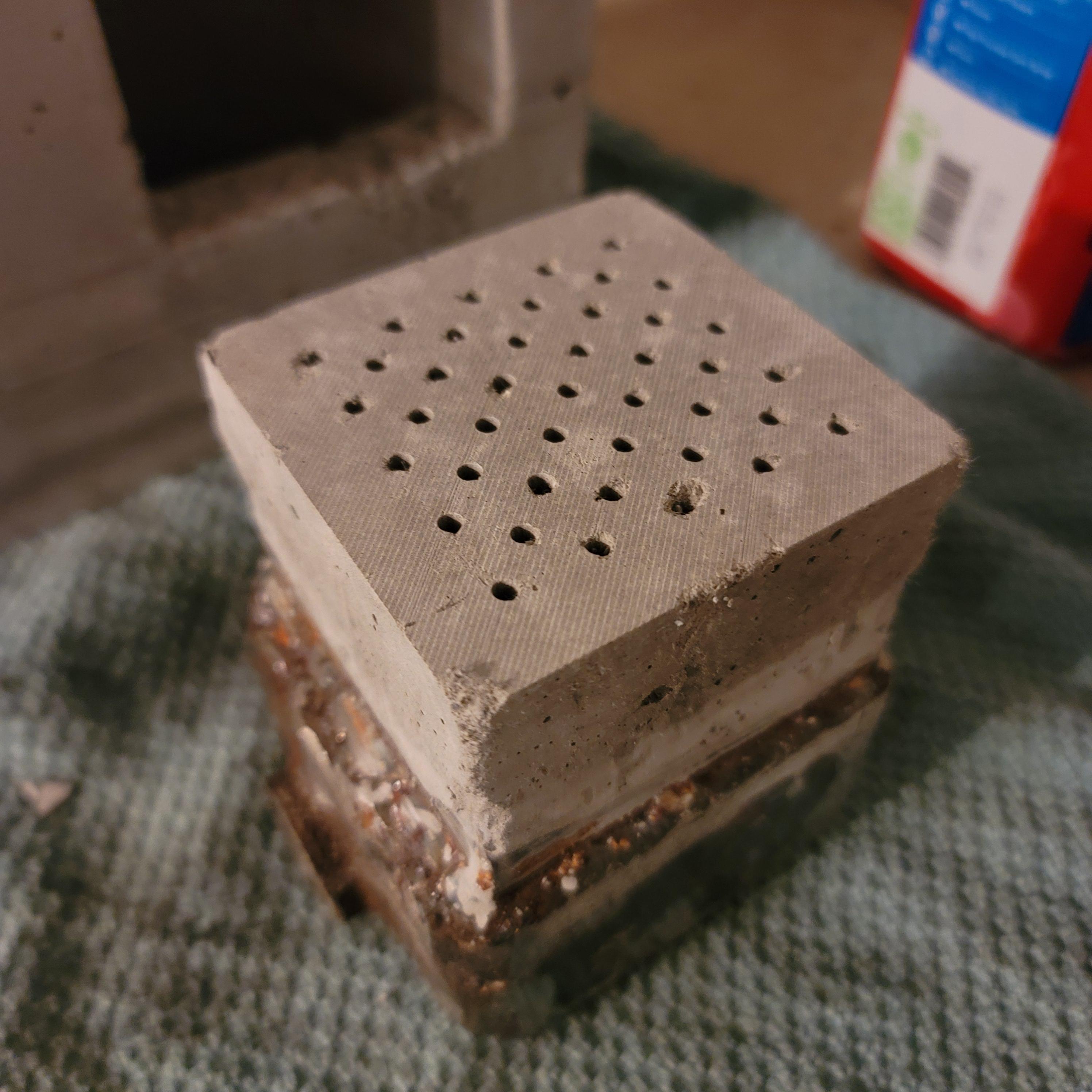

I don`t want to necro post; however, I have some questions and maybe some relevant input to this topic. I have read this thread well over 5 times in my efforts to make a new narb forge. I've watched Ron`s you tube videos and seen every thing I could about the variations which have resulted due to frosty`s initial sharing of this great innovation. I have recently copied frosty`s design`s (more or less) first with t-burners and flares and then put his ribbon burners into the first stages of testing. note- due to some of the reported burners heating and burning back into the plenum when running for longer times I increased the mass slightly in the hopes that the extra refractory would allow the gasses to keep the plenum cool enough to minimize the burn back.
This is the first time that I have built a t-burner (4 actually) when I initially did my research to decide what I wanted from my forge I decided to copy the Ron Reil modified side arm burner. I chose this due to my reading something from frosty stating I think that his burners would start to huff at psi less than 5. I run my burners with an idle circuit for normalizing at next to off. The slightest adjustment would kill the burner and the 1/4 dial is adjusted 1/16 to raise or lower forge temps by 5 or 10f deg.  I have used side arms in my main forge for 4 years now and run a thermocouple to help alleviate my inexperience at telling the correct colours. Due to the chokes on the side arm burner I use my main forge with a muffle pipe to hold steady (3deg fluctuation-usually due to wind) down to 1350 for heat treating. The side arms are running .23 tips. This does give a lean burn however I found the price of propane to be prohibitive enough to warrant using the wire wheel to clean more often.
I made the 19 crayon holes in a 3X8 block of mizzou, the internal holes layout I think would be roughly the same as Frosty`s (2x7?) original design but with more castable surrounding the holes, and thicker metal -1/4 inch tube and 3/8 side walls. My intent was to hopefully be able to run the ribbons using the choke on the side arm at much lower than the 5psi without burnback. Today I was able to run the narbs out side the forge at 3.5 psi and adjust the flame quite a bit with the choke, not the t-burners mind you. Im not sure how much the back pressure will change these results but I have some questions of the fore fathers in the hopes to point me in the right direction.  I ran 6 different burners today (2 side arm and 4 t-burners changing mig tips .23, .30 and .35) and switched between 6, 8 and 9 inch mixer tubes. I found that the burners which ran on the side of lean would run out side the forge only between 5 and 8 psi above that they would blow off the face and burn unevenly( 5-10 holes only) the same burners with .35 tips would run even further off the flame face and not even run out side the forge unless the setting were exactly within certain parameters. The side arms I started with initially had .23 tips and preformed poorly until I put the .30 tips in, I was able to start the burners at 3.5 psi and adjust the air input to change the ratio in most cases to have all of the burner holes run through out the ranges of lean and rich and 2-15 psi. Is this capable for a properly tuned T-burner ( did i just do a terrible job of centering the hole?)  in a narb or is it only because of the side arm? Is this only because I am doing testing outside the forge?  based on what I saw today I hope that my initial dreams of having a narb to run 1500 holds reliably without burnback could be successful. I'm interested to hear of any other things I should try in an attempt to assuage weather or not this experiment has actually changed the potential of narb performance.

I did something quite similar to what you're describing.  It's documented here:
https://www.iforgeiron.com/topic/68753-another-narb-experiment-pic-heavy/
It worked fairly well - at first anyway.  Ultimately the refractory box cast from sifted kastolite 30 cracked badly, so I moved on to another idea I had.  Towards the end of the time I was using it I kept getting burn back into the plenum pretty much right at welding temperatures.    If I stayed in normal forging range it would work indefinitely without issues.
