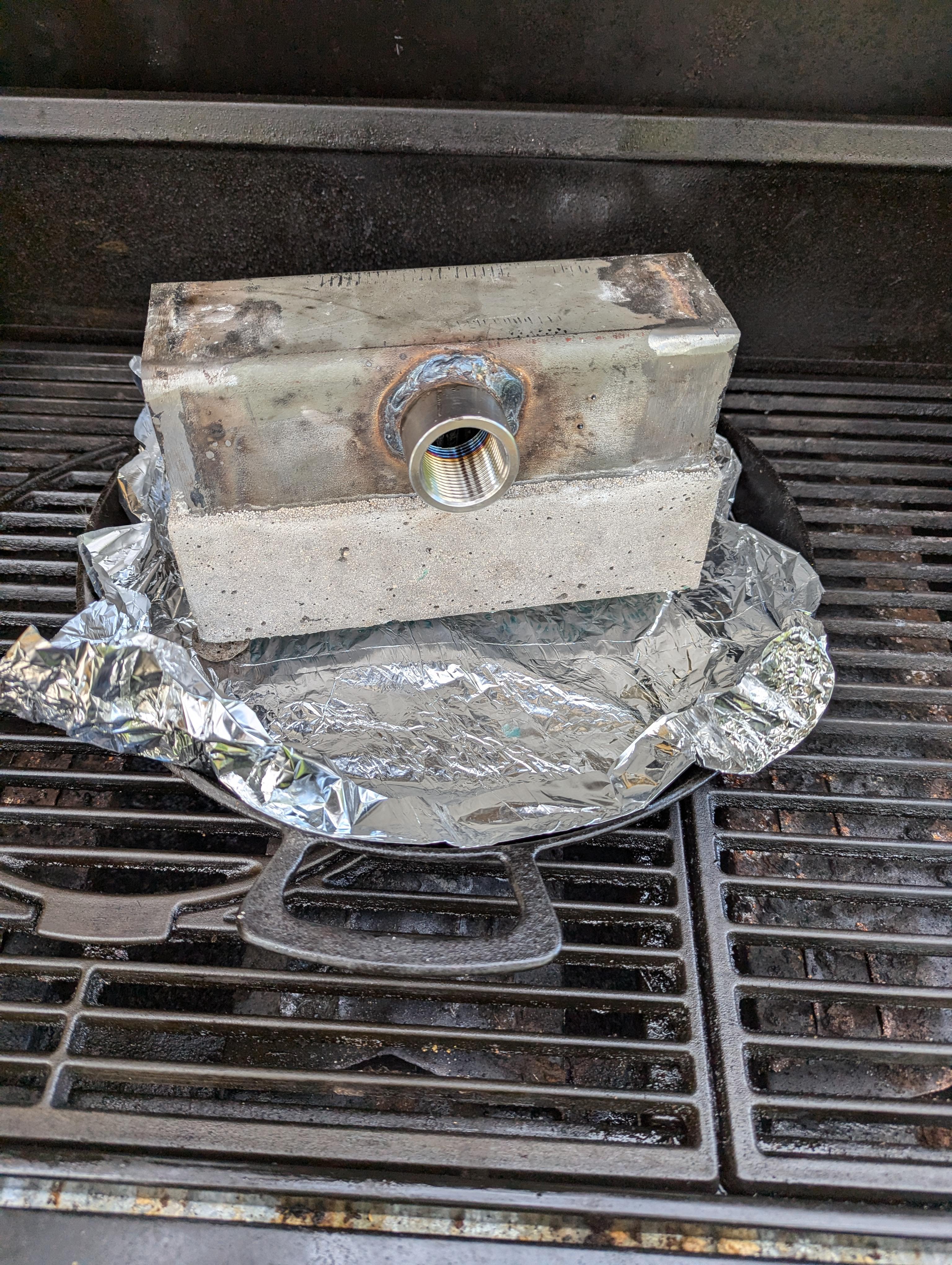

So I finally cast the burner. Our two week family holiday in Italy delayed the process.
I ended up doing 132 holes. Even though the sprue wax said 4.0 mm on the package, it was actually a lot closer to 4.5 mm.
Here's what it looked like with all the pins in place. The mold is 240 mm by 90 mm and 70 mm deep.
I've never really used Kast-o-lite 30 before and I had to go on YouTube to find some visual aid on what it should look like when mixed correctly. It really funny how it well it flows when vibrated. My power drill has a high pitched hammer function and this was the perfect tool for the job. I got the mold completely full.

PXL_20240722_142455303.thumb.jpg.79cea166e94d3ca600ebc5187b50cf01.jpgThis has to be the weirdest thing I've ever barbequed.
What do you think? Low and slow on indirect heat to cure the refractory and melt out the wax?
Looks like a good idea. Wouldn't recommend cooking anything else at the same time, unless it were in some kind of airtight wrapping; you don't know what kind of nastiness might be off-gassing from the burner.
Looks good for the initial melt of the wax. It will need a full burnout or residual wax will burn out when you use the burner and that's problematical on a couple levels.

Melting out the wax on the barbecue worked really well :D
