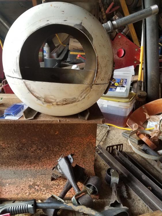

  8. Lol! My problem is I'm a terrible troubleshooter....great at fixing and making things though. I need thorough instructions or I overcomplicate things. Doesn't help that everyone has an opinion and Google throws at you. Thank God there's sites like this with people who know how and why things work to steer us along.
  9. Not a bad first try lol, thanks to everyone who's posted tutorials and offers advice!! I'm not happy with several things about this forge (the way i made it) but now I know what to do differently next time. Hopefully tomorrow I'll get a chance to mess with it a bit more.
  10. Well....slowly made progress, forgot to take pics along the way.... Here I am today..first firing...hows it look? Rebar was in there just for fun...turned red (inside the forge, took it out couldn't see it) in 3 min roughly, wadnt really keeping an eye on it. Don't seem to sputter....sounded like a weed burner. Still new to this do I'm not exactly sure what to look for in flame color....and should I fire a few small times to break it in? Burner angle is off abit still I just got my tap today. Thanks

  19. 1st forge 20lb?(12inx12 roughly) propane tank....lots of arguments for every angle of burner. 2 layers wool, kast-o-lite 3000, metrikote...should finish out at cutout holes. Is this angle good? It won't quite hit the ceiling but looks like it will roll along nicely. Thoughts please...thank you.

  22. Thanks, just added location to my profile. All the good shops are closed during weekends here. I'm going to see if our local fireplace guy can hook me up, maybe our plumber also. Really wanted to build it this weekend....oh well. Should have also stated I'm building a forge like Wayne Coes "build a gas forge". Wife's bringing me a new welder home cuz mine died when I was welding hinges on lol. Hopefully have it done by sat. (If everything arrives by then) is it a good idea to start a build thread to ask questions as needs and for people to give advice? Thanks again!
