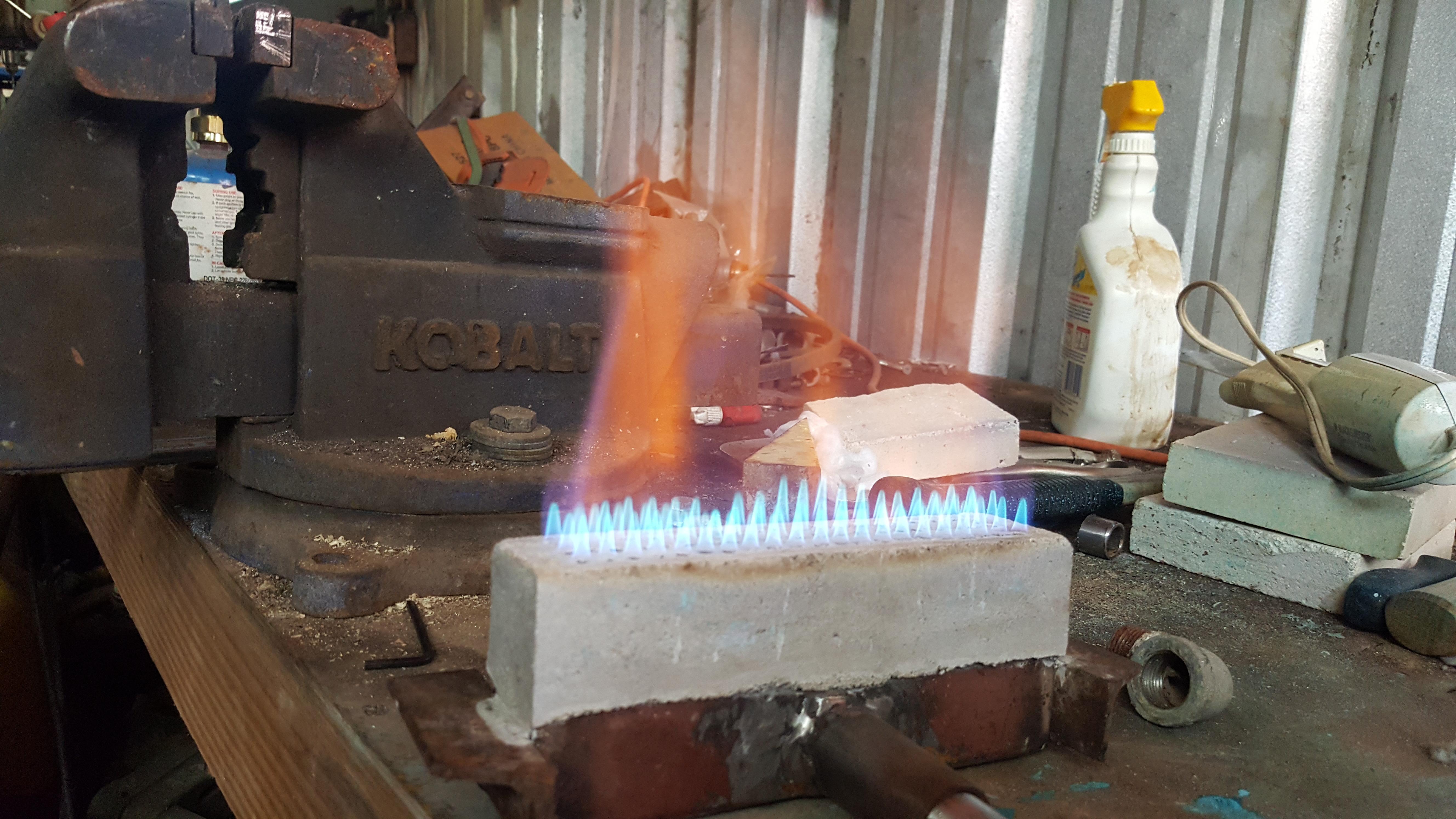

cleatusj Posted August 16, 2020 Share Posted August 16, 2020 Found this thread while waiting for materials to come in to build a 20 pound propane forge. I decided first to build in an old 2 gallon gas can and use a NARB. My NARB is 1 1/2 x 6 with 63 .143 size holes, these were cast with greased 12 penny nails. Tried firing with a 1/2 " frosty tee but the flames just lifted off. Then a new Frosty with a 1/2" cross, all 4 sides 1/2", this worked a charm, for keeping the flames on the Narb. When the forge finishes curing in a couple days, i'll test in the forge. Quote Link to comment Share on other sites More sharing options...
Another FrankenBurner Posted August 16, 2020 Share Posted August 16, 2020 Both of the burners are not Frosty Ts. Unless a burner is built to the specs in Frosty's instructions, it is not a Frosty design. You have two of your own design which are Frosty T inspired. Nothing wrong with that, we all learn from new designs. You just have more of your own figuring to do. That said, your first picture of the first burner (if the orifice is the same) is showing a more powerful inducer. Your flames are lifting because they are lean. Look at the deep blue color of the flames. You are inducing more air. Lean flames are thinner and don't hold as well. If it were mine, I'd enlarge the orifice on the first burner to see if it would prevent lifting without going to greenish flames. Unless you have a positionable orifice, then I would try sliding it in and out first because it's easier. Either way, they are looking good. Nice job. Quote Link to comment Share on other sites More sharing options...

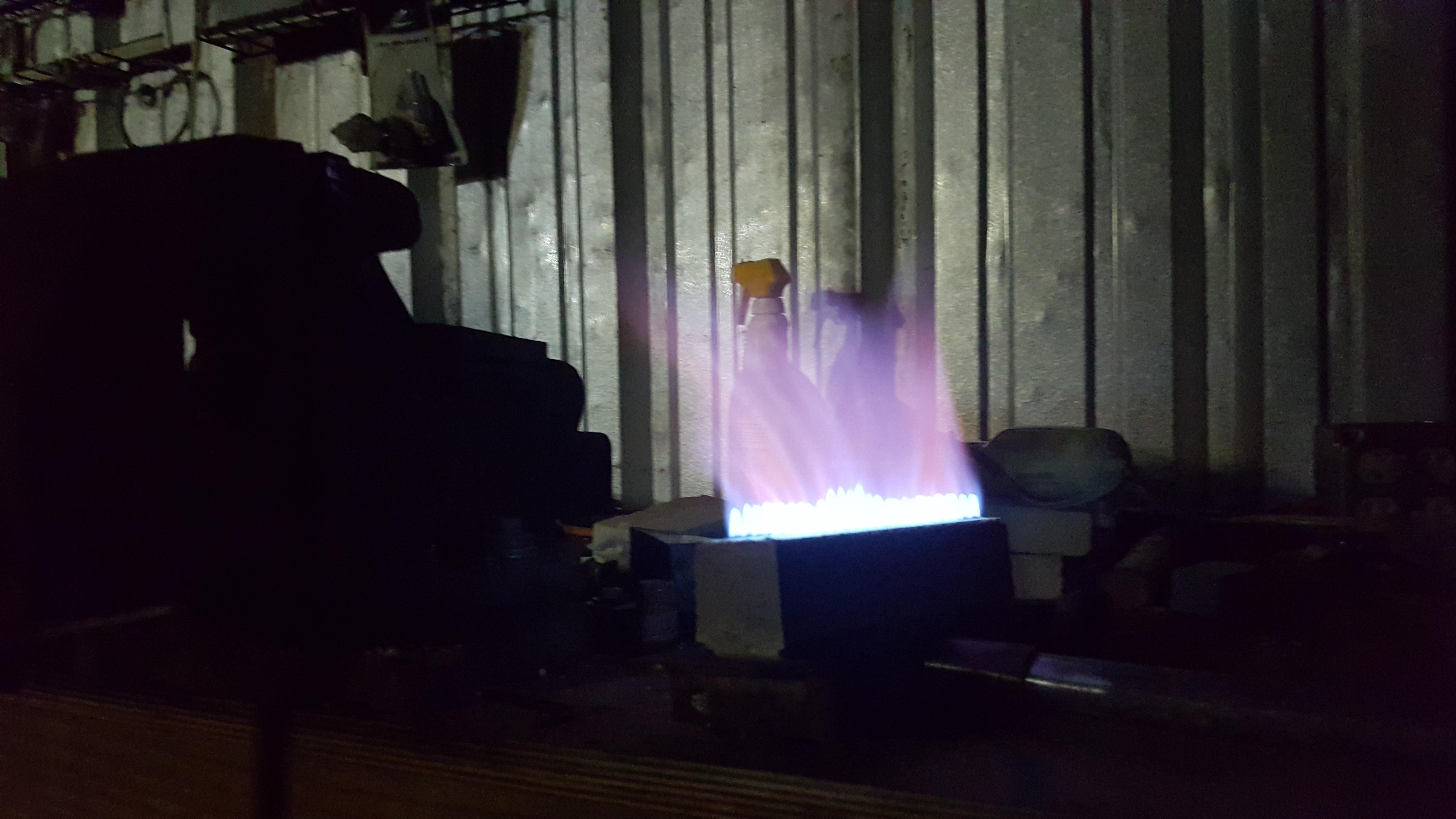

cleatusj Posted August 16, 2020 Share Posted August 16, 2020 Frosty T inspired would be the best description. Both have a positionable orifice and using .023 mig tips. Sliding the tip only seems to make a difference without the NARB. I will try another tip after dark tonight. Quote Link to comment Share on other sites More sharing options...

Another FrankenBurner Posted August 16, 2020 Share Posted August 16, 2020 I am inexperienced with the NARBs. I was speaking about what I saw in the flames and extrapolating. I probably should have refrained. Now that you mentioned it, I recall someone else on the forum saying the same thing about orifice position not changing much on their NARB as well. Where the first burner is running lean outside of the forge, I wonder if forge back pressure will reduce enough induction to run nicely. Quote Link to comment Share on other sites More sharing options...
cleatusj Posted August 16, 2020 Share Posted August 16, 2020 3 minutes ago, Another FrankenBurner said: I recall someone else on the forum saying the same thing about orifice position not changing much on their NARB as well. That was why I threw together the second burner, with the 1/2" pipe size inlets instead of the 3/4" openings, to slow the induction. With the adjustable depth tip, i release set screw and move to the other tee and tube. Quote Link to comment Share on other sites More sharing options...
Another FrankenBurner Posted August 16, 2020 Share Posted August 16, 2020 That works just fine. I am always after more potential output and what I said was based on that. By enlarging the orifice instead of throttling the air, you increase burner output. Both ways work and you don't need to chase more to get the job done. I tend to forget that. Quote Link to comment Share on other sites More sharing options...

cleatusj Posted August 17, 2020 Share Posted August 17, 2020 Here's a pic of the one with larger intake with the .035 tip. And the one with the smaller intakes. Quote Link to comment Share on other sites More sharing options...
cleatusj Posted August 17, 2020 Share Posted August 17, 2020 Went back and ran the burner with the 1/2" intakes with a .035 tip. First is at 1-2 psi and then at 5 psi. Quote Link to comment Share on other sites More sharing options...
