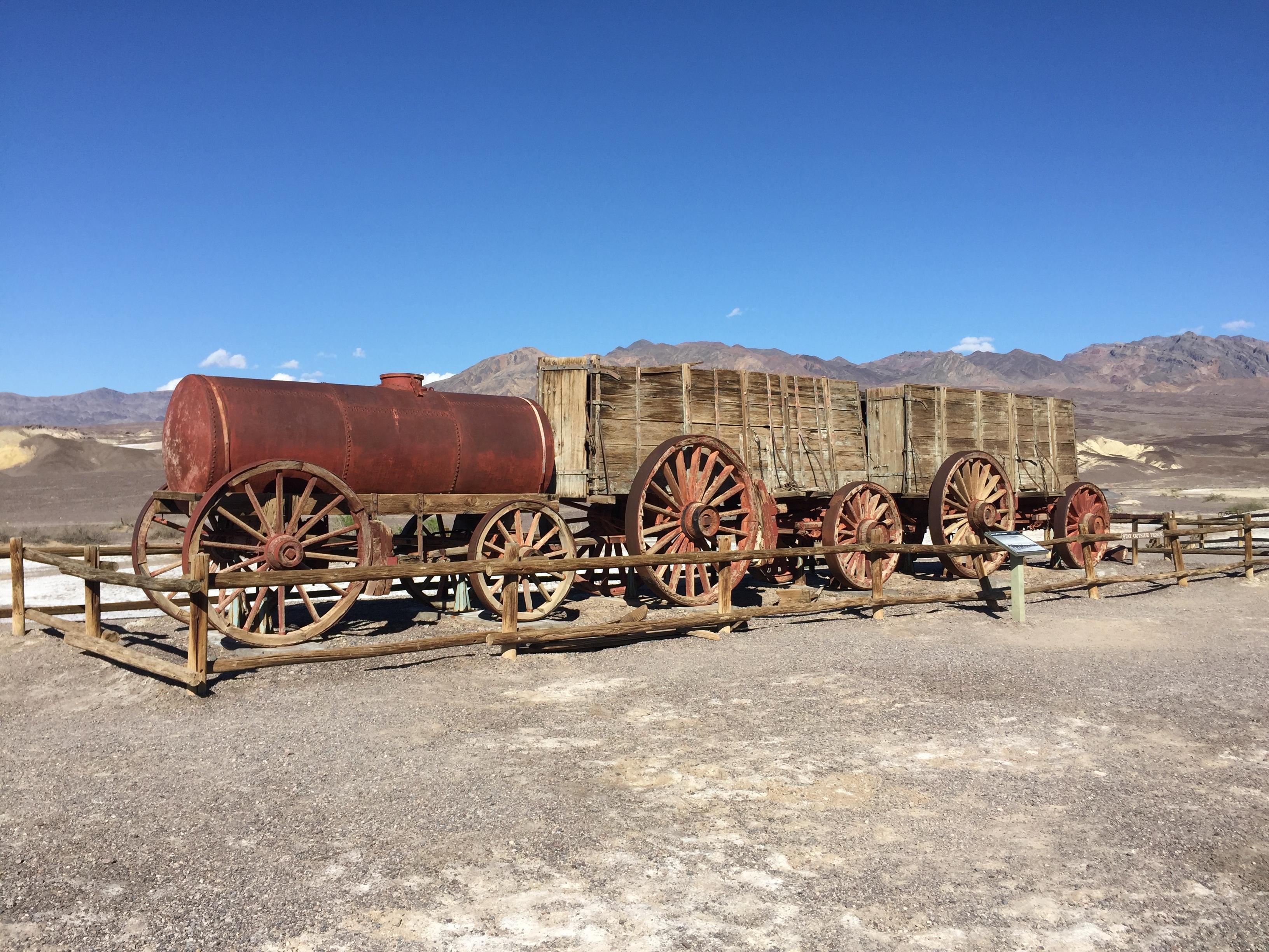

I’m in Death Valley. 80’s in the day, 60’s at night. They close the park in April due to heat.
Now, to make this appropriate for iForge: at the borax works from 1880’s, the wagon from the original 20 mile team company. The wheels are 7’ high, about 8” wide...If original I bet the tires are wrought iron. I could see the smiths hammer marks on the side of some. So we have both flux and blacksmithing.

The larger the diameter the easier. You don't need an inch more dia. to slip a tire on and the circumference of a 7' dia tire is better than 21'. How much temp increase do you need to get another 1.5" out of 21'?  Two flakes of straw spread around the tire and a cup of kerosene so it lit evenly should be plenty to bring it up a couple few hundred degrees.
