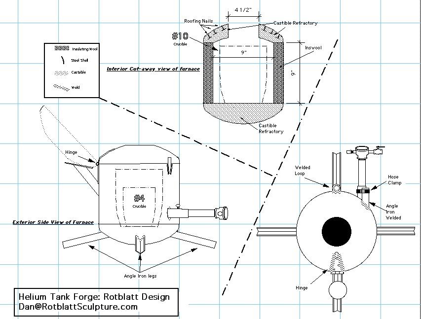

I was invited to teach a seminar on furnace building for a foundry class at El Camino College. I took pictures during the seminar and combined it with pics of my own furnace to create this article with the intent of using it at other seminars. Thus it is written as a "How To" article, meant to be combined with the seminar, which includes discussions on safety and proper use of the furnace.
The furnace we built is a small helium tank furnace, capable of melting 30 lbs of bronze in about 40 minutes. This is exactly the same furnace I use in my own studio.
The features of this furnace are:
  1. Melts 30 lbs of bronze in 30-40 minutes
  2. Uses a party helium tank (the same size as a 5 gal propane tank)
  3. Inexpensive to make: under $150
  4. Lightweight and portable
  5. An easy weekend build

This furnace is able to melt 25 lbs of bronze in about 30 minutes. It has a maximum capacity of 30 lb. of bronze or 10 lb. of aluminum (a #10 crucible just fits). The pictures here are from a class I did where we built 3 furnaces. Think of this as a recipe for building the furnace, there are many variations you may use depending on our skills, the tools in your shop and availability of materials. If you follow certain basic principles the furnace will work just fine.
Basic Principles for Building a Furnace
1) A furnace body is mainly an enclosure to hold the heat that the burner puts out. The steel shell does not hold in any heat, it is the refractory that holds in the heat (the lining inside the furnace shell). The body could be made of screen and it will work the same, it’s only purpose is to hold the refractory in place.
2) The burner should come in at an angle (see diagram #1) so the flame forms a vortex or whirlwind around the crucible. This distributes the heat evenly and does not overheat the side of the crucible.

3) The refractory you use must be able to take the heat within the furnace. Bronze is poured at around 2100 degrees F, but the furnace lining (especially where the flame is hitting it) gets much hotter. The lining on my furnace should take 2700 degrees. You cannot use plain concrete or substitutes, this can be dangerous. 2300°F ceramic blanket can be used, but expect a shorter life.
4) Every place there is a leak (i.e. flame shoots our from a hole or gap in the refractory) heat is lost. The less holes there are the better, but NOT from the point of view of melting the metal. The amount of heat lost from a small hole or two in the furnace is nothing compared to the amount of BTU's (heat energy) the burner puts out. The danger is that a flame shooting out the side will catch something on fire or worse, burn a hole in the propane line. Therefore, you should make the lining fit well - an easy thing to do, especially with ceramic fiber and castable refractory.
5) There must be a hole in the top of the furnace to prevent back-pressure from building up (especially important with a venturi burner). This hole also allows metal to be lowered into the furnace with a pair of tongs (not dropped!).
6) You must have a burner able to generate enough BTU’s (heat energy) to heat up the furnace to the temperature you want faster then the furnace looses heat to the outside. In an ideal world, a perfectly lined furnace (one that lets no heat out at all) could be heated to 2000 degrees F from a flame no bigger then a candle. In reality the flame must be a bit bigger to do this. The burner in this furnace puts out between 135-200,000 BTU’s.

Cutting the Shell
1. Using a cutting torch, cut a hole in the top of the helium tank about 4 1/2” in diameter (the exact size is not crucial).
2. Cut off the top of the tank just below the curve of the lid.

Thanks Mikey.  Actually I first made your burners as an upgrade for this forge.  I started casting to make pommels and guards for knives and swords, but later went into art casting.  The versatility it gives one is really amazing.
