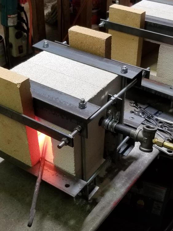

Justin Keller Posted August 13, 2022 Share Posted August 13, 2022 Hi all, I built two T burners and they seem to be working pretty well, but I'm not sure if my tuning is as good as it should be. Here's the album of my forge photos: https://photos.app.goo.gl/ZY9SWdsHJQPRrUpa8, I'd appreciate input. Thanks in advance, Justin Quote Link to comment Share on other sites More sharing options...
Frosty Posted August 13, 2022 Author Share Posted August 13, 2022 It looks pretty good to me Justin, maybe a LITTLE rich but pretty good. The orange flame is the calcite in the refractory curing. How hot does the forge get? Frosty The Lucky. Quote Link to comment Share on other sites More sharing options...
Mikey98118 Posted August 13, 2022 Share Posted August 13, 2022 the calcite burning off obscures the problematic exhaust in all but two photos; they both show a huge amount of blue exhaust flame, which is not good. Quote Link to comment Share on other sites More sharing options...
Frosty Posted August 13, 2022 Author Share Posted August 13, 2022 By problematic. . . too rich? If so, how too rich? Frosty The Lucky. Quote Link to comment Share on other sites More sharing options...
Justin Keller Posted August 13, 2022 Share Posted August 13, 2022 14 hours ago, Frosty said: It looks pretty good to me Justin, maybe a LITTLE rich but pretty good. The orange flame is the calcite in the refractory curing. How hot does the forge get? Frosty The Lucky. I haven't been able to get to forge welding temperatures with it yet, despite running two T burners. 2 hours ago, Mikey98118 said: the calcite burning off obscures the problematic exhaust in all but two photos; they both show a huge amount of blue exhaust flame, which is not good. So too rich? I should try trimming back the MIG tips to induce more air then? Quote Link to comment Share on other sites More sharing options...
