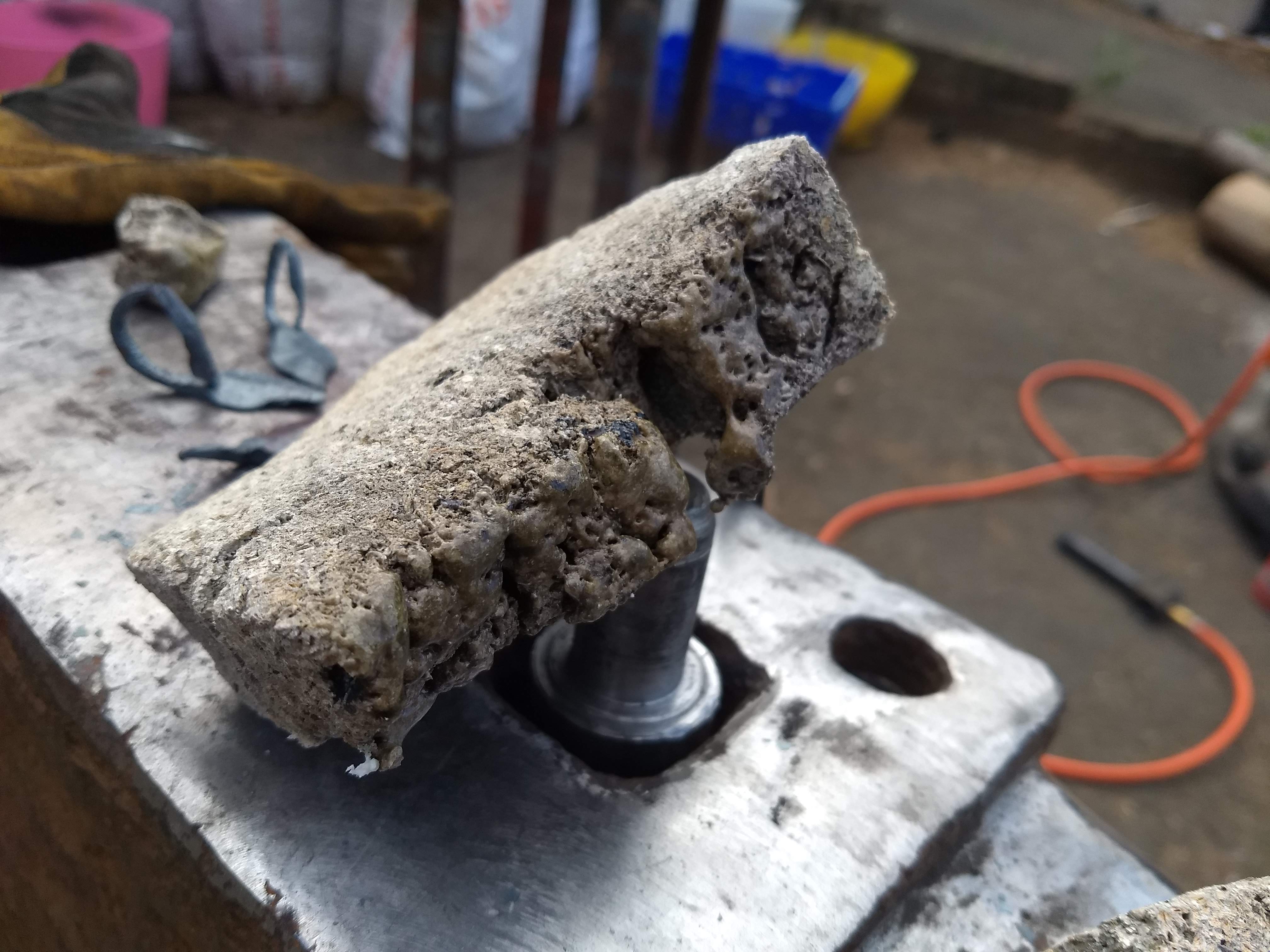

  11. I can't find anyone selling matrikote in Britain. At this point I think I'm going to have to mix my own kiln wash. I'll call the Morgan distributor and see if they have a list of smaller retailers when they're open again next week. It looks like I was wrong about what happened to the fire bricks. I thought they were cracking from getting hit with tongs but the burner is actually melting them. I guess if it can turn refractory bricks to liquid it's burning hot enough.
  12. There is a Morgan distributor in Merseyside but they don't take small orders and as far as I can find they're the only UK distributor for Morgan. I can easily get Vitcas bricks though and they should perform pretty much the same. Martikote isn't giving me any hits either. I did find another kiln manufacturer and ceramic supplies distributor to ask while I was looking though. There's something called Batt wash that's high alumina but it doesn't look like it fires hard. Apart from that it looks like people in this country mostly mix their own kiln washes.
