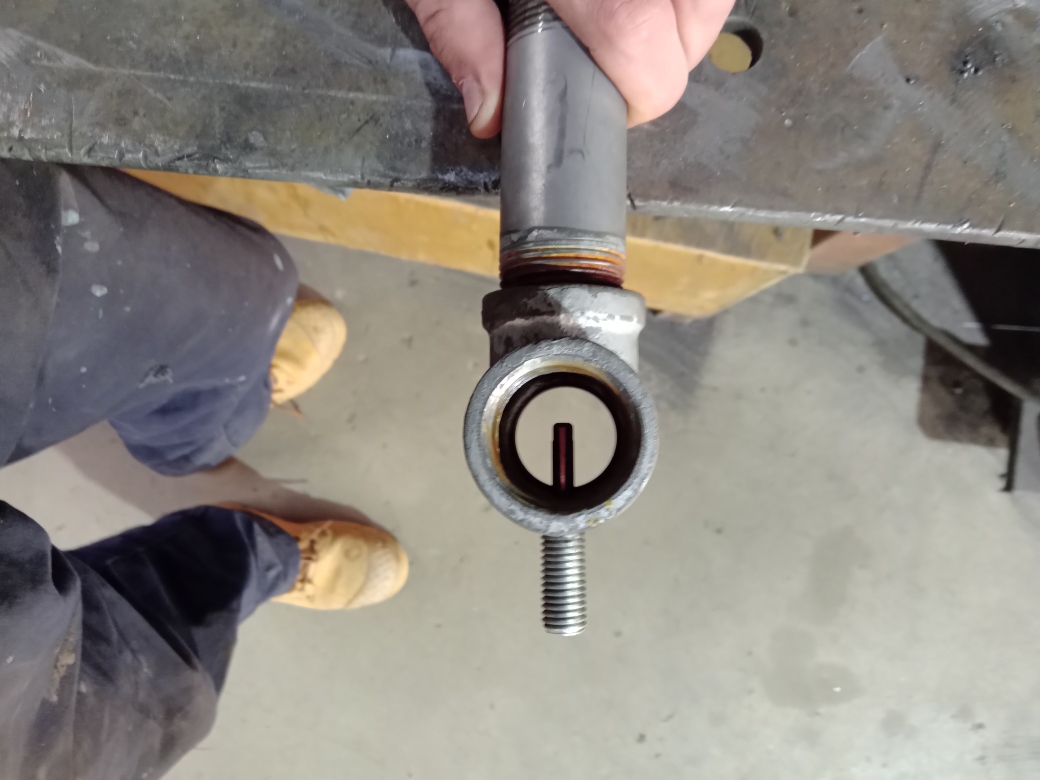

BayardStrachan Posted September 2, 2022 Share Posted September 2, 2022 Got off my rear end and made a burner finally. I couldn't get the materials listed in the plans as all the gas fittings are different in NZ so I had to improvise a bit. Basically, it is a m12 bolt with a hole drilled perfectly through the center, an the mig tip threade into the hole. The T gets an m12 tapped hole that the bolt screws into, and the gas fitting goes over top of the bolt on the opposite end to the mig tip. I can't see any reason why this won't work, but if anyone else can spot an issue, please tell me, I don't want to create a bomb!! Quote Link to comment Share on other sites More sharing options...

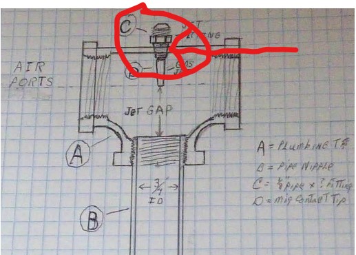

ymber Posted September 2, 2022 Share Posted September 2, 2022 I didn't get a chance to fire up the forge last night but I did get a better photo of the jet gap. Next time I've got it running I'll try and get a better forge photo. It should be easy now that it's getting dark in the evenings again, I've just got a list of stuff that needs welding first. The jet gap looks like it's about 1/2D like the document says. It did seem to be burning pretty well. 2 hours ago, Frosty said: I've also been having trouble finding flare to MPT fittings with an ID small enough to tap for a mig tip. I had that problem working with BSP parts. I ended up using a cone seat union. They're mostly for pneumatics and fuel lines I think but they're widely available and the walls are thick enough that you've got plenty of material to drill and tap. Quote Link to comment Share on other sites More sharing options...
BayardStrachan Posted September 2, 2022 Share Posted September 2, 2022 6 hours ago, Frosty said: Let us know how it works please. Frosty The Lucky. Will do, it is actually well aligned, which surprised me a bit, considering i didn't even use a lathe, only a drill press. Quote Link to comment Share on other sites More sharing options...
Mikey98118 Posted September 2, 2022 Share Posted September 2, 2022 The photo shows your MIG tip to be slightly out of axial alignment with the mixing tube; it is also not centered with the mixing tube. Furthermore, the mixing tube is the same size as the two air openings; this means that the swirl that begins as those two air paths converge, are not supplemented with the funnel shape, which a smaller center opening causes to be present in the right pipe fixture. Quote Link to comment Share on other sites More sharing options...
Frosty Posted September 2, 2022 Author Share Posted September 2, 2022 5 hours ago, ymber said: The jet gap looks like it's about 1/2D like the document says. That's the departure point, it gets the burner close enough to fine tune. It's burning pretty well but it looks like it's a little rich though it's hard to tell from pictures on the internet. Frosty The Lucky. Quote Link to comment Share on other sites More sharing options...
BayardStrachan Posted September 3, 2022 Share Posted September 3, 2022 1 hour ago, Mikey98118 said: The photo shows your MIG tip to be slightly out of axial alignment with the mixing tube; it is also not centered with the mixing tube. Furthermore, the mixing tube is the same size as the two air openings; this means that the swirl that begins as those two air paths converge, are not supplemented with the funnel shape, which a smaller center opening causes to be present in the right pipe fixture. I think the photo makes it look like th mig tip is a little bit skewed, because I checked and double checked all that. As for the mixing pipe being the wrong size, I had to use a 1in T and a short 1in threaded pipe, with a 3/4in pipe pressed into the inside. Again, I don't see any reason this won't work, but I am not an expert Quote Link to comment Share on other sites More sharing options...
Mikey98118 Posted September 5, 2022 Share Posted September 5, 2022 Did you put an internal bevel at the end of the pipes to create a small funnel area? Quote Link to comment Share on other sites More sharing options...
BayardStrachan Posted September 5, 2022 Share Posted September 5, 2022 No, I didn't actually bevel the edges. What you said earlier actually made me realize that I may have done it a bit wrong. The 3/4 inch pide only goes about halfway up the 1 inch pipe, which puts it about 70mm below the bottom of the T. If that makes sense, would this mess up the whole venturi effect? Do you think I should redo it? Quote Link to comment Share on other sites More sharing options...
