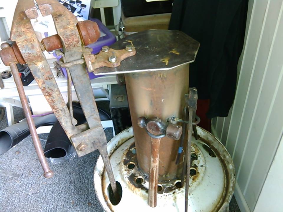

i finished this up today  need to  runnint thru the car wash  then  hit it with some rustolem with out being bolted down it dont move  i left the tool rings lower so i can use the top for setting  work on when i need to reposition  or to set hammer on while  clamping it down  after buying a cord end for the  welder i scored for free  and running to the  scrap yard i got right at 100 bucks invested with the vice

Here's my take on a post vise stand.
School bus brake drum with a 1" thick pipe blank bolted on top. I-beam from a mobile home trailer frame and a 3/4" thick plate on top. The leg is mounted on a 3/8" plate that has a flange that was formed and welded to match the drum diameter. The plate is through bolted to the drum with three 1/2" bolts and there are two mounting holes for anchoring to the floor. There are two more plates through bolted on the back of the drum for anchoring to the floor similar to the one on the leg - but they weren't installed in this picture - so I could move the vise around in the driveway without digging a trench - lol. It's very heavy. On another side note- you can see my new gas forge stand in the background that I'm very happy with - Harbor freight very cheap - Just added the casters for moving.
