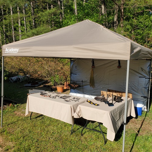

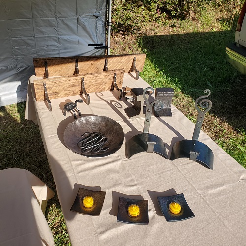

I have committed to my first vendor event at the end of this month and I'd like some input on my booth. I did a test setup today, pictures below. I'd appreciate feedback and suggestions. This will likely be a small event so I'm trying to manage my expectations, but I also want to look relatively professional.
I have more of most of the items pictured, I'll replenish as (if?) things sell. I plan to have a couple items for display only, not for sale, mostly to show off a couple of the things I am proud of making but loathe to part with. I know I need some price labels and a sign for payment methods, social media presence, etc. I'm thinking of making some vertical displays as well. I have a shop sign, but it is only half-finished in the picture below. I still need to make the name portion that will hang under my symbol. Again, trying to manage my expectations and prioritize my tasks.
I plan to offer a free bottled nonalcoholic beverage with the purchase of every bottle opener for testing purchases; I'll also have water for sale with the blessing of the event organizer.
Any advice or input from y'all will be much appreciated, thank you.

The one suggestion I have is to add levels so there's a variation of height and not just flat. This can be as simple as shoe boxes or stacks of books under the table cloth.
I like the tan table covering. Really let's the metal pop.
Also, I'd recommend props for as many pieces as possible so there's no wondering what something is - and also to draw attention.
Like have a penannular brooch actually pinned into a scarf or something. An open (empty but weighted) bag of coffee for the coffee scoops.
A couple thngs:
First, I agree with Shaina about multiple levels and having displays that suggest use.
Second, always try to pick a site where your displays will be in the shade.  If it is in the direct sun the ironwork will get hot and folk seldom buy things that they cannot pick up and examine. Facing North is always best.
Third, I like to have prices tags on the table to avoid the constant "How much is this?"  Something that just says "Ladles $20" will do.  I don't like doing this on bits of paper, unless pinned to the table cover to keep them from blowing away.  I have cut square cross section pieces of wood about 6" long on the diagonal and put the lettering on the slanted side.
Fourth, have a chair or 2 to sit in.
Fifth, I like to have a small table in the back for my use.  I usually keep my money box there.
Sixth, sign up for Squarespace of something similar so that you can accept plastic for payments, cash and checks are so 20th century.  Frankly, you will lose a LOT of sales if you don't accept plastic.
Seventh, have some little trinkets to sell or give to kids.  A good one is flattened double headed nails which are miniature swords.  You can drill a small hole in the top so that thy can be hung as a pendant on a cord.
Eighth, have a patter worked up to call folk in to your booth.  Something like, "We have bright shiney things and sharp pokey things!"  And have explanations for your objects and quck demonstrations of how things work.  Explain that a penannular brooch is called that because it is "almost a circle" and how it works.  Also, show the purchaser how it works and then make them do it themselves on a piece of fabric.  It is really simple but not intuitively obvious.  My wife was almost late for our wedding because she and the Matron of Honor could not figure out how to work the penannular that I had made for her to wear on her clan tartan sash.
And be ready to interact with customers, saying hello and talking about your work.  If you are an introvert this may be difficult but it gets easier with time.
Telling folk that this was only a simple piece of steel before you put your hand and mind to it and that there is a little bit of your soul in everything you make usually makes them think.
Ninth, have a sign with your or your forge's name.  I like having the sign mounted high up so that folk don'l crack their heads on it and sticking out into the flow of traffic at 90 degrees to the front of the booth.  This way folk can see it as they are approaching.  Make sure it is lettered on both sides.
Tenth, have business cards to hand out.  Maybe only one it 100 will result in something for the future but they are cheap and you never know.
Eleventh, make sure folk know that you will take commissions.  Say something like, "If there is something you want but don't see it here, I can make it for you."
Twelfth, DO NOT haggle.  I tell folk that I price my things by how much time I put into something and if I accept a lower price  I am admitting that my time, of which I only have a finite amount of on this earth, is worth less.  That said, feel free to give someone a deal if you want to, e.g. 2 $25 items for $45.
Thirteenth, ALWAYS have more stock than you think you will sell.  I can't tell you how many sales I have lost because I ran out of X.
Fourteenth,  it's probably not as big an issue this time of year but having some tarps and a way to attach them to the booth as shade or rain curtains is a good thing.  Also, if you may get wind or thunder storms having stakes and rope to secure your booth to the ground are good.  Remember, your stock WILL rust if it gets wet.  Also, not all booth foofs are water proof this can be a nasty surprise.
Have fun and treat it as a social experience.  The money is just an added bonus.  Having folk compliment your work is always an ego boost.  And being able to answer "yes" to the question "Did you make all of this" is always satisfying.
Fifteensth, have a cooler with drinks and food for you.  Often the food and drink condessions at events are mobbed and if you are alone you don't want to have to shut down and pack up so that you can go get a hot dog and coke.
Sixteenth, your hose hangers are something that are not easily identified.  So, a label or a short piece of hose will tell folk what they are for.

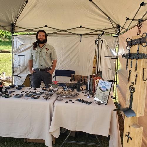

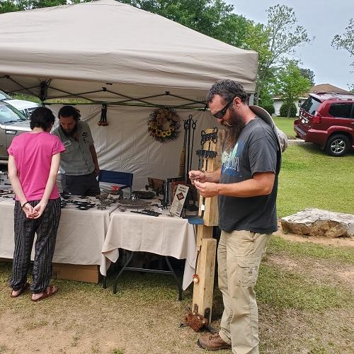

My first vendor event under my belt, it was a good experience. Like I mentioned above, it was a very small event with only a $10 entry fee. There were about 15 or 20 vendors, but the foot traffic was pretty minimal; maybe 100 - 150 people. I made six sales of 11 total items, for an even $200 total.
I gave out stickers to kids, and a bunch of people took business cards. I had a few people ask about custom orders, and I expect to hear back soon. I got lots of "oohs" and "ahhs" and compliments over my stuff, which was nice to hear. I don't think people see forged goods in my area very much.
The event organizer told me I definitely need to get into some of the bigger events in my area; we were unfortunately competing with some pretty popular farmer's markets and craft fairs yesterday.
Ultimately it was a great experience, it lit a fire under me to get all the stuff I need to do this more often.
Thank you to all who shared tips and advice.

I highly recommend you keep a pad or two of graph paper in your booth so folks can sketch what they want. You almost never meet anybody who can actually describe what they see in their head let alone something that might fit an installation. Seriously, if you draw a square with a horizontal line above it to represent the mantel piece almost anyone can sketch what they want for andirons, screen grate, candle sticks, etc. and get the proportions close enough they can call in measurements.
I like your Mothman sign but something in my old soul calls out for a 1950s B movie Mothman monster image.
Looks great Mothman. Real potential for the shows with more foot traffic and buyers.
I've done shows where it barely paid gas money so that isn't bad.  You bill build and grow with each show and you have a good start. If the price is right dont be afraid to do any show. You will learn the good from the bad. More info and thought need to go into ones that cost more.
Setup looks inviting. Keep working on inventory and display and you should do great.
