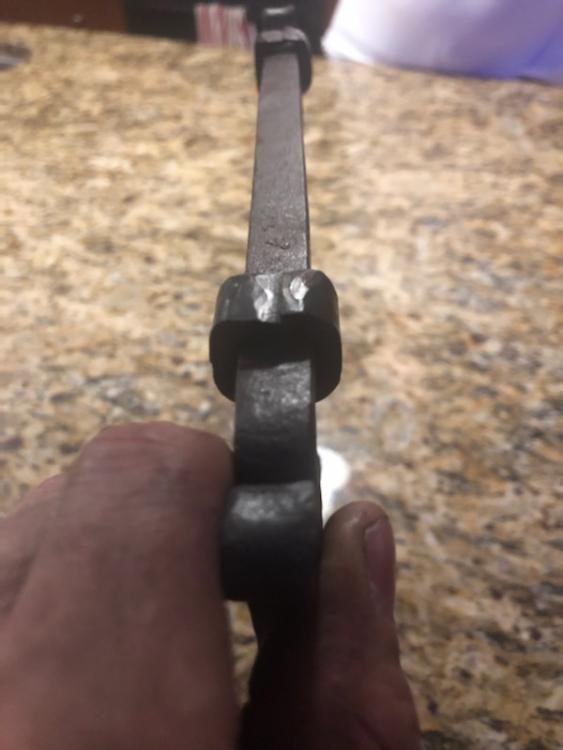

Frazer Posted September 11, 2020 Share Posted September 11, 2020 Might as well add mine here since it seems to apply. Here is my first go at a trivet. It turned out a little wonky, but it was a fun little project. Very different from other things I've done thus far. It's made from 1/4" x 1/2" bar stock. Looking back I definitely I did things out of order. I ended up fighting with the forge welds for the diamond more than I expected and the twists in the center turned out very uneven. Next time I would make those 4 pieces first and forge weld them together last. The way I did it resulted in a very unwieldy object at times. Collars turned out okay. They were much harder to do on this guy than the practice ones I did on some scrap pieces. They are tight, but there is an air gap on the side where the bevels meet... Well where they are supposed to meet anyway. They also cover my tack welds up nicely On the bright side it turned out pretty close to my initial sketch. Quote Link to comment Share on other sites More sharing options...
Tubbe Posted September 11, 2020 Author Share Posted September 11, 2020 That is not bad at all! I like it! /Torbjörn Quote Link to comment Share on other sites More sharing options...
anvil Posted September 11, 2020 Share Posted September 11, 2020 nice! For a first attempt,,, plumb awesome! Quote Link to comment Share on other sites More sharing options...
ThomasPowers Posted September 11, 2020 Share Posted September 11, 2020 It would make a nice door grill! Quote Link to comment Share on other sites More sharing options...
Frazer Posted September 11, 2020 Share Posted September 11, 2020 Thank you, I'm going to make a hook of some sort for it. I figure It will look nice on the wall in the kitchen. It may need little silicone feet for under the collars before it get used though. Putting a cast iron pan with some sizzling good stuff on it as it stands may make it a little too hot for the table. Not sure yet. Quote Link to comment Share on other sites More sharing options...
Irondragon Forge ClayWorks Posted September 12, 2020 Share Posted September 12, 2020 I would put feet under the corners to raise it up some, that way the heat from the pan won't damage the table through radiant heat. Or just put a pad under it. Quote Link to comment Share on other sites More sharing options...
Frazer Posted September 12, 2020 Share Posted September 12, 2020 That is probably a good idea as well. It does sit rather low profile. About 1 inch away from the table surface, minus however much I filed away to make it lay flat. Quote Link to comment Share on other sites More sharing options...
