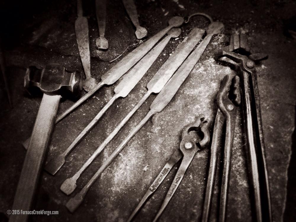

  14. I've been using these basic dies, the Fuller, Butcher and a Sizing die for tenons, etc. I use the Fuller dies most often to set shoulders for strap hinges, meat forks, bottle openers, etc. At this link you can see some shots of how I used the Butcher die and then after drawing the neck down, the Sizing die is used with light hammer blows to clean up the area where the shaft meets the ball end. http://www.iforgeiron.com/topic/41006-how-do-you-forge-a-ball-end-hook/?do=findComment&comment=418889 The handles are for cooking trivets. The bottle openers are from 1/4" x 1" and get fullered down before opening the ring on the horn.

  20. John, just saw your post. Sounds good about the nut. What about a square chunk of steel with a hole drilled in it to match the end of the rod and then forge weld that?
  21. While I'm sitting along I-83, 12 miles north of the Baltimore beltway with a disabled truck (I drive tractor trailer parttime) figured I'd go on iForge. Alan, I necked the rod down to about 3/8" and then did the facets. I used a smithin magician with butcher dies first and then flat dies to clean up neck. Then took it down the rest of the way. Do you have any photos of the V tools you described? I can't picture them.
  22. Here is a first attempt with 5/8" sq stock but I decided to make a faceted ball rather than round. I'm guessing the material was drawn down to almost 5/16" round. I tried to emulate the end of a water pump handle in miniature by transitioning from square to round. An original would be more rectangular and then transition to round. It is a little rough and the next time I need to flatten the original 4 sides a bit more to remove the puckering from hammering the facets. Also have to define the facets some more. Some of the photos aren't that great but you get the idea.
