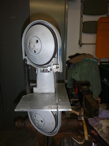

  3. I used a porta-band saw for a long time to cut metal. I added an aluminum table to my portable band saw and a foot switch. Clamped it in the post vise for a stand.

  16. I had a Chop Saw but never used it between the noise, dust and sparks. Would take it outside. The band saw is great for me I can cut metal when the kids are in bed sleeping. Don't have to worry about setting the garage on fire. The band saw does take a little more practice and tuning to get good results. You have to adjust it when going from tubing to solid stock. I pick mine up for $100.00 used and abused.
