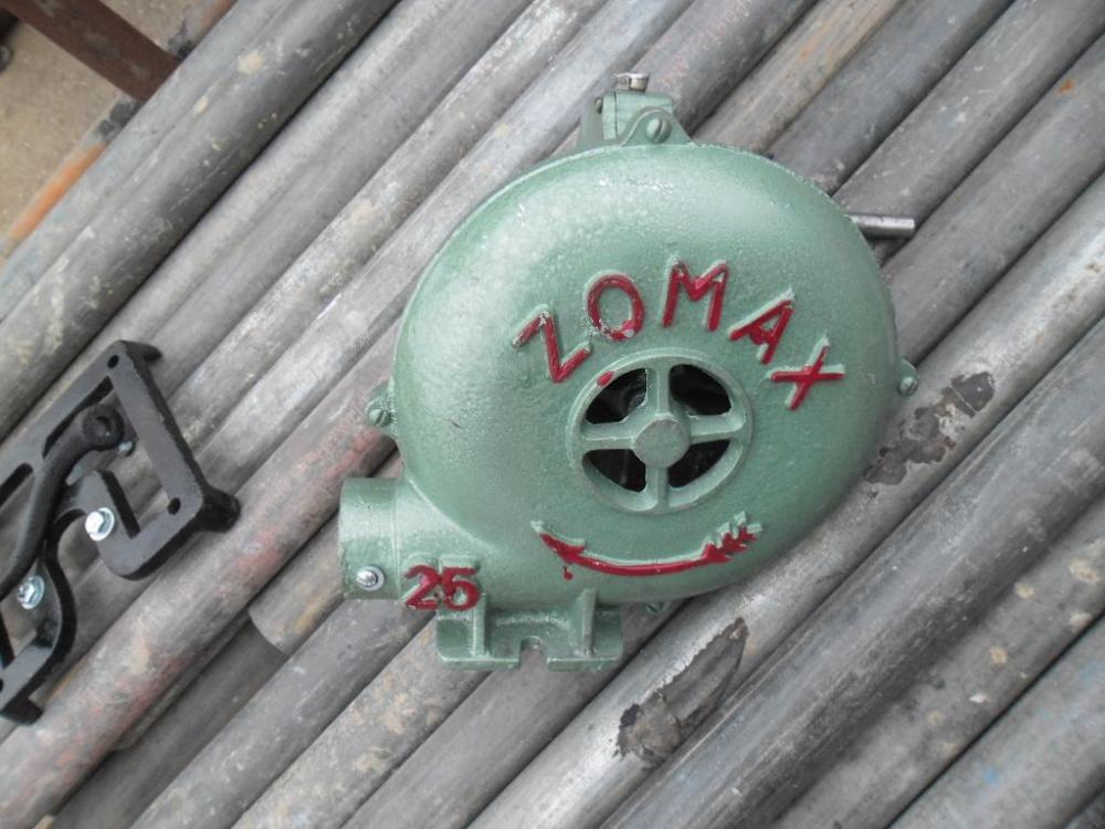

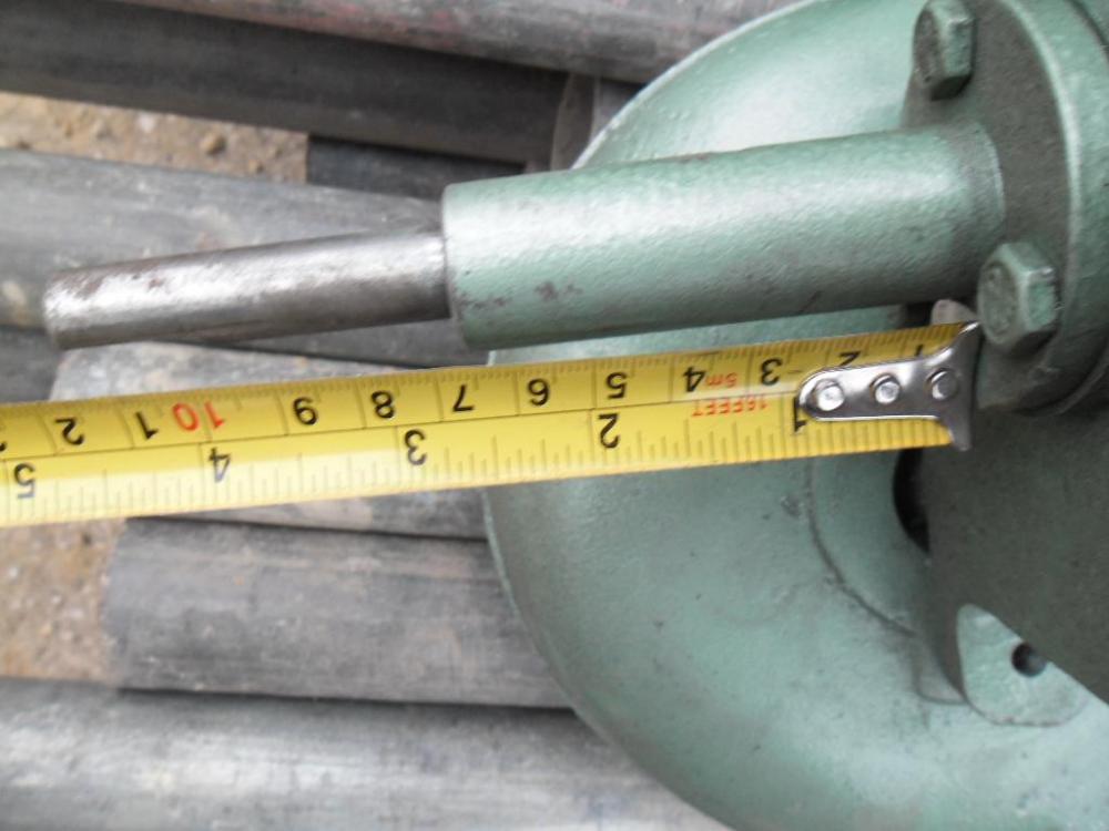

  24. here is my Zomax, as you can see it has a long support for the handle shaft and the other parts are the same as well. model 25, the same as the whitlox one and IIRC it was about $100 from whitlox in the US when I looked
