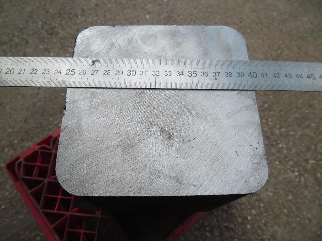

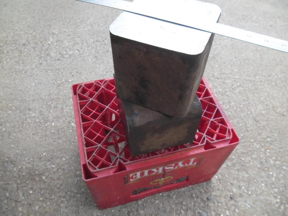

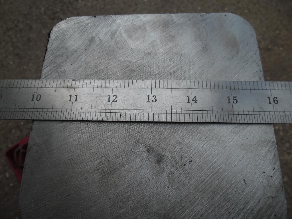

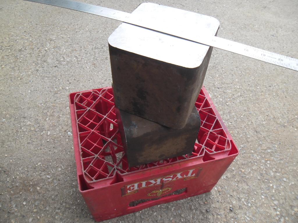

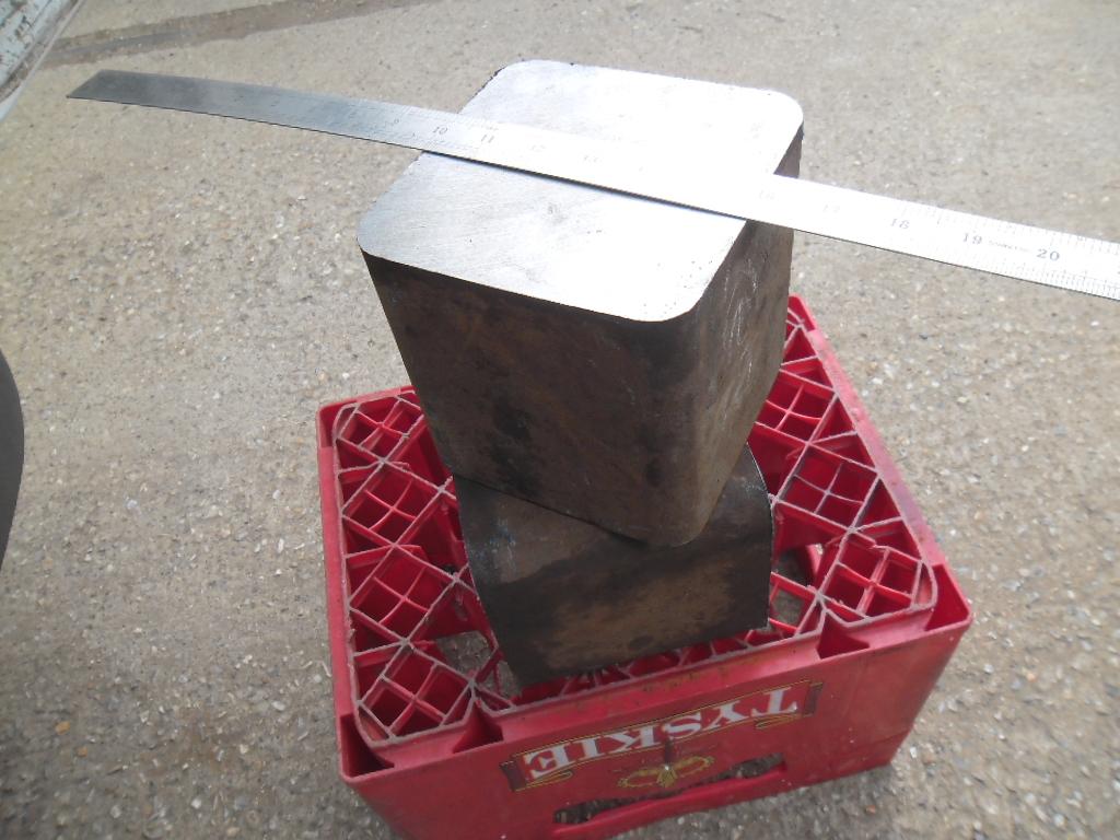

  22. got a bit of 4140 and had it cut into cubes of about 15cm, that is just under 6", they weigh 36.2kg each, thats about 80 pounds. I am going to have to rehome some of these
