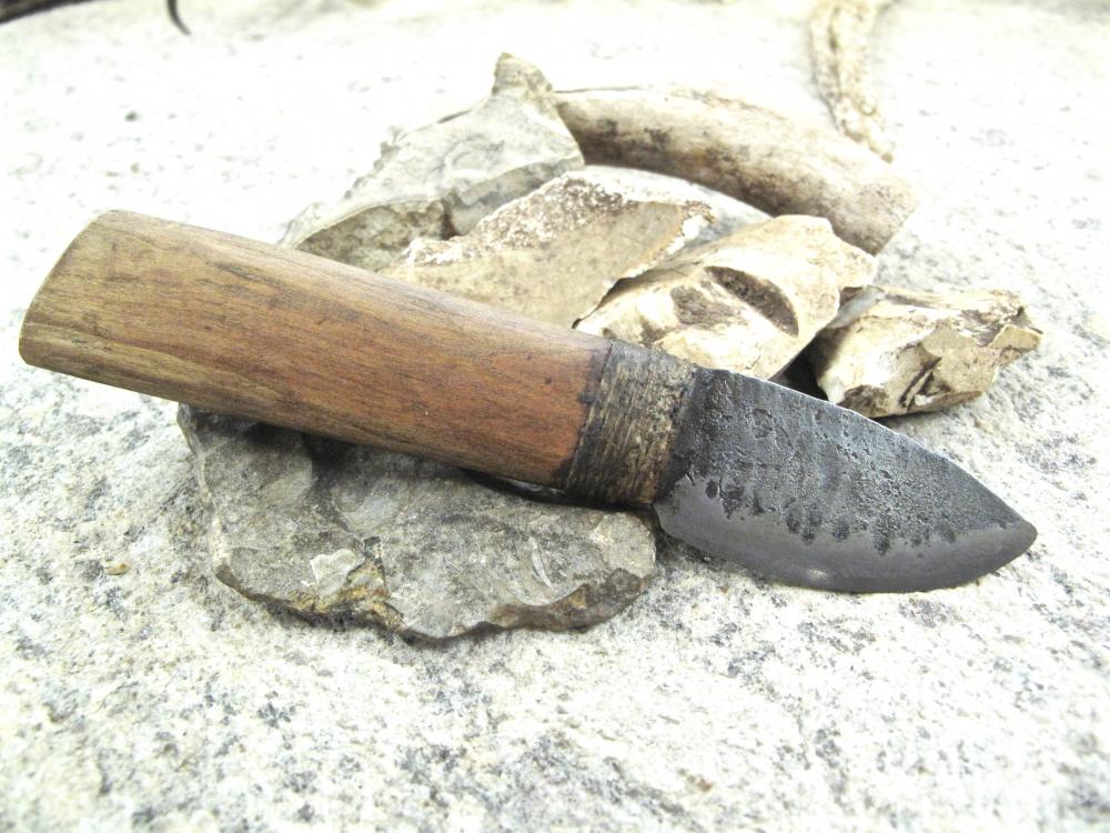

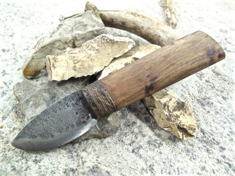

I've had this on the "to do" list for ages and finally got around to putting rubber to the road.
The blade is 1080 from Admiral Steel, water quenched and tempered to a nice bronze (twice).  The handle is a section of a limb off my plum tree that a freak ice storm brought down.

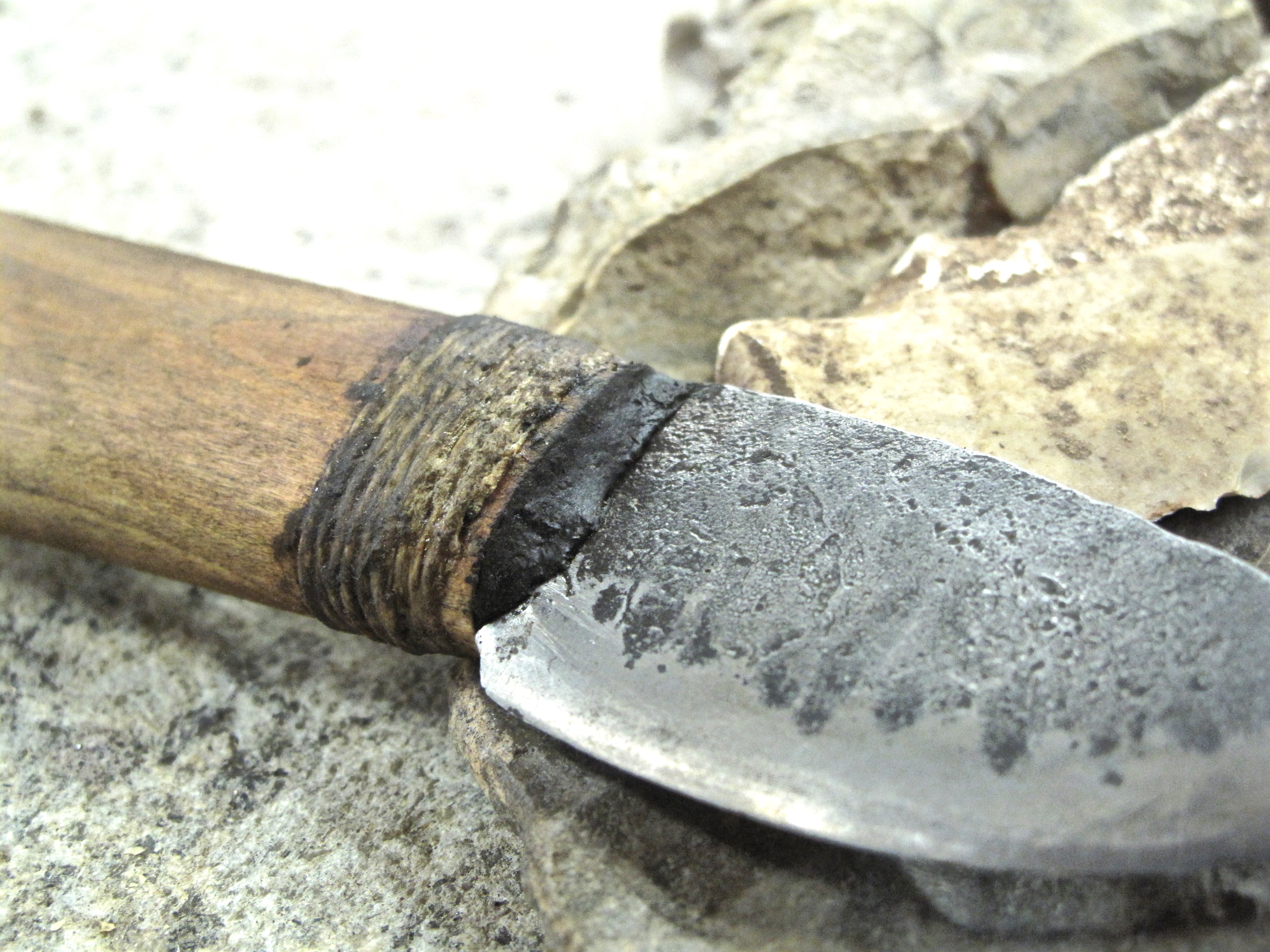

I used hemp thread for the wrap instead of sinew, and coated it with hide glue to help weatherproof it a bit.  The wrap is recessed into the wood so I don't have to worry about it going anywhere.
For the blade, I was trying to go for something that resembled knapped stone or a leaf.  I was hoping for the former, but would have been satisfied with the latter.  I didn't quite get what I was going for, but I'll not kick her out of bed for eating crackers!
The pitch glue is just to cover the end of the handle.  I used Gorilla Glue to secure the blade in place, no pin, and will be curious to see how it stands the test of time.
All and all, I think Otzi would like her.  She's very comfortable in the hand, not too big or too small, and seems to be holding a decent edge.  Now I need to work on a sheath!

The hardest part about making this knife was keeping the primitive look .  I see a lot of "primitive" blades that just look like they were made by intoxicated chimpanzees, and too much sanding and polishing on the handle would have clashed mightily with the rough steel.  You can still feel some of the gouges left by the flint scraper that helped shape the handle, but they are very fine and don't stand out to the eye.
I half expect the wood to check a little bit because it still had some moisture in it.  Part of me wants a check or crack to help bring out the primitive feel a little more.  I can always wrap the break with some rawhide to make it look like a field-expedient repair!
As for the sheath... well, it just happens to be the right month to pull Poplar bark, so I might go that route.  I've got a slew of home-made rawhide (calf and deer), so I could go with some of that over a leather core.  Absolutely at a loss for the design of the sheath, so I'll most likely wait a while.
Gorilla glue might be fine as long as your fit is pretty good... it becomes a weak foam in larger gaps and fails easily IME.  If you hot set your tangs, you won't need any glue.  Make your fit such that the tang will not fully seat cold.  Then heat the tang and seat it as it melts its way in!  The resins in the wood will be your glue and the compression of the fibers in the tang socket will make it stronger than the rest of the wood!  Practice with some scrap to get the tang hot enough to melt in with little or no charring... charring will ruin the glue effect and weaken the socket.  Tangs should have a slight taper for this type of fitting. Leave the tang surfaces rough for a better connection.  I usually step drill the tang socket to get my rough fit.  Softer woods will compress quite a bit but very hard woods only slightly.  Therefore the prefitting of the socket needs to be closer to a cold fit with the harder woods.
