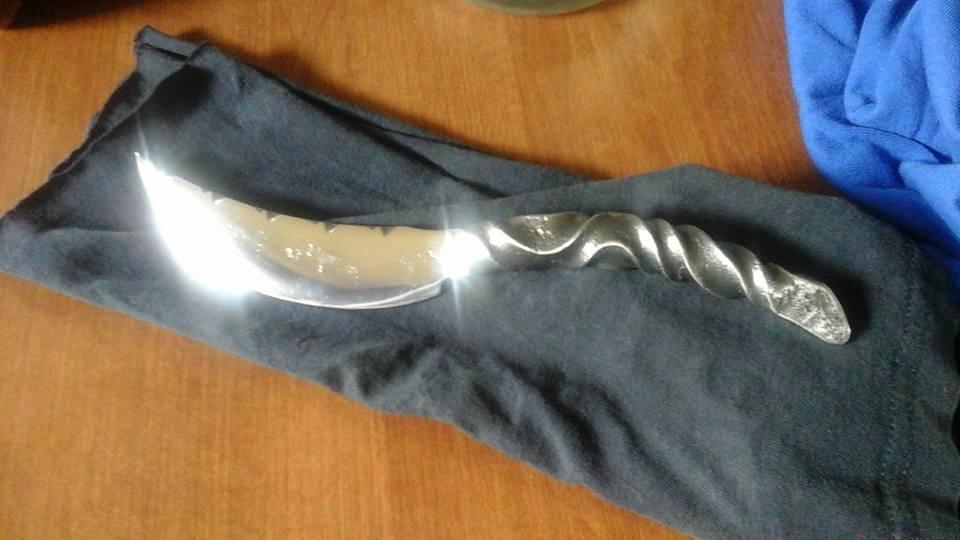

  7. i like finding projects that require tools i do not have yet, that way i get 2-3 goods projects out of 1 idea
  8. i have a pretty good supply of the H13 pins as well...thinknig of trading some out so others can play with em

  10. i get that impression from his posts
  11. i got the same impression when i read the specs on 5115, the pins i have are seriously hard on the outside anyway? was surprised to see that the specs had it at such a low carbon the other pins out of the same mold are all H13 not sure what is with 5115 pins, but free is free so...
  12. thanks for the advice Charles, got some forgin' to do
  13. probably no good for blades then i imagine
