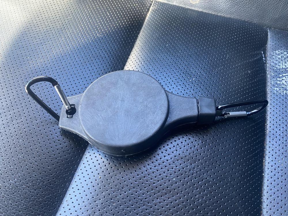

Another raiding expedition into the dumpster behind the college theater yielded a light duty tool balancer that extends about 30”.
I think I’ll mount it to the outside of my portable power tool storage cabinet, to keep the angle grinder wrench handy.
Tool . . . Balancer?
Dang, now I can't think of what we called them, something like recoil lanyard, call or come back?

Actually, looking into it a bit more, I find that I’ve inadvertently been guilty of a bit of terminological inexactitude. According to a commercial website that I will not link to here:
”Tool balancers and tool retractors are both specialized pieces of equipment designed to maximize workspace efficiency. Tool balancers utilize load capacity as well as spring tension along a cable to suspend tools in predetermined locations.
“Conversely, tool retractors draw back tools to a predetermined position once they're done being used, often away from the workspace. The instrument is usually connected to a cable that's wound in on a spring-loaded coil for maximum retraction power.”
So, tool retractor. I lounge about corrected.
And now I know what a "tool balancer" is, I can think of a number of things one would be handy for.
