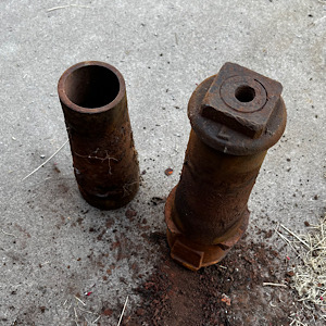

Donal Harris Posted August 27, 2022 Share Posted August 27, 2022 Forgot about the shirts. Roller bearing? Is that what these are? The inner piece is cast. Not sure about the outer. Few sparks, but those that appear do burst like carbon is present. Assuming I can get the nut off and separate the inner from the outer, could it serve as a cone mandrel? Quote Link to comment Share on other sites More sharing options...
George N. M. Posted August 27, 2022 Share Posted August 27, 2022 Anything round can be a mandrel. IMO a collection of different diameter round objects usually takes up less room and is more useful than a big floor mounted cone mandrel. "By hammer an hand all arts do stand." Quote Link to comment Share on other sites More sharing options...
ThomasPowers Posted August 27, 2022 Share Posted August 27, 2022 Cast Iron, a roller bearing with only 1 roller? I'd just call it a bearing. Quote Link to comment Share on other sites More sharing options...
JHCC Posted August 27, 2022 Share Posted August 27, 2022 Without knowing its purpose, I’d call it a roller. Quote Link to comment Share on other sites More sharing options...
Donal Harris Posted August 27, 2022 Share Posted August 27, 2022 If I ever get down to Duncan, Oklahoma to buy more scrap axles from the guy there who restores old wagons, I will ask him what the proper terms are. He should know. Cool guy. One of these days I would like to get down there and watch him repair a wheel. Quote Link to comment Share on other sites More sharing options...
Frosty Posted August 27, 2022 Share Posted August 27, 2022 I believe "old" wooden wagon wheel hubs were banded wood that was a LITTLE larger than the iron/ steel spindle and required lots of grease / lard. Later versions have steel bearing bands (box bands) and modern wagon wheels are sometimes all steel, have wheel bearings and grease caps. I believe though don't have any cites, this is just my thoughts and memories from reading and an old .edu TV program called "The Wheelwright." The "box bands" were to keep the hubs from wearing through on the spindle flange or spindle washer, which kept the hub in place on the spindle. In movies and TV shows run away wagons crashed dramatically when a wheel came off. That's actually pretty accurate, a Conestoga wagon is NOT a high speed vehicle turn those wheels much faster than a casual walking pace and the washer is likely to cut into the hub and once the wheel starts to wobble it's over with. I speculate that wagon wheels that didn't have box band must've been on spindles with large flanges and used large washers, maybe almost as large as the hub itself or hubs would've worn out really quickly. I suppose a wooden spindle flange and washer would work though not how well. If you get down and visit the wagon wheel restorer PLEASE take pictures and notes! I'll save it this time, I promise. Frosty The Lucky. Quote Link to comment Share on other sites More sharing options...

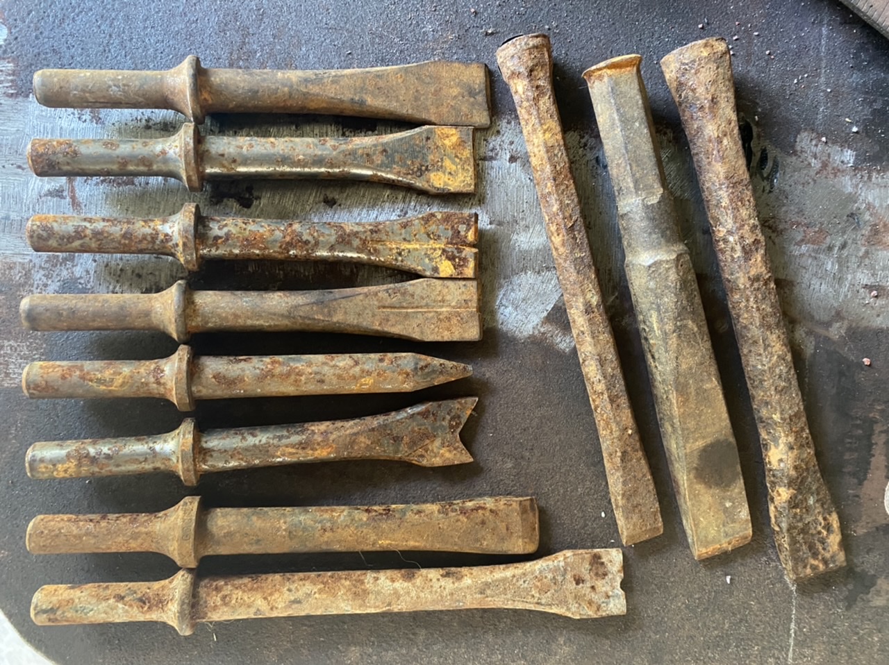

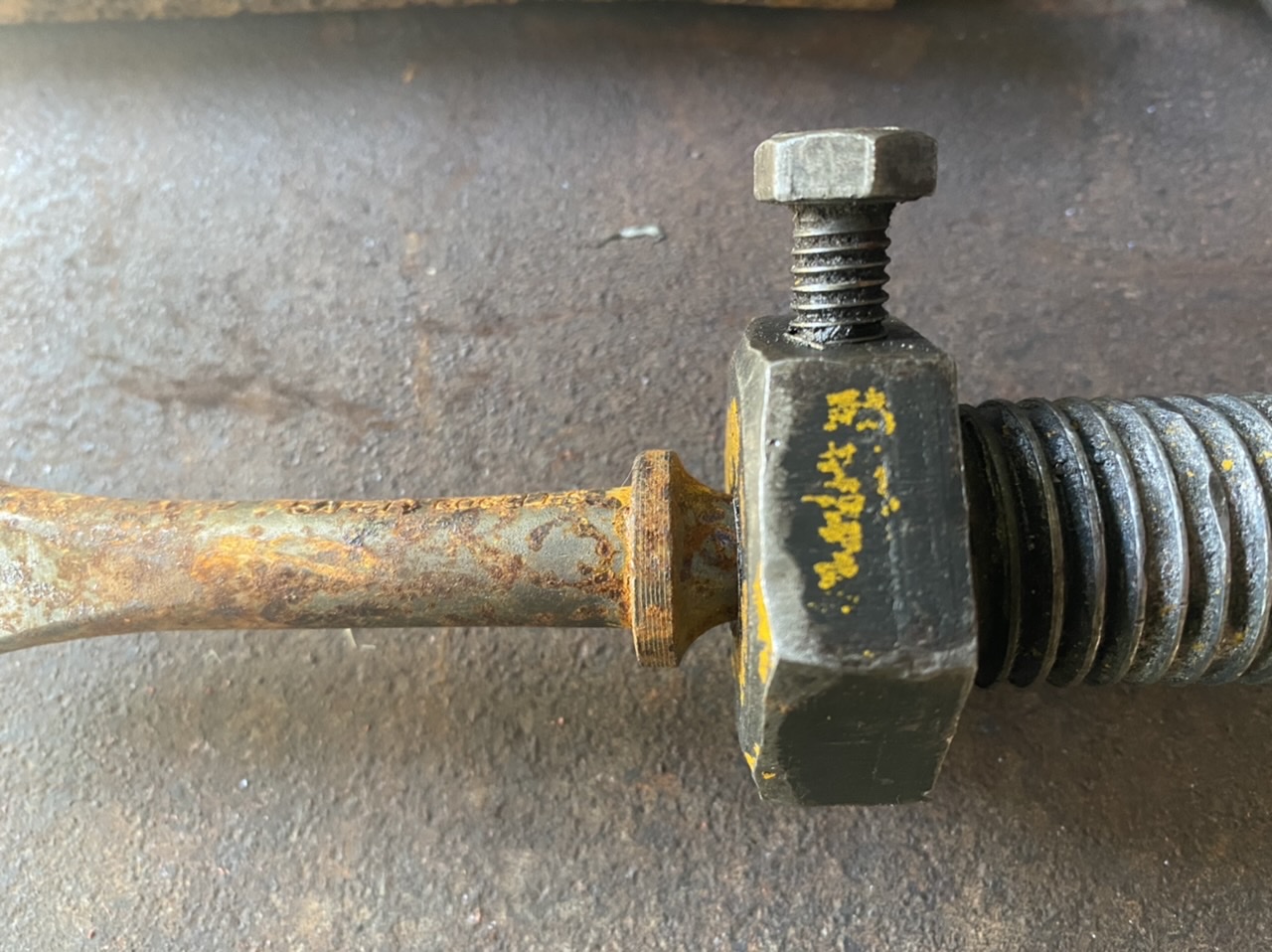

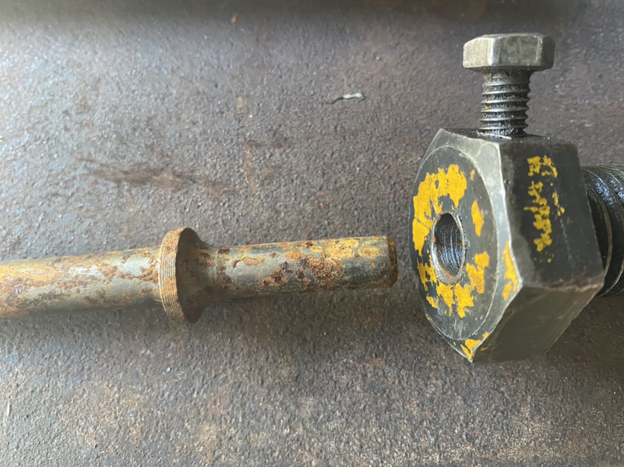

JHCC Posted August 27, 2022 Share Posted August 27, 2022 I picked up a big handful of chisels and air hammer tools for a few bucks at a yard sale, and I’ll be grinding and/or reforging the latter into fly press tooling. Their shanks fit nicely into my existing tool holder, except for the fillets on the undersides of the collars. I’m thinking that grinding the collars down to remove those fillets and create a square-shouldered bearing surface is probably the best course of action, but I’m open to suggestions. Quote Link to comment Share on other sites More sharing options...
TWISTEDWILLOW Posted August 27, 2022 Share Posted August 27, 2022 I’d just grind one flat side for the set screw to lock into, Quote Link to comment Share on other sites More sharing options...
JHCC Posted August 27, 2022 Share Posted August 27, 2022 I’m not worried about the tool twisting in the holder. I am concerned about the tool jamming itself in the hole, since there’s nothing preventing it from being driven upwards into the tool holder. Quote Link to comment Share on other sites More sharing options...
ThomasPowers Posted August 27, 2022 Share Posted August 27, 2022 John, Monkey tool and forge the fillet flat? Wagon wheel bearings: the 1897 and 1905 Sears Roebuck catalogs call them Skeins. Quote Link to comment Share on other sites More sharing options...
Alan Evans Posted August 28, 2022 Share Posted August 28, 2022 13 hours ago, JHCC said: I’m not worried about the tool twisting in the holder. I am concerned about the tool jamming itself in the hole, since there’s nothing preventing it from being driven upwards into the tool holder. I would say the radius and taper of the fillet is too obtuse to jam like a morse taper, if it did stick just a tap would free it. It would certainly save a lot of grinding if the fillets are identical so you could just heat up a tool holder and drive one punch in to make a perfect fit socket. The punch flange would be a lot stronger if unground. But even simpler and better (as in KISS) maybe you could just make a tool holder which matches the air hammer chuck system and drive the punches on their hardened ends. If they don't mushroom and jam in the chuck under air hammer use, they shouldn't mushroom and jam under fly press use. Alan p.s. As an aside on the power of grubscrews....the punch tools I use in my double acting hydraulic press are held in the chuck by a couple of Ø5/16" grubscrews. The 30 tonne down pressure is taken on the shoulder I have machined into the punch, but the 15 tonne extraction pressure is taken solely by the two grubscrews...which have stalled the press on occasion. I grind tapering flats on the punch for the grub screws to locate which do two things...they act as a dovetail which increases the grip as the punch is pulled out of the chuck by the extraction friction/punch/stripper plate....and secondly any levee thrown up on the sides of the spigot by the grub screw are below the surface of the chuck cylinder and do not foul. Quote Link to comment Share on other sites More sharing options...
