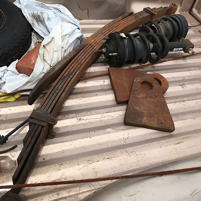

What is the bottom leaf spring called?
I plan to cut a hammer drift out of it. Other than that, who l knows. Maybe one of those large cleaver things they use to split hogs in half. The coil springs, once safely removed, punches, chisels, a drifts.
This thick plates with holes in them, who knows. Likely just leave them in a pile for my kids to dispose of some day.
I think it's called "Looks like too much work for a hot day".  I'm making a hammer drift from a pick end I hot cut off. Funny think I've been running into old pick's at the scrap yard lately and need to figure out some stuff to make from them. (The old mining pick is up on the shop wall, the others on the possibles pile.)
