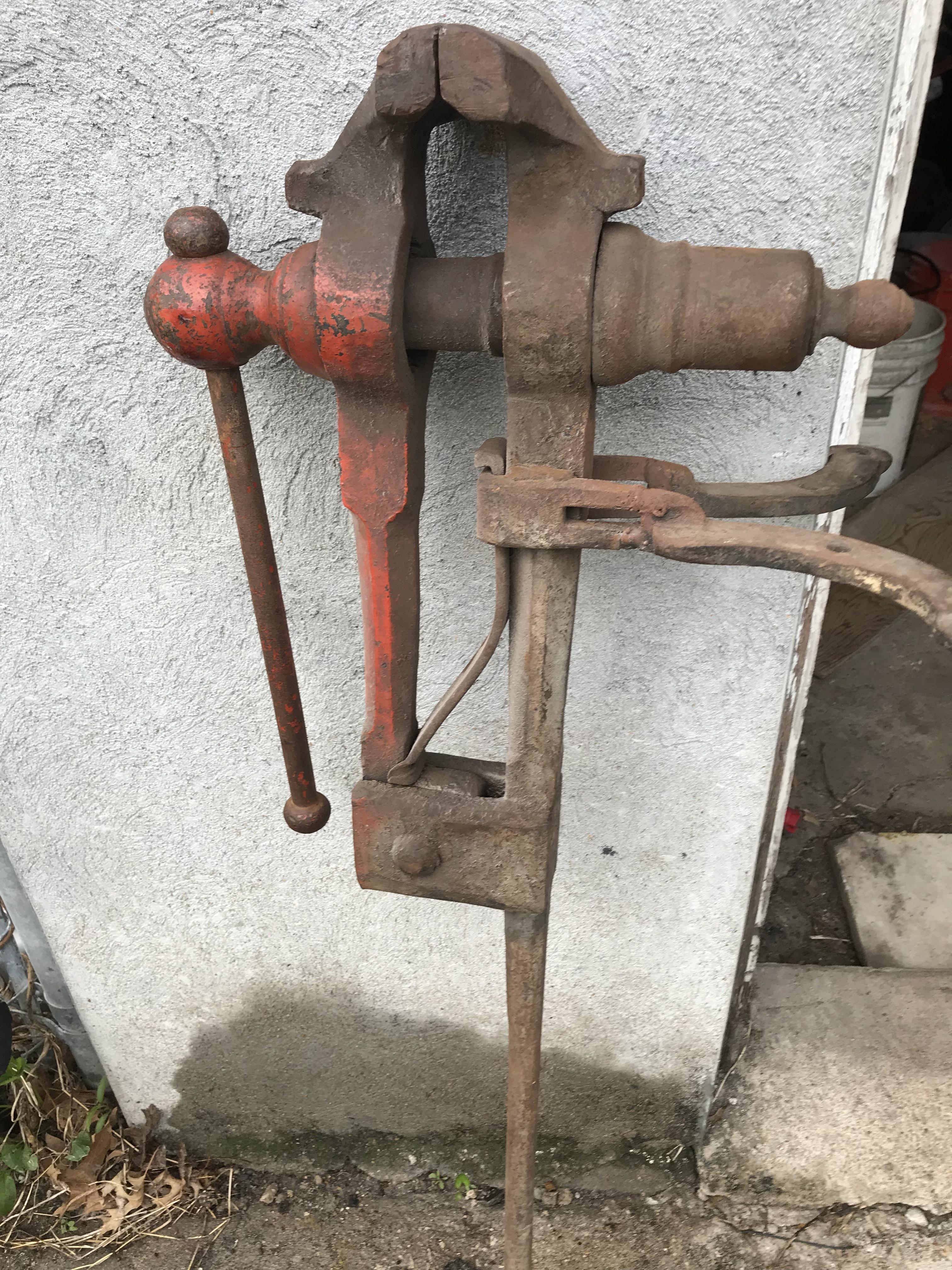

Stopped by a garage sale yesterday and picked this up.  Looked at the screw box and screw, paid the lady the asking price of $25 US and got gone before anyone changed their mind.  The threads have very little wear.  4" jaws. Lucky day as leg vises in this area start at $100 and go up.
Beautiful. I suspect you are in love.
I would be breathing deeply and sweating profusely.
SWEET score! Lucky dog you.

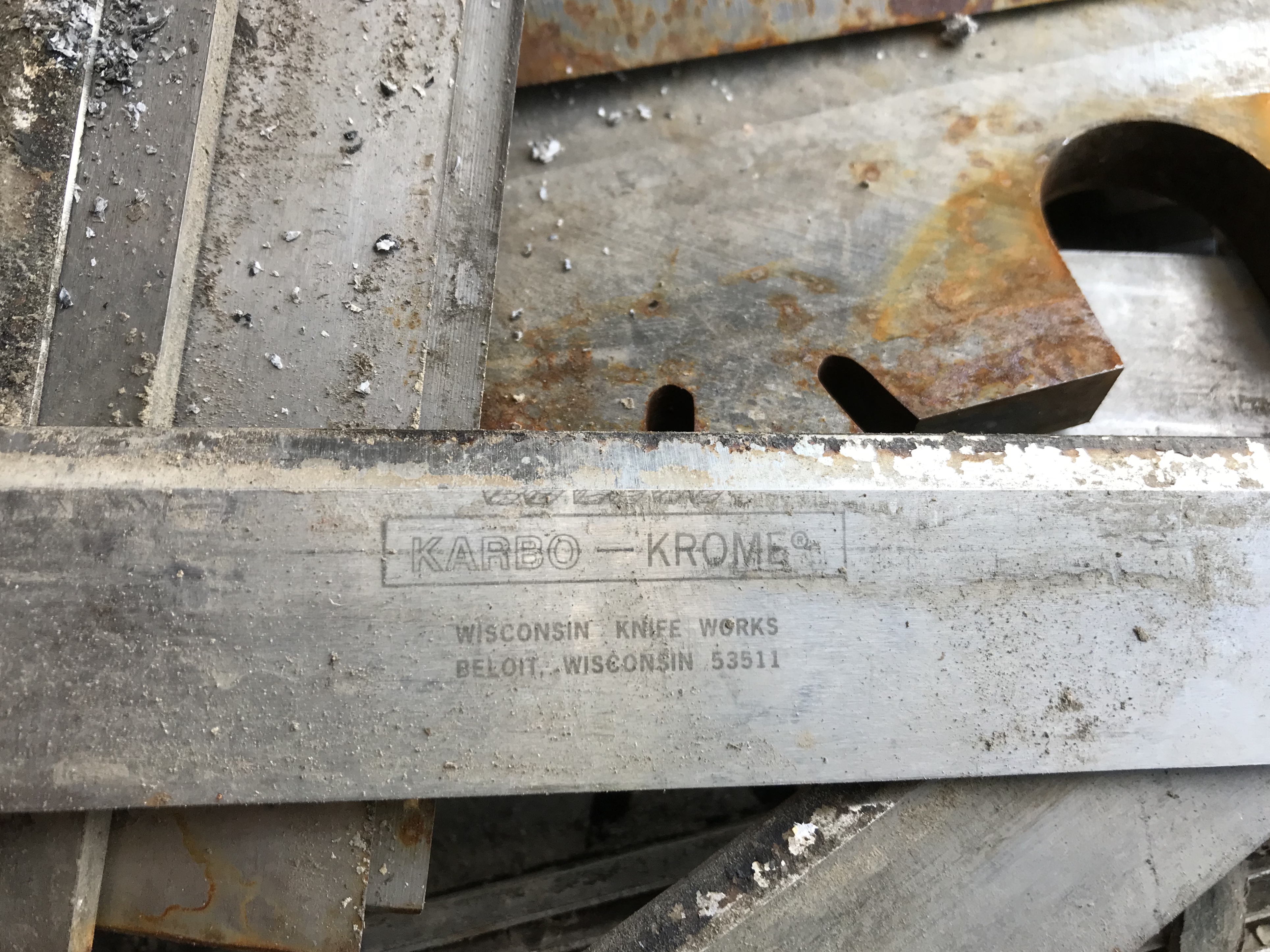

Came home with a bunch of plainer blades today. Free
The small ones are d2. Still researching the large ones
Thanks guys. Ya it was love at first site.  Frosty you have no idea how not true that is.  Been looking for a couple of years.  Even a blind dog will find a bone from time to time.  Time to clean it up and anchor it to something.
Jason nice score.  How did you find out the small ones were D2?  Your Google-foo is better than mine.
That price would be worth it for a vise with a trashed screw/screwbox to wait for a donor of make a replacement as time allowed...
I searched Karbo-krome then read threw several threads
I used to work with knives like those bigger ones.  Everyday after work had to change out the chipper knives.  Then clean them, put them in the sharpener, knock the babbit out, melt and re-pour new babbit, than file the babbit smooth.
Still have no idea what the knives are made of...
I had a bunch of planer blades at one point but they turned out to be high speed steel I believe, which is useless to me. They gave off very odd sparks when put to the grinder, closer to cast iron than anything else!
Thanks Jason. Guess I better spark test all of them.

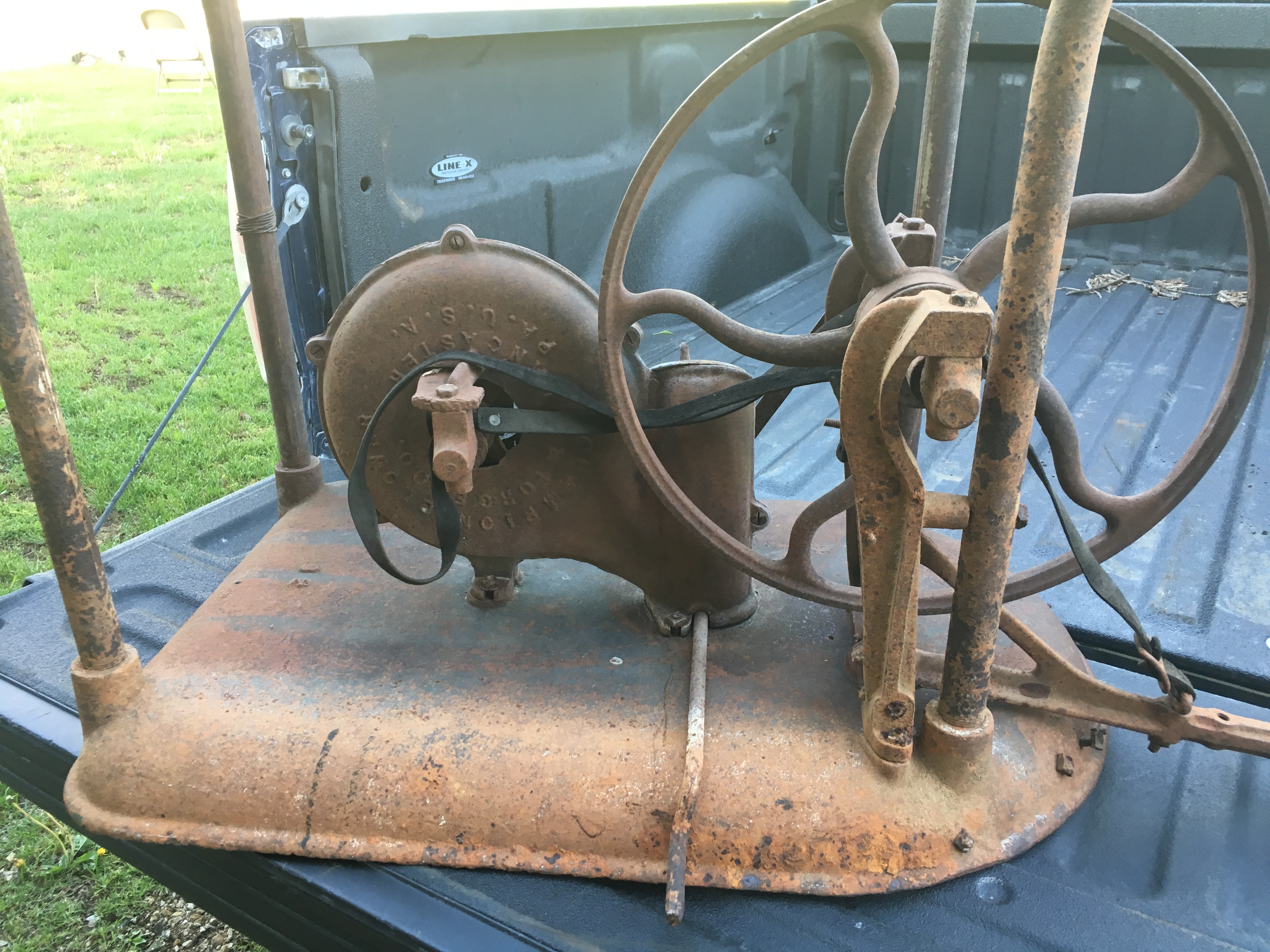

Here's my new project.
I think its a Champion No2 Lever Forge. It's minding the yoke for the lever so I'll have to fab something up.
Does anyone have one of these? I'd sure like to see some detailed photos of the yoke.

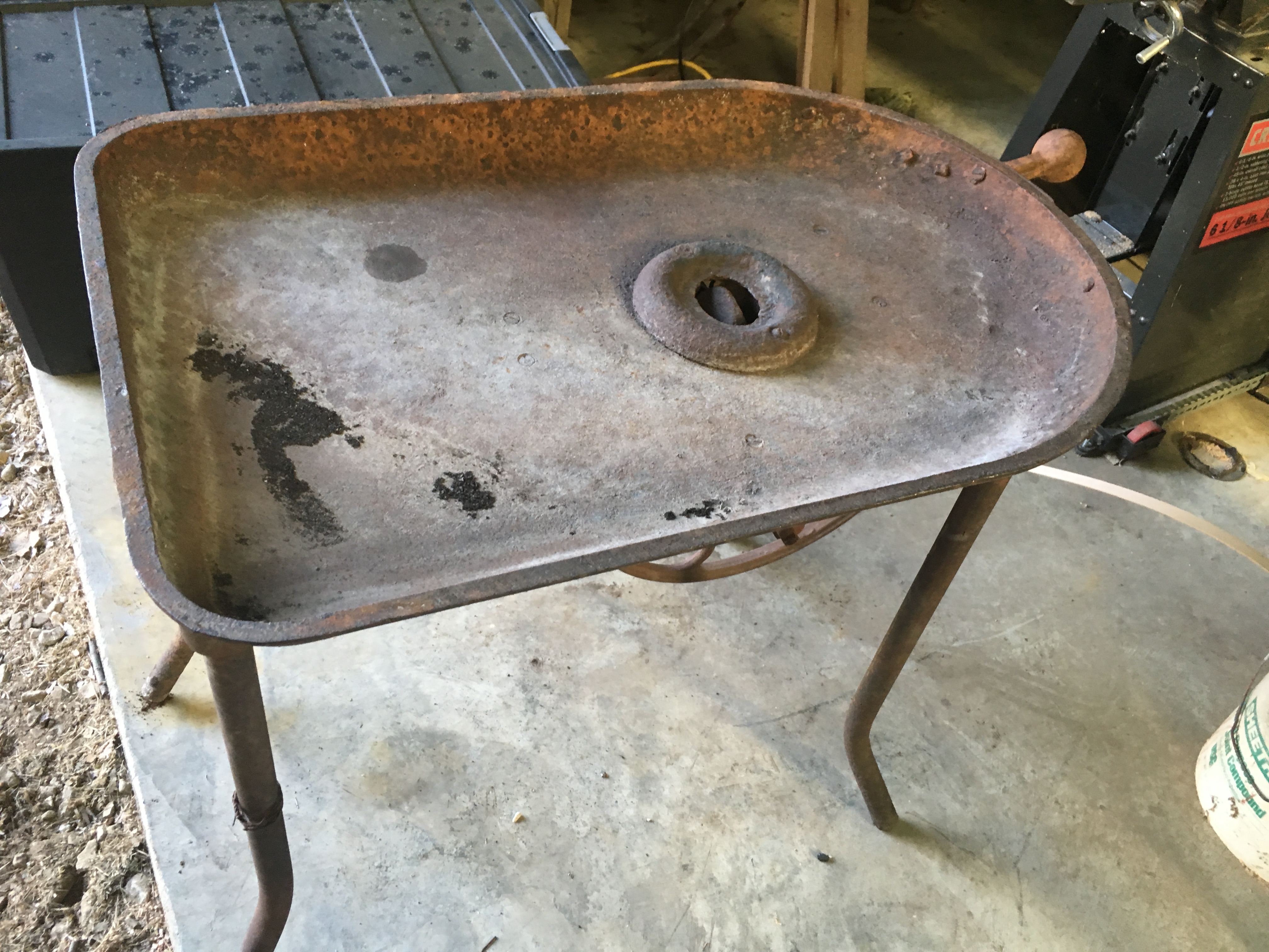

Hi Terry, I have two identical forges, I don't use them but got both operational. They have an interesting centrifugal clutch which I had to repair on both. You are missing both the yoke and mounting bracket, here are some pictures I hope they help you. Let me know if you need any more pics.

Would you measure a couple of things for me? I'm wonder how tall it is for the mounting bracket and how far out from the forge the mounting bracket is at the top. Id like to get it as close to the original position as possible. Thanks!
Hi Terry, the mounting bracket is 5-inches taller than the top rim of the forge, the top edge of the bracket, nearest the forge, is 3-inches out from the top rim of the forge. I measured along the outer edge of the bracket along the curve, approximately 11 1/2 inches, give or take hard to get the tape measure precise. I could bend some wire along it for a better measurement. Let me know if these measurements help. I'm fixing fences today so in and out.
Thanks Direwolf!
I may message you directly if I have any other questions while I’m working to rehabilitate it

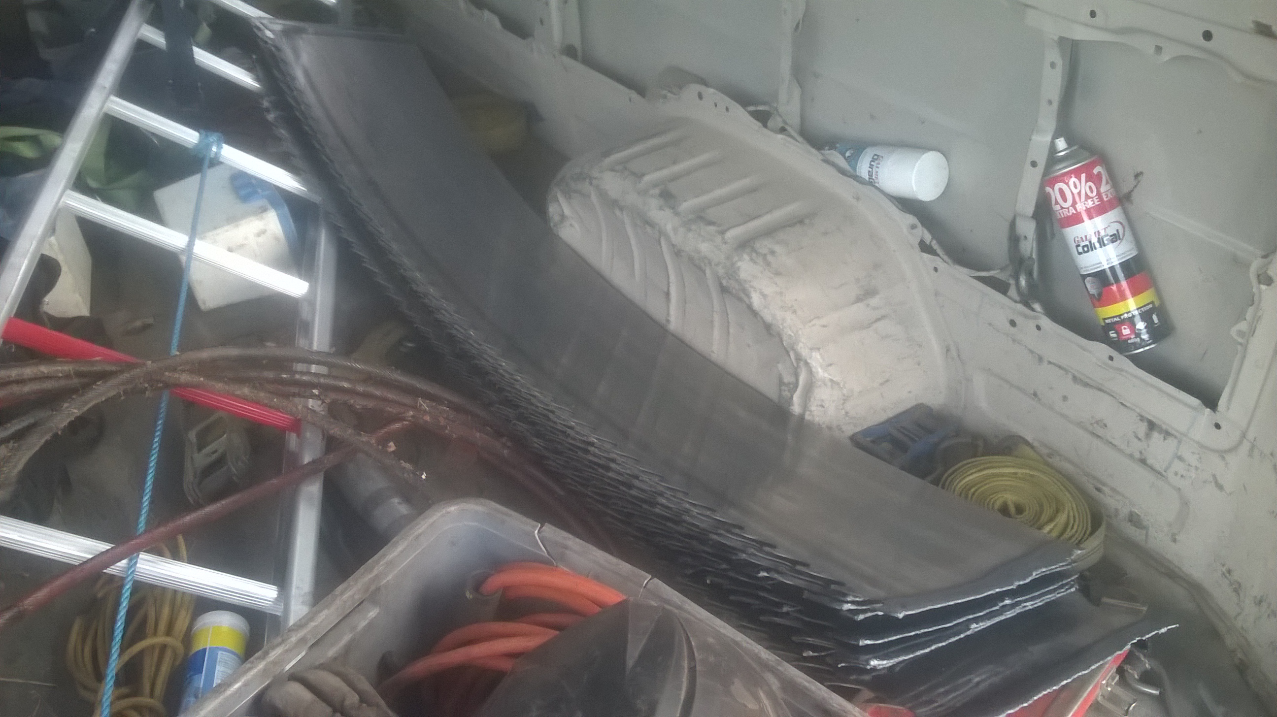

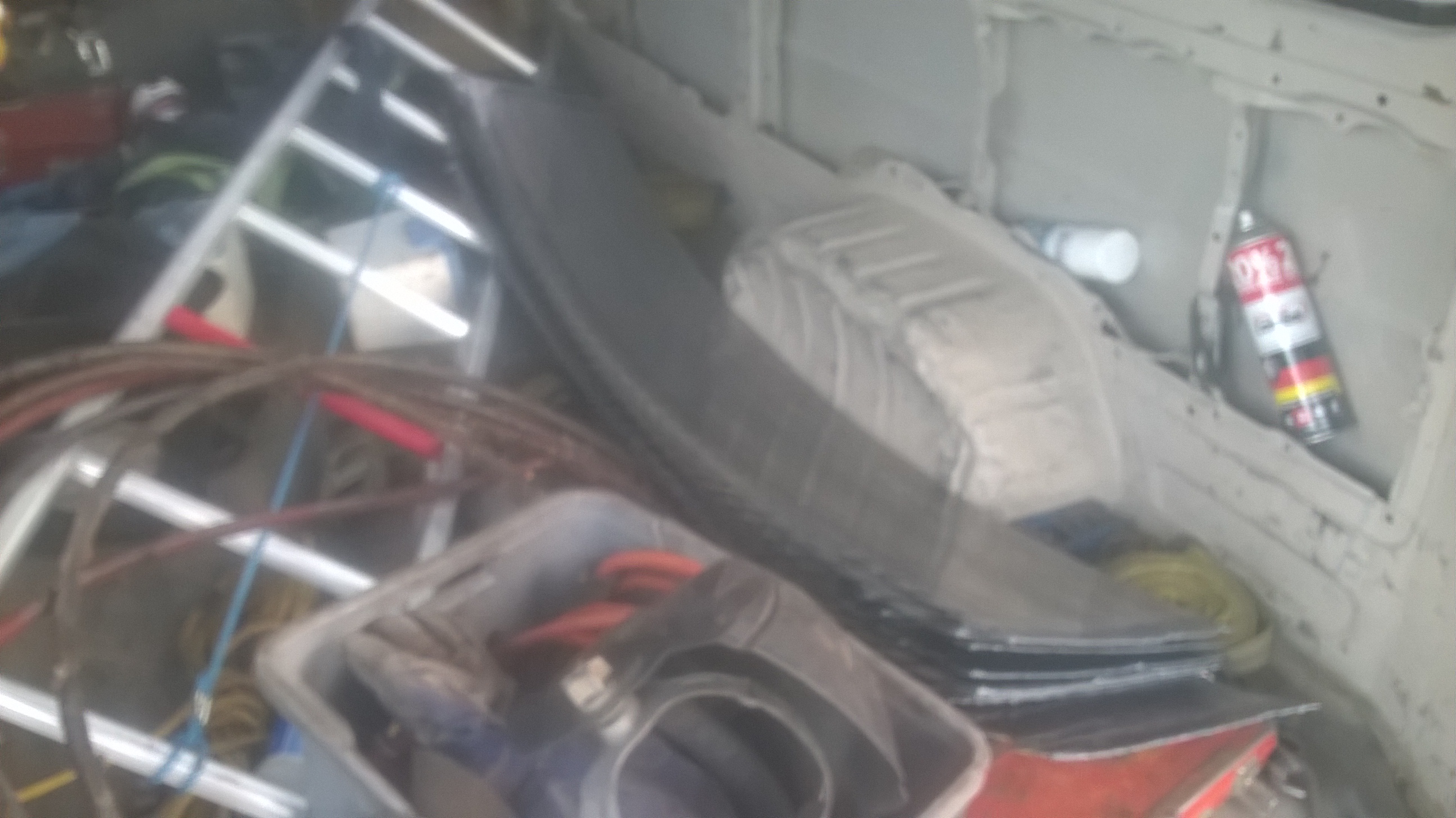

I was out at a sawmill today and did a bit dumpster diving and aquired probably over 100 kg or 220 lbs of large bandsaw blade I think I will give some of it away to a couple of other guys doing abit of forge work
Is that carbide tipped teeth, or just steel? If carbide tipped the carbide has some $$$ scrap value.
Big gun doctor the blades have stellite tips fitted but the actual blade band is the same material as what the last lot of blades were made from which apears to be 15n20 or such like. The saw doctor at this mill is one of my old motor bike racing mates
