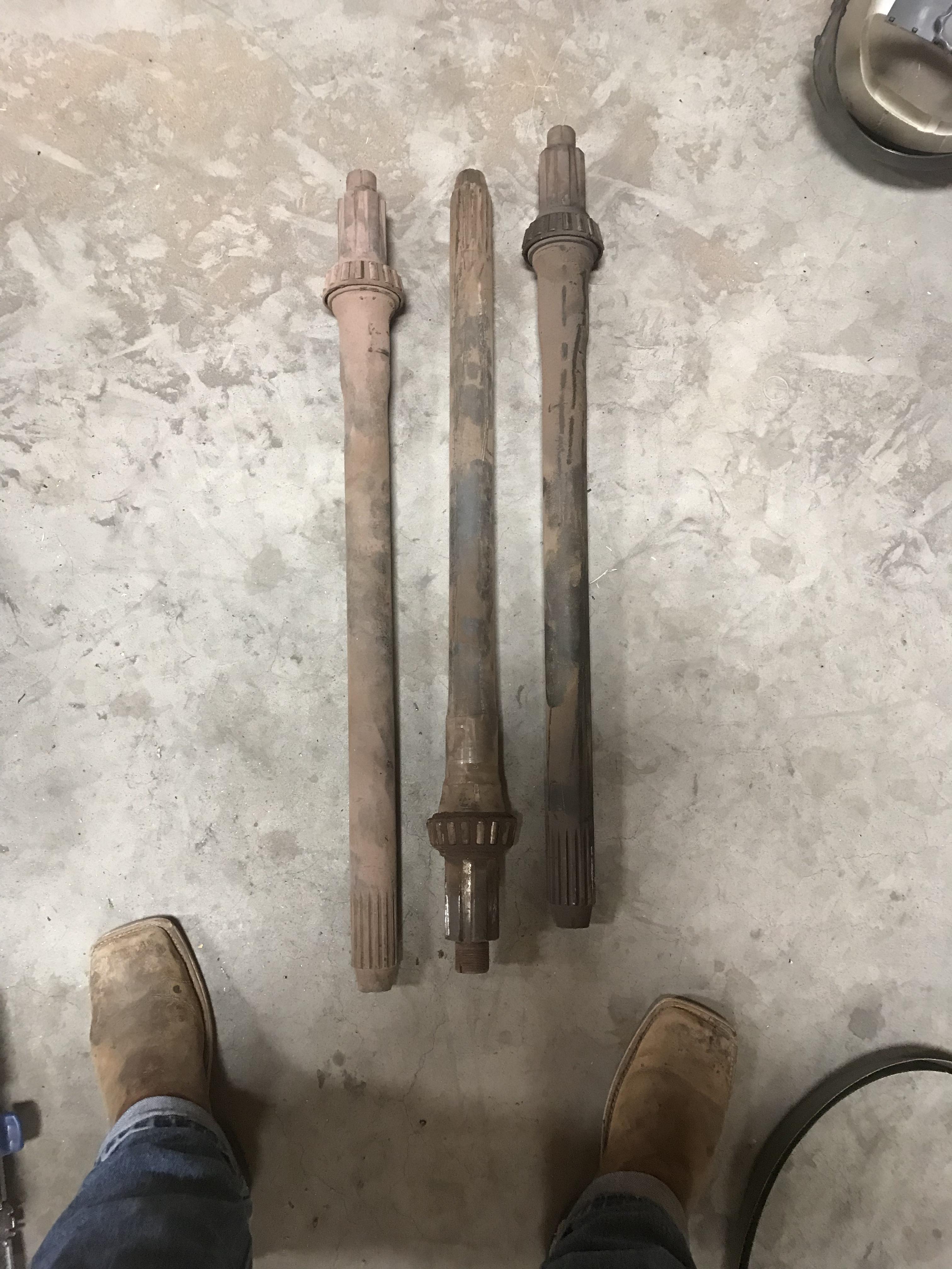

Picked up a few pto shafts out of 1948-52 Ford tractors. I assume is 4140ish but I’m going to have to do a little experimenting to see how it heat treats.
1045 was called Plow Steel at one time...and was use for farm implements.
If you have an operation that requires indexing you might be able to work the splines into the tooling design.

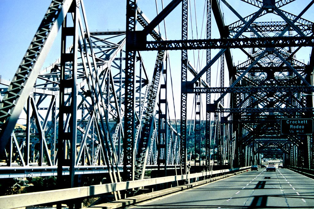

From a recently demod bridge, built in 1941.
1 1/2” square re-bar
I havent done ANY testing yet, any ideas on its composition? I have no knowledge on reinforcing bar history. I know that nowdays its like a box of chocolates, you never know what you’re gonna get.
But back then it might have been a different story?
Some of the square rebar from the 1920's will harden and is good for making tooling from---more of a medium carbon steel.
1941 would be on the cusp of the war effort; so probably better stuff than during the height of the war when production was geared toward the war effort.
I'd suggest pounding some down to 1/8" thick and quenching from nonmagnetic in water and wearing PPE trying to break it with a hammer.

Tested square re-bar today. To check for consistency I tested 3 cross sections in 3 areas of the entire bar. Results were the same in all 3 areas.
Sparks looked like ‘medium’ carbon when i compared to 1018 and 1095  it looked like a good middle ground.
First I did a forced air quench, vice then hammer. It bent all the way to 90. I squeezed it with vice to see how far it would go before cracking
Next was an oil quench, first blow with hammer and it bent about 10-15 degrees, second blow and it snapped off.
last I quenched in water and it snapped clean off on the first blow.
all 3 tests were the same on all 3 parts I tested.

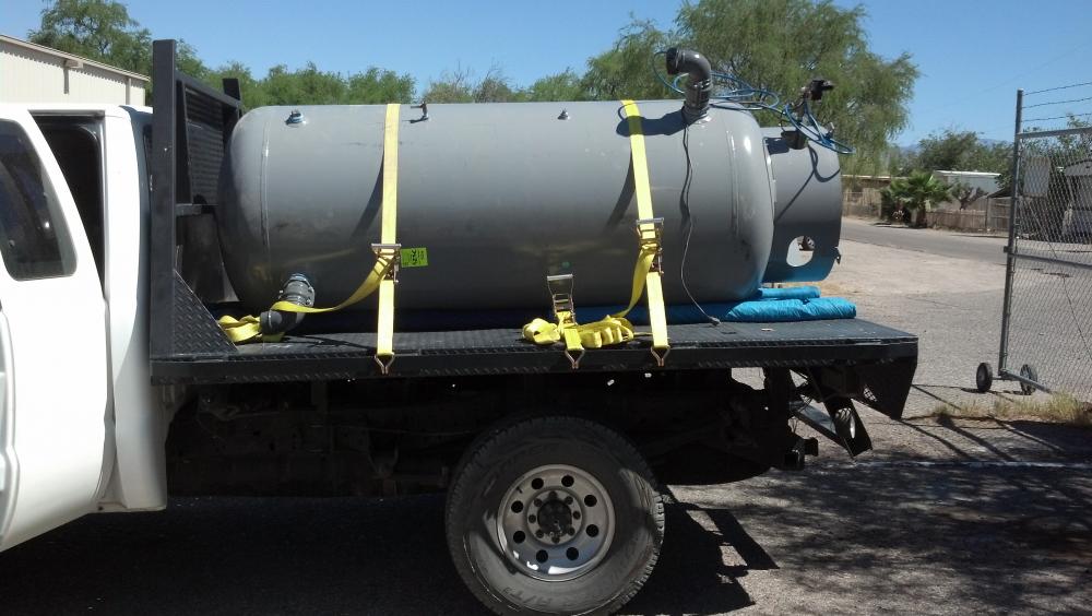

My 20 year old compressor tank sprung a leak and I have been looking for a replacement.  At an auction this past week for less than the cost of a new 120 gallon replacement tank I picked up a nearly new (2017) 400 gallon tank with automatic drain valve and 690 pounds of 325 mesh powdered metal.   The powdered metal included 189 pounds of iron, 95 pounds of stainless steel, and 191 pounds of bronze.   The rest or the powdered metal was brass, white bronze and nickel silver.
Good score on the tank,.......but just whatcha going to do with all that powdered metal???
Nice score on the tank. I'm curious too, whatcha gonna do with the powdered metals? :)
My first thought was using the iron powder for canister damascus.    However it is looking like it is just Fe with no carbon content so not hardenable and probably not the best choice.   However powdered metals are used for cold casting metals using resin and molds.   It looks like the powdered metals are selling for $10-$15 per pound on ebay so I will probably sell it on ebay and then buy stuff I can use.

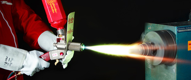

Powdered metals are also used for metal spraying. My sprayer used a wire, but there are some that used powders. image.png.a447370ce537ad5febdc05109e0eb400.png

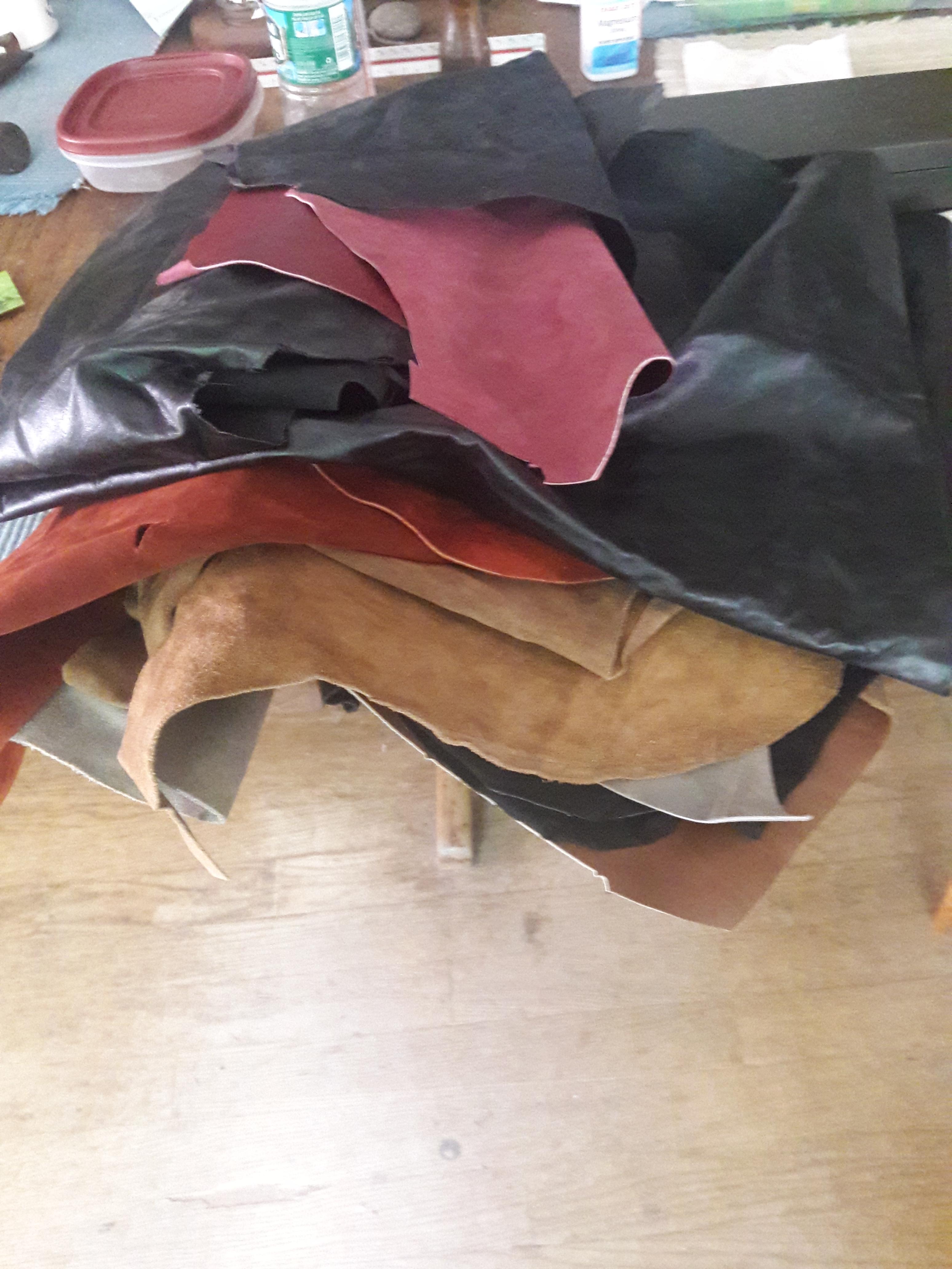

Not exactly forging but I got a stack of leather from a buddy clearing out a house. Maybe I'll learn how to make a sheath.
Looks a bit soft for sheaths. More like upholstery sides. Now being soft they will make nice shop aprons, or chaps for around the forge. Look at the cut edges, if it has a white line in the middle it is chrome tanned. For sheaths you want vegetable tanned, it will be a bit stiffer and will hold a shape much better. Leather worker dot net is a great resource. They are the I forge Iron of leather.

Yeah, it is a bit thin. Thanks the reference, I will check it out!
