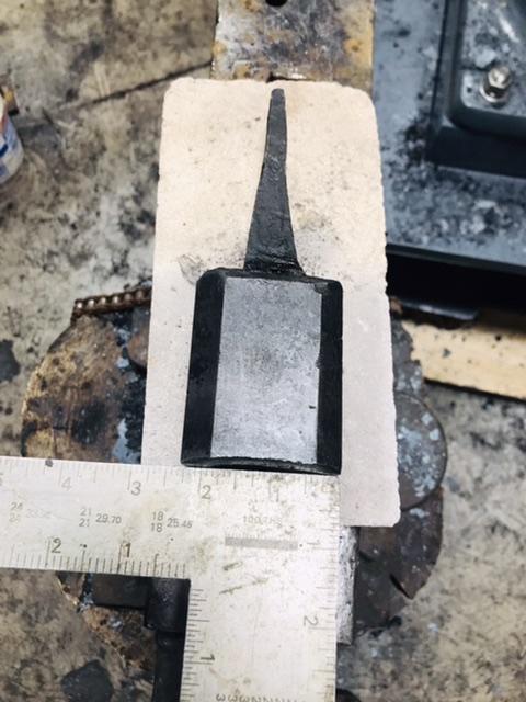

Jobtiel1 Posted May 25, 2022 Share Posted May 25, 2022 Welding a tube or solid shank that fits the hardy hole (square hole) and welding a piece of steel to that as a block and polishing that up will serve you very nicely as an anvil block for your jewelry work. Looking something like this: ~Jobtiel Quote Link to comment Share on other sites More sharing options...

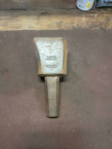

Goods Posted May 25, 2022 Share Posted May 25, 2022 My son made this stake anvil: Of course I was there to supervise his work on the power hammer. The face would need cleaned up a lot more for the work your planning on doing, but just this and a stump and you’d be good to go. It was a fun project to work with him on. Maybe you could get hooked up with a local smith and make it into a fun project… Some nice copper work as a “thank you” maybe? David Quote Link to comment Share on other sites More sharing options...
