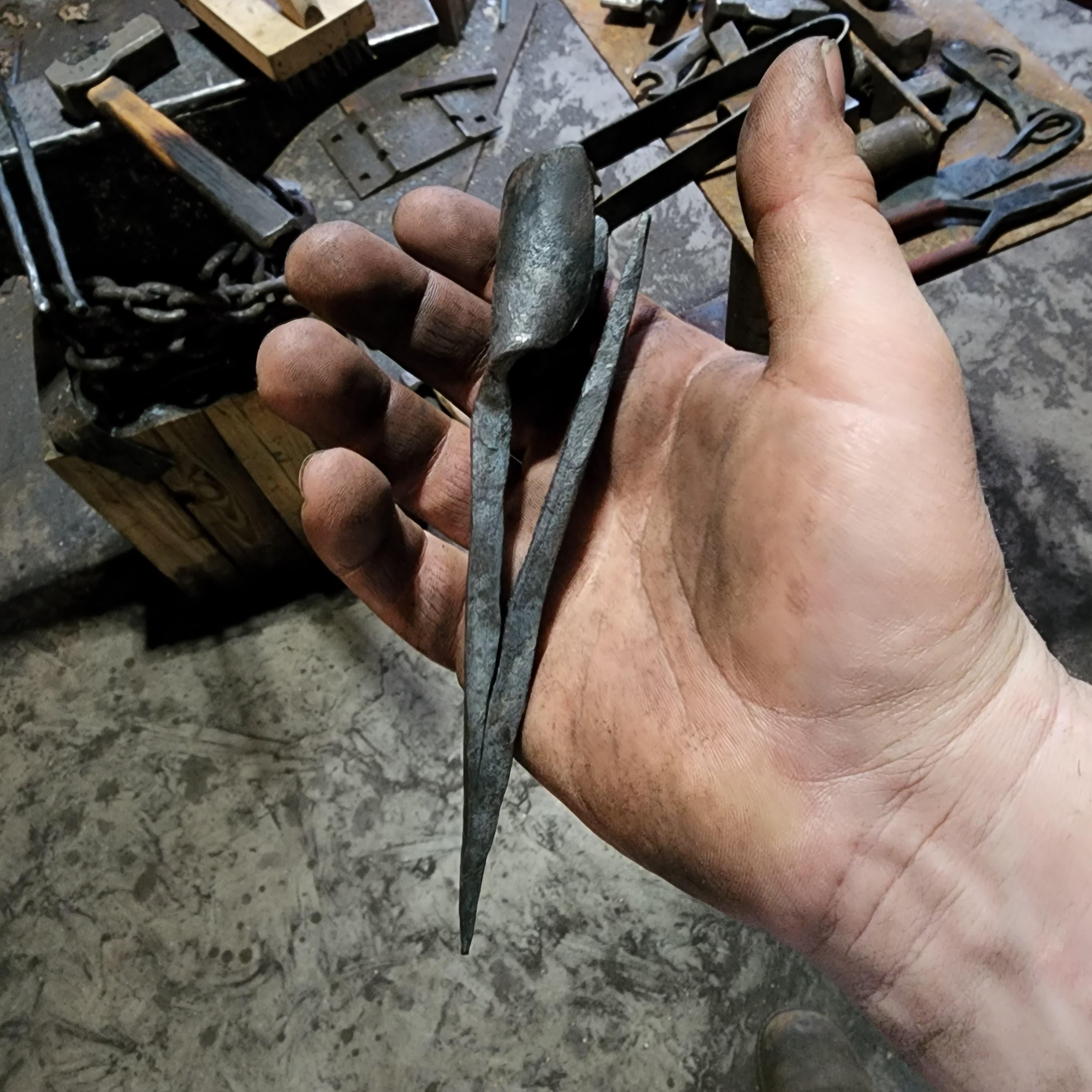

BillyBones Posted February 21, 2022 Posted February 21, 2022 Thanks ya'll. I may have been a little quicker but early on i was having heat problems, i forgot to dump my ash when i cleaned out my fire pot and it was choking my airflow. JHCC, i did convert to inches. That metric mumbo jumbo just aint my thing. But mostly becuase i do not have any rulers in metric. For anyone wanting to convert that may not know 25mm is 1". Starting stock would be 4"x 1"x ~1/4" (6mm doesnt come out even so there abouts 1/4") Isolate 35mm = 1 3/8" approx. Draw out the cup to 60mm = 2 3/8" The shaft 135mm x 8mm = 5 3/8" x 5/16" The shaft tapered 210mm = 8 3/8" The cup at 20mm = ~3/4" Fold and weld 90mm = 3 7/8" When i was working on transmissions converting English to metric became 2nd nature to me. Now these are not exact measurements the exact measurements would be 25.4mm to the inch. But really for us working hot metal 25 should be close enough. For instance 3/8" is actually 9.52mm, but for us i think 10mm works. Hope this helps. Quote

jlpservicesinc Posted February 22, 2022 Author Posted February 22, 2022 Billybones, Nice job. Very helpful The English measurements were on the second photo. The cup should read 3/4"ID vs OD Remember the measurements are off some.. The fold and fireweld at 90mm was not on the money if one wanted 10mm of shank sticking up. Quote

Chad J. Posted April 12, 2022 Posted April 12, 2022 Almost got it. The forge weld failed but that was the first time I got the propane forge hot enough to try. Guess I'll try again tomorrow Quote

jlpservicesinc Posted April 13, 2022 Author Posted April 13, 2022 Chad, looks pretty good.. There should be a round section under the candle holder and on the spike running along side the candle holder. Are they needed.. Probably not.. But the skill set represented in the drawing is one of measure.. Or measurements. on 99% of the items I make they are forged to a specific size.. Where something will vary is the weight.. Axes are a great example.. Its the shape to me that is the most important.. The weight is secondary and can vary some.. Not sure what the 6 3/8- 6 5/8" represents.. I think it has something to do with the original forging out to the marks on the anvil. Quote
