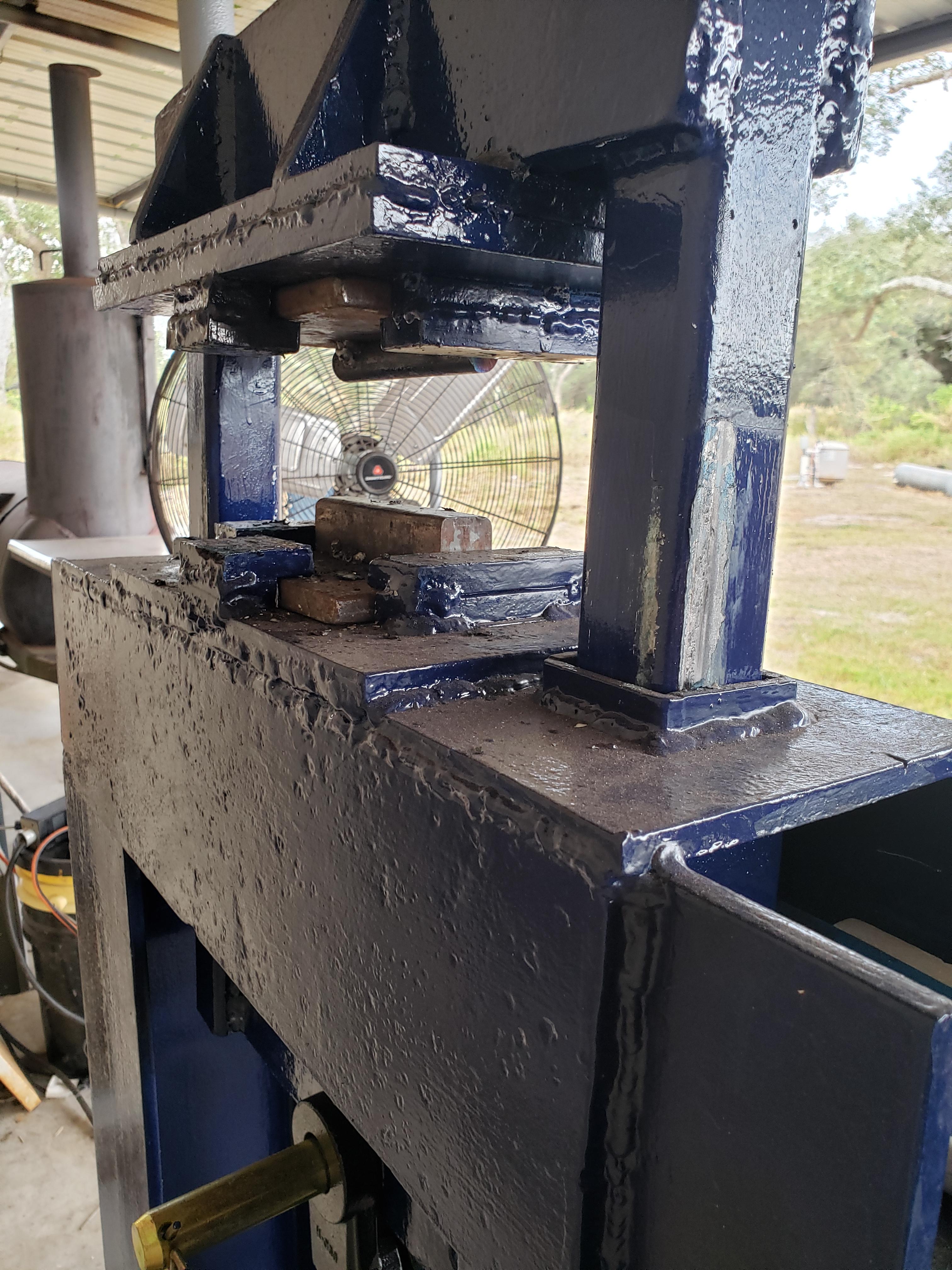

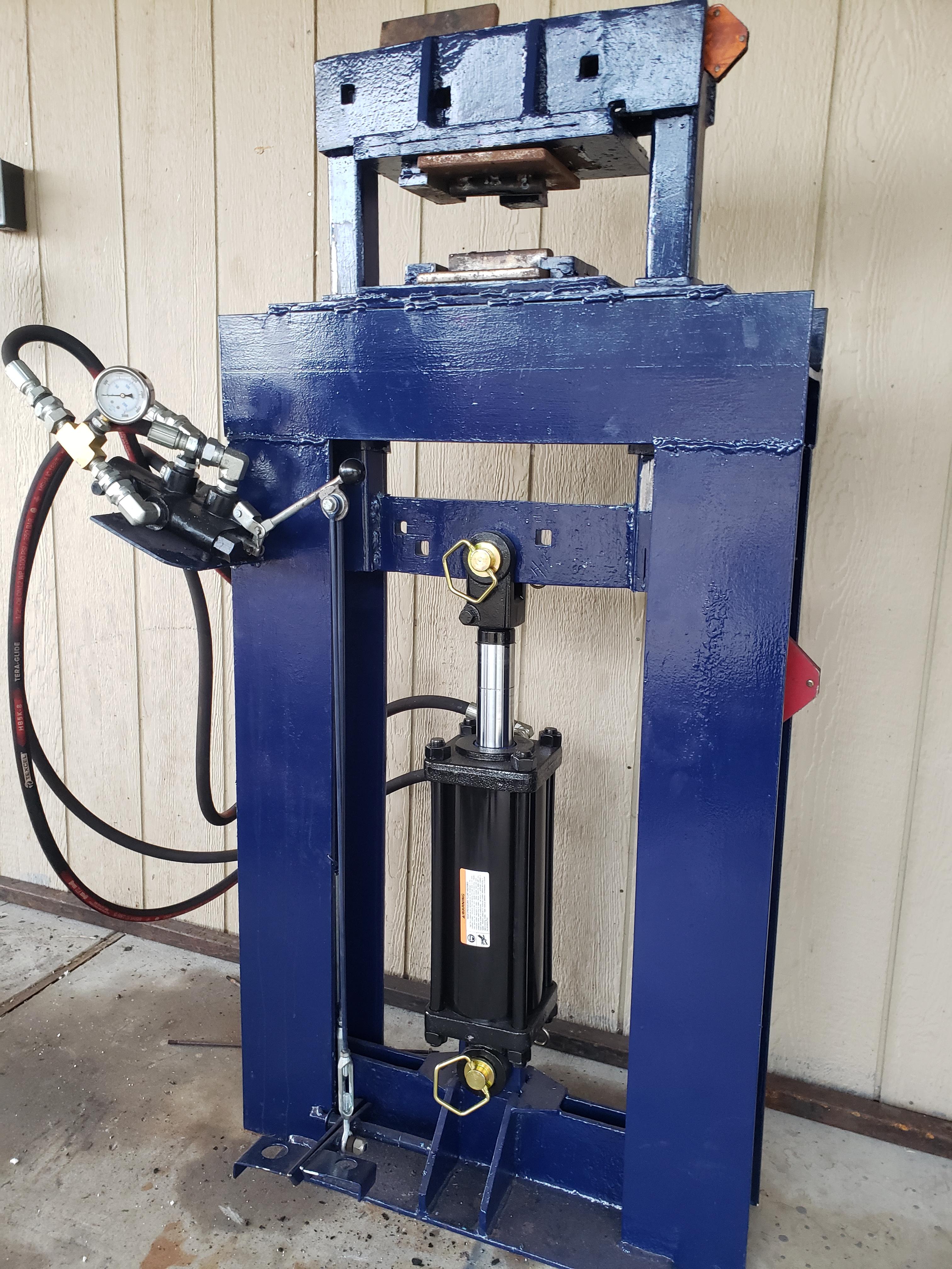

Hey everyone. I recently built a hydraulic press without any plans. It has a 5hp electric motor powering a 2 stage 19 gpm pump.  Originally it had a 4 inch bore with a 12 inch stroke. I was disappointed with the power. I replaced the ram with a 5 inch 10 inch stroke. It helped a small amount, but I'm still nowhere where I should be. Any help would be appreciated

Some pictures of your cylinder, hose/pipes, pump and controls will give me a good idea of what you are working with, since the cylinder is bought (and with that I guess it is brand new) the seals should be good and not be your problem. Also, measure your pipe/hoses, maybe they are way to small for the amount of oil your try to force trough them and that creates lots of turbulence in the flow.
Is the pump outfitted with a safety valve? Or is it just the control valve?
Oh, scratch that. Maybe I do have some "fool" lurking somewhere in my genome, because I don't ever remember reading anything on accumulator in any of my research. Im sending pictures of my press body and the separate power pack located on the other side of my shop wall. Hopefully someone will see something I missed. If you can't tell from the photos, my hoses are half inch. They are mostly 24 inches in length with the exception of the two passing through the wall. They are both 48". Before anyone gets mad at me, I do have a steel plate protecting my hoses from hot slag. Its pretty big, so removed it so I could get better pictures. Thank you for taking the time to help. I signed up to this site some time ago, but "got busy" and haven't really been on much. After I posted my last question, I've gone back and read a mountain of chat. Im am so impressed with the brotherhood on this site! Its awesome to see everyone giving freely; sometimes a lifetime of hard earned experience in blacksmithing. Thank you all.

What is flipping the cylinder 180 going to help? With this design the cylinder will always be retracting to apply pressure and not extending.

The surface area of the piston is greater on the end of the piston, without the rod/ram. You are losing effective pressure by 'pulling' the ram together, instead of 'pushing' the ram/piston. Hydraulic systems are mathmatic. Working pressure on the surface diameter of the piston (pi x R2).
Neil
Yup, what Swede said, he wanted an answer without math. If you use a cylinder you use the part that has the most force, not the part that has the least force. 50% more surface, and also you are move a lot less oil when the cylinder is flipped, right now you are putting in 19gpm (if you go full flow) and have to move double that from the piston side of the cylinder. Guess how much force that takes. If it is flipped you extend the cylinder with 19gpm, with pressure over the entire surface (so without the rod) and you only have to move 9,5gpm from the rod side (which removes a lot of pressure from the return hoses). The 1/2" hoses should be big enough, we used those on 100 L/min and 160 bar, but I think that T-piece with the meter is pretty small.
I would make the following change from that setup with the meter: change the EW (elbow) to a ET (T with a nut in the middle), put the hose on one side, and use a GZ (2 nuts connected back to back) to connect the meter.  This will remove a lot of friction.
I'm following along, but I admit I'm a bit confused here.  I get that the "push" is stronger than the "pull" and the reasons for it.  What I don't get is how flipping the cylinder 180 degrees will make any difference.  In the current configuration or with the cylinder flipped 180 degrees it's still using the "pull" of the cylinder to apply the pressure.   Wouldn't it require redesigning the system so that the top die was stationary with the bottom die movable to accomplish the goal of using the "push" action of the cylinder?  Either that or mounting the cylinder overhead to push the top die down, but again that's a frame redesign.  What am I missing?
Also switch the hoses. Just a question, the frame of the press, was that a home made or bought? Since I have a good idea why you are having trouble with the hydraulics, i also see some things in the design that bother me. Moving pieces where the pain is scraped is never a good sign.
As it stands it applies pressure to the dies by pulling down on the moving die holder.  It does this by pushing oil into the part that has the piston rod mounted in it---so the smaller area to apply force on it.  If you flipped the cylinder and redid the connection  so it was attached to the base of the bottom die holder then the full size of the piston would be applying pressure to pull the top die down. Reminiscent of the pneumatic KA 75 powerhammer that a friend of mine has.
I prefer systems with a stationary frame and only the die moving on the end of the piston myself.  Easier to beef them up for upgrades for more pressure.
I guess I still don't get it.  It appears that in either configuration the oil has to flow into the portion of the cylinder that contains the ram in order to retract the ram and provide downward pressure on the top die.  Why would the retraction force of the cylinder be any different whether the cylinder was mounted base up or base down or even horizontally?  Doesn't the surface area remain the same on the ram side of the piston?  I can't see how flipping the cylinder allows the greater surface area of the other side of the piston to come into play.   It's still pulling the ram in rather than pushing it out, right?  Does it create vacuum/low pressure by pulling the oil out of that side of the cylinder rather than just pushing oil into the other side?
now you are putting pressure on the rod side (to pull the die down), you want to put pressure on the other side of the cylinder. So disconnect the hoses, flip the cylinder and connect it back up again. So the hose do not change position. Just do as we describe and see if it changes things. There are not many more ways I can explain it without making a full on drawing and diagram.
I get that we want to use the cylinder to "push" rather than "pull."   I just don't see how that can be accomplished without changing some combination of the frame and the movable portion that holds the top die. Simply flipping the cylinder 180 degrees and attaching it to the same points doesn't change it from "pull" to "push."
There does not appear to be enough room between the top of the frame which holds the bottom die and the bottom of the movable portion that holds the top die to install the cylinder so that it can "push" the top die down without some extensive modifications.
Buzzkill is correct; without changing the location of the cylinder within the press, flipping the cylinder itself isn't going to do anything. You're still going to be pulling the moveable die down onto the fixed die by retracting the piston, regardless of whether the cylinder is right-side-up or up-side-down.
However, if the frame that holds the moveable die is lengthened and the cylinder is mounted between that frame and the underside of the fixed die, then the moveable die moves downward when the piston is extended, which -- as noted above -- exerts more power than retraction.

Having it drawn out myself i see my error indeed, the pulling part of your machine made my thinking go all wonky (and translating English to Dutch and back. Will get back with a solution, but I am afraid it will need some change in the overall design.
