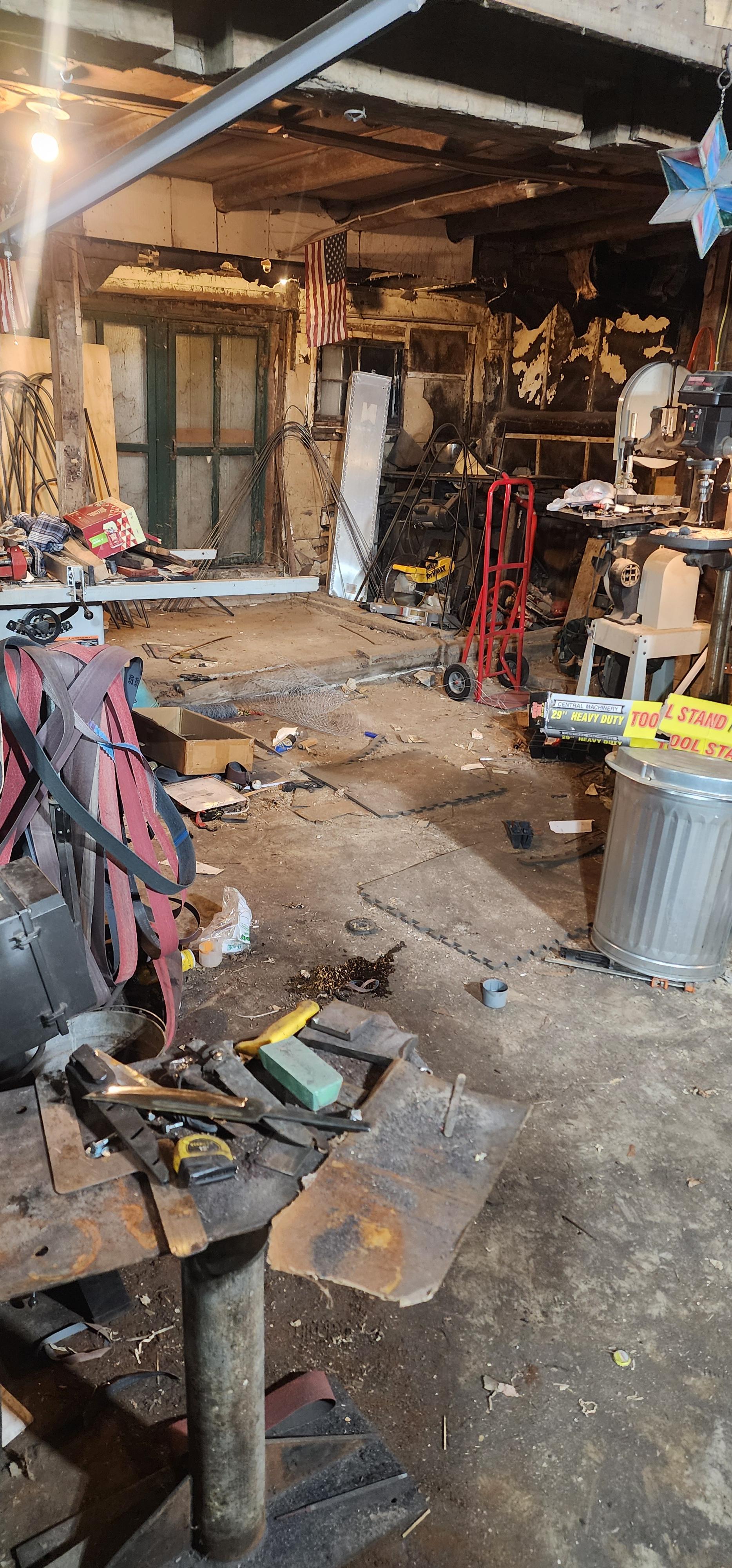

I spent most of the afternoon in the shop yesterday CLEANING.  I found my floor and several rejected projects.   I also bought a different stand for my belt grinder to get it off a wooden table I'd built for it.  I will use the table instead for assembly of knives and small projects... so it's going to be buried again in a couple days.
