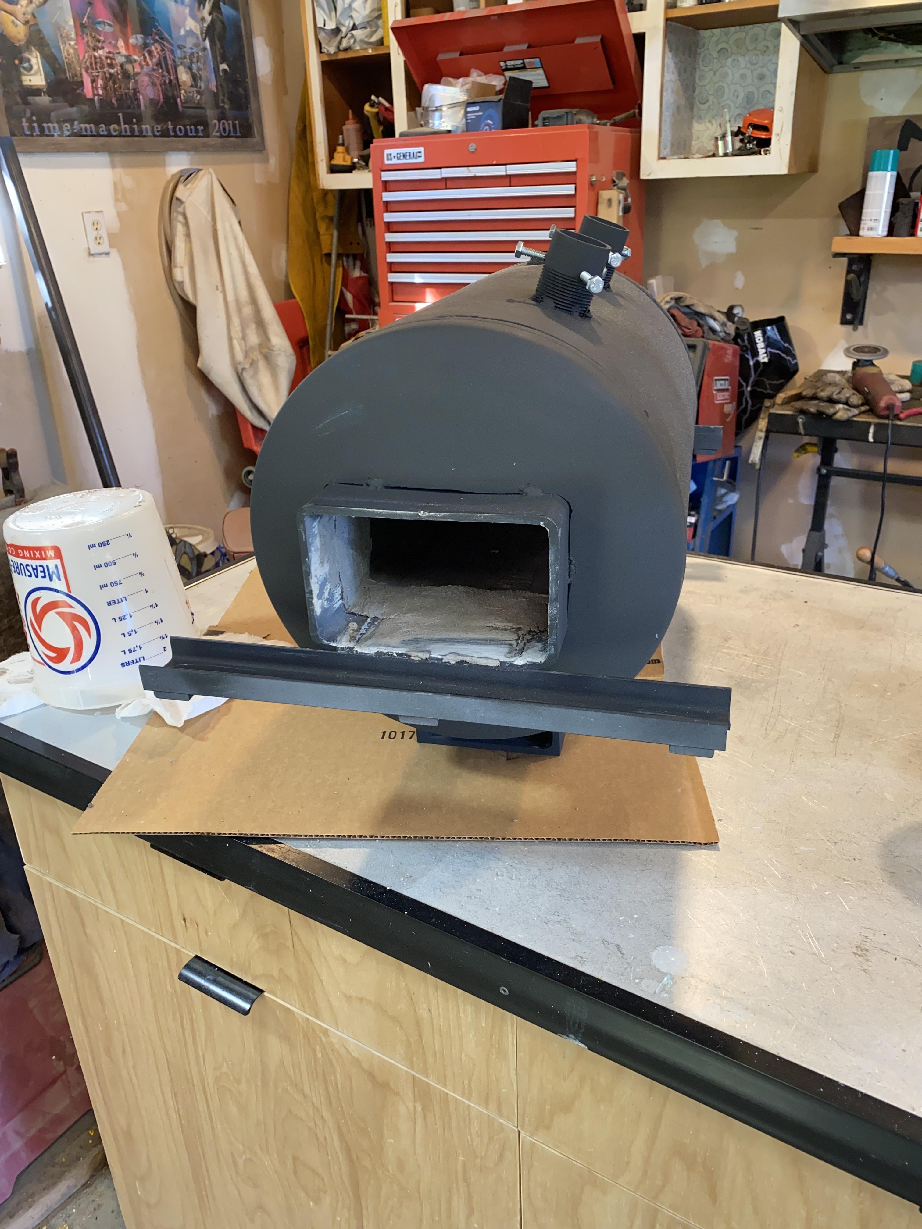

This high temperature paint (2000F) needs to be progressively heated to 250F, 400F, then 600F to achieve full cure.  What temperature might I expect on the metal shell with 2" of k-wool (3" on the ends)?

Maybe not so much on the outside of the shell, but the temperature will be higher at the openings, where the dragon's breath impinges on the surface.

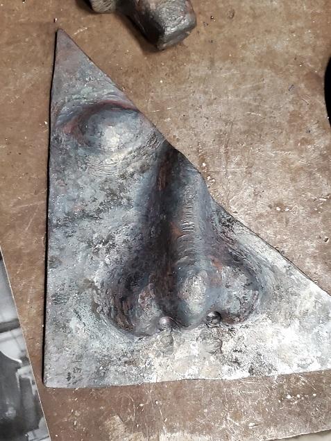

Nice nose Billy! Good work everyone.

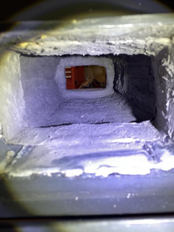

I applied the first coat of Satanite.  Well, isn't that special?
The first picture and the song "light my fire" of the doors pops in my head.

I either pushed the nose too far or burned it trying to use too small of a forge, or a little of both, so I started over and am taking a slightly different direction.

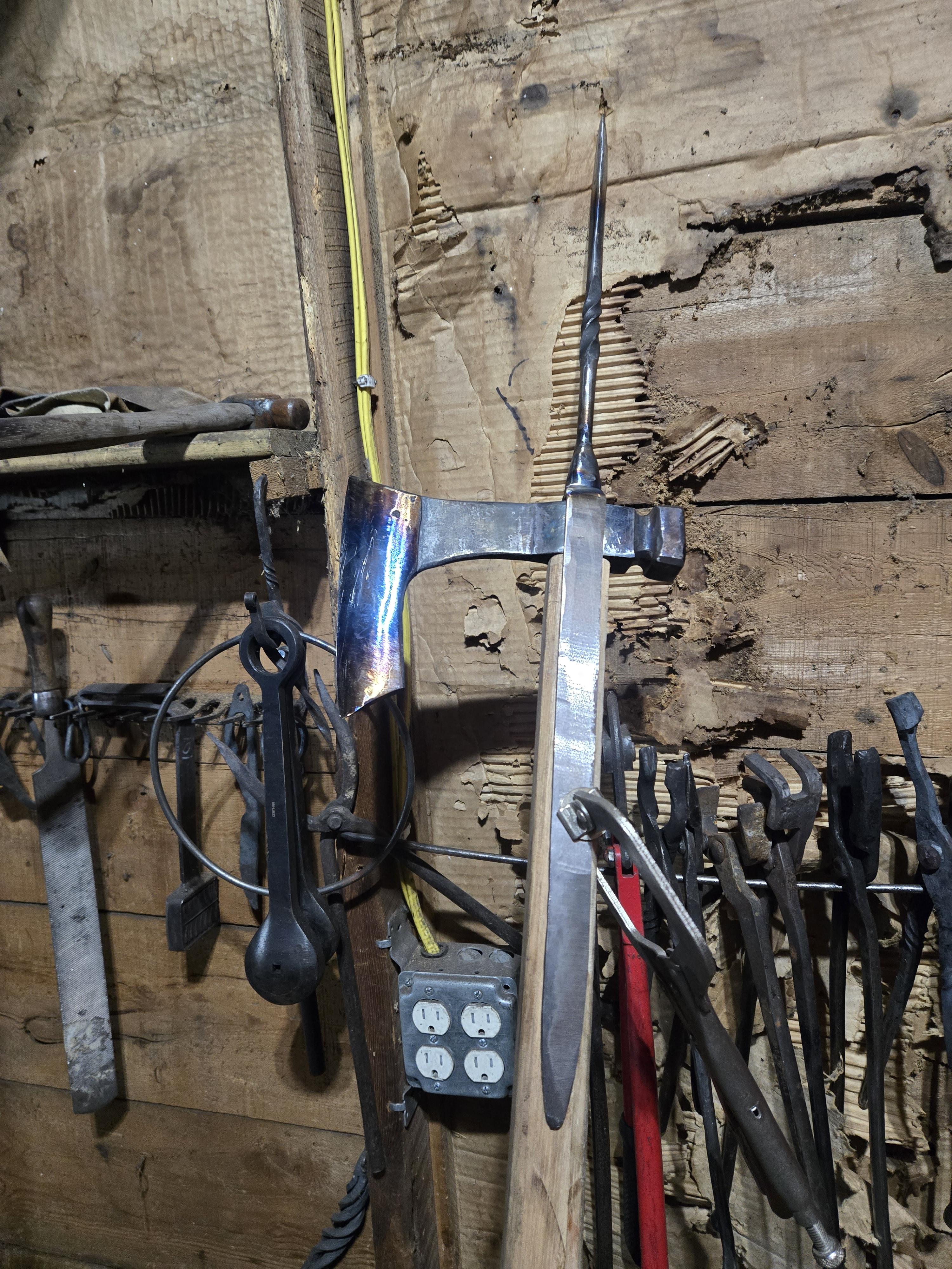

I had a bit of an issue in the shop yesterday.  Put a new 36 grit belt on the grinder and the thing blew apart when I touch the piece I was working to it.  I did have safety glasses on,  didn't have a hat though so I got an annoying cut in the middle of my forehead and some scrapes as it passed over my head and flew who knows where.   Took me a couple minutes after the shock to assess the damage and realized I didn't need a trip to the doctors.  I need to restock my first aid roll of paper towels now though.  I used the last 2.
The project I'm working on is my pole ax.  The body of the ax and the hammer face was punched and drifted drifted from a big chunk of wrought and I was on my second  attempt at getting a bit forge welded on.
First attempt it shifted and didn't weld but was too thin to chisel it out and try again so I cut it off and did a reverse on the bit weld with what I thought I had at side as a piece of pattern weld.  Nope, it was wrought.  I thought it welded up way too easily.
This attempt has stuck.  Forge welded some farriers rasps, chiseled then out and tack welded them in place.   Boom.  It looks and sounds solid though I kept working it at welding heat for several turns.
As a quick tip,  if anyone is still reading this, I left the handle on the rasp and put the pieces on either side so I had a nice build in holder.   I'll try and get pictures of everything tonight.

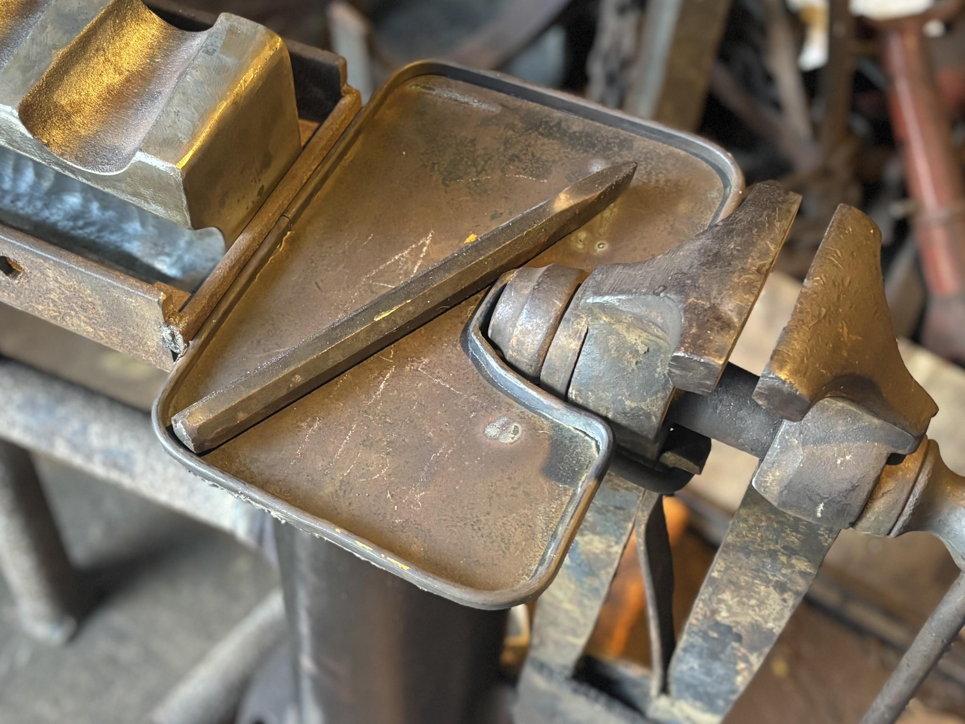

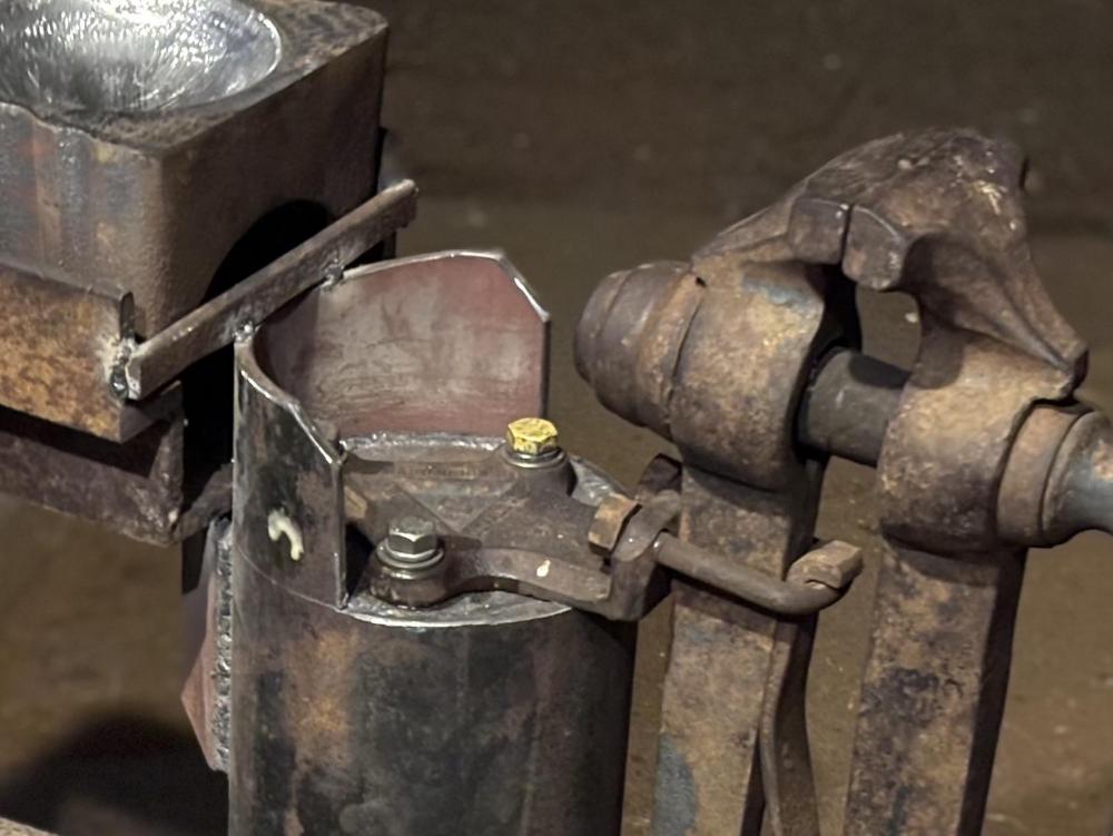

Added a work tray to the top of the main pillar in my combo vise/armorer’s swage block stand, from some 16 ga. sheet and a length 1/4" x 1/2" flat bar. The latter had been shorn from the edge of a larger plate, so one edge was already nicely rounded.
Before:
After:
This rests on the top of the big pipe on one side and has a simple support on the other that wedges under the vise’s mounting bracket. It can be popped out as needed to access the mounting bracket bolts.
Looks good John, I LOVE the tray I put on mine but I made it too large, it interferes with bending longer stock around the ends of the jaws.

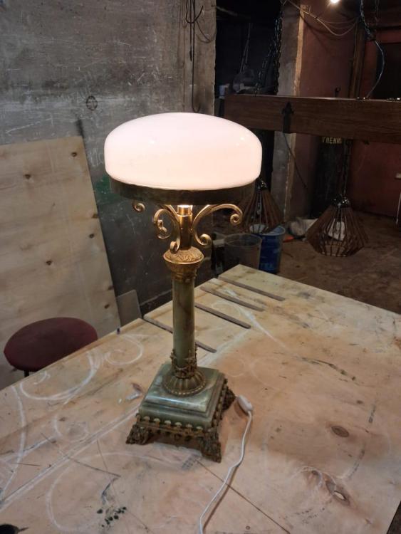

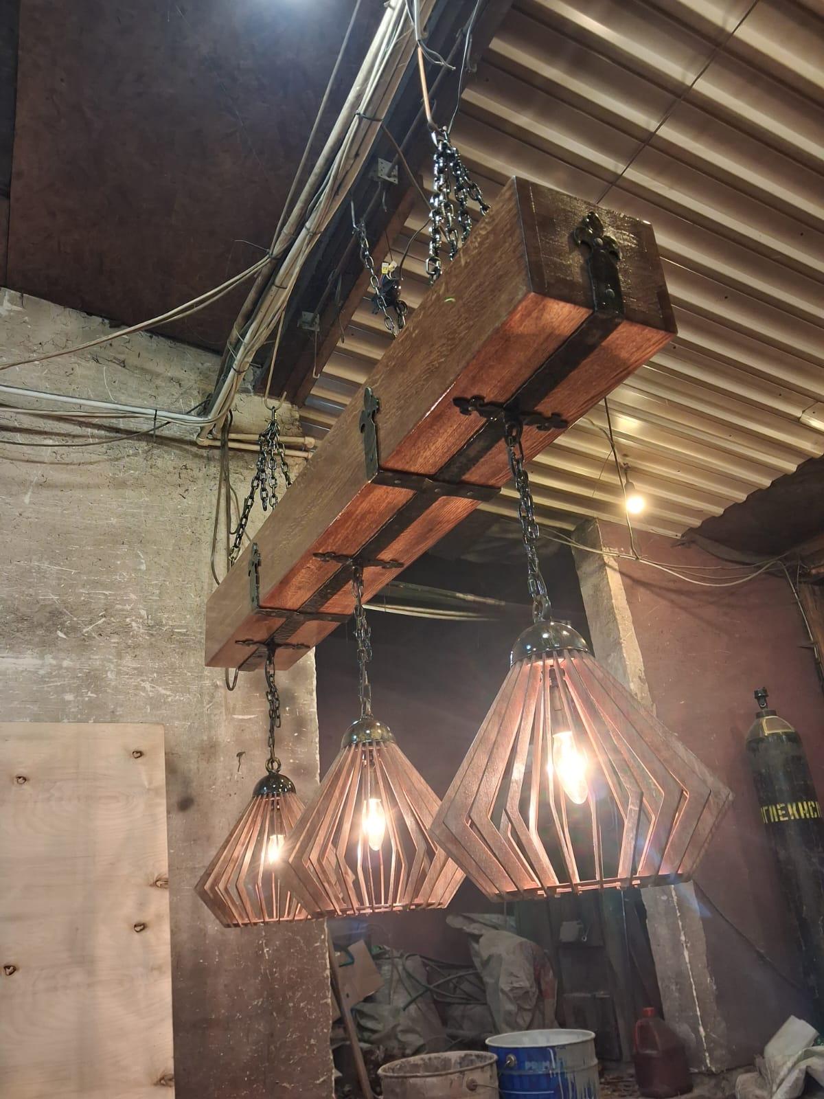

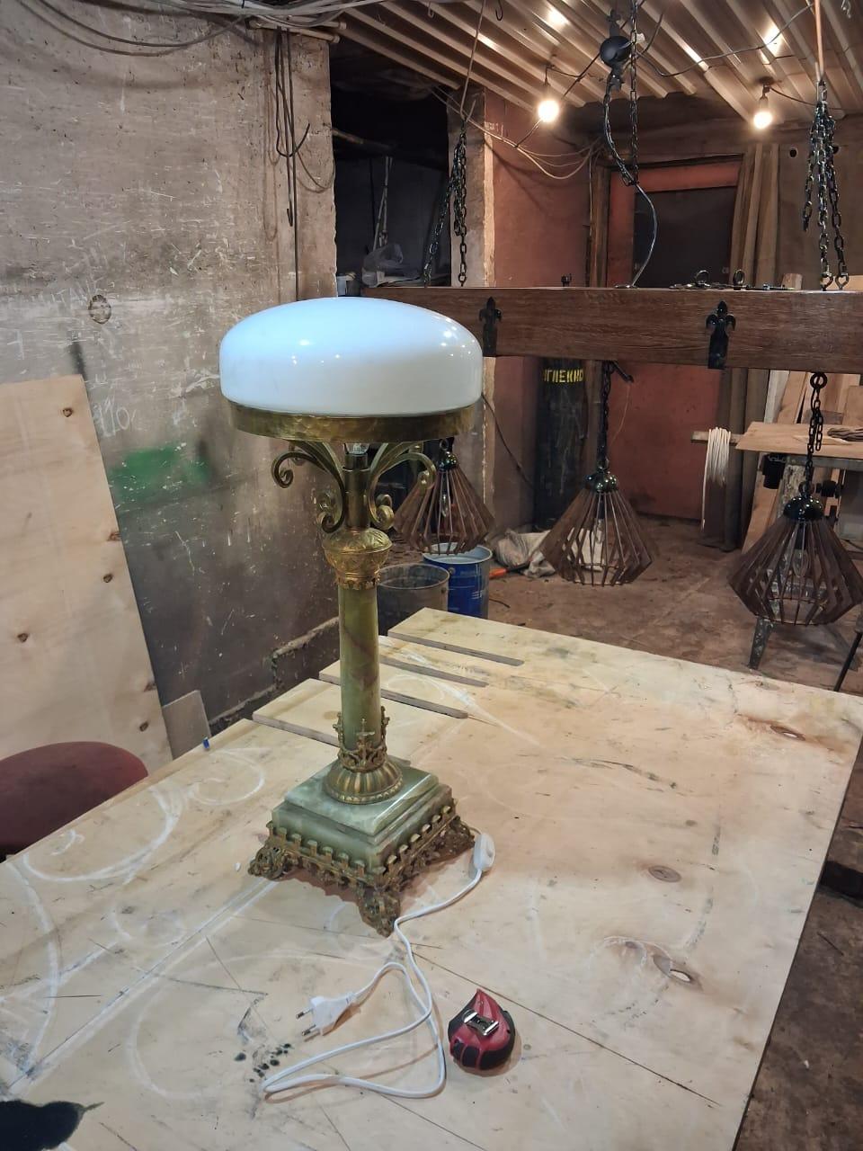

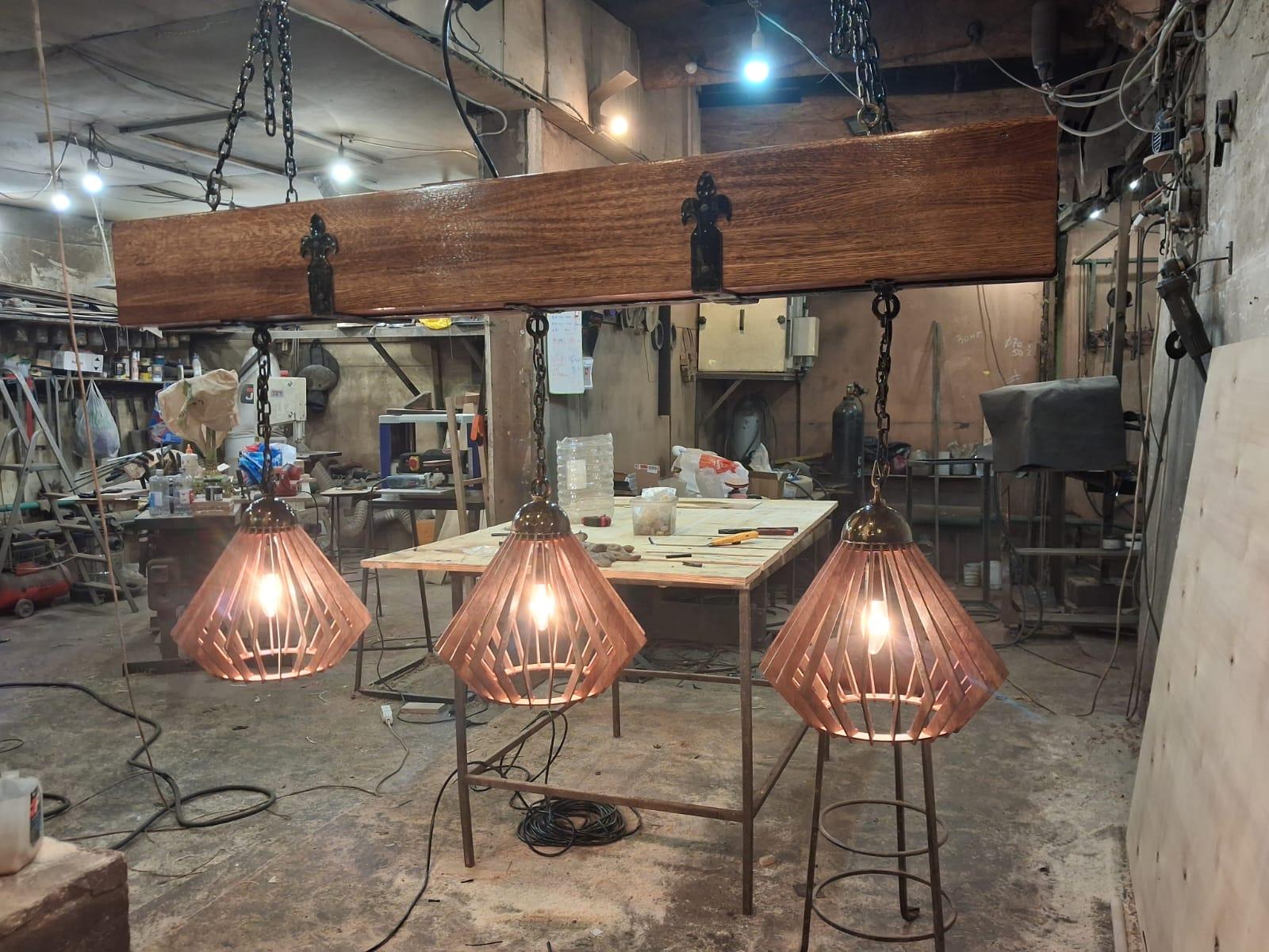

New chandelier. Another vintage kerosene lamp repurposed as a table lamp.
I had to look at the chandelier twice and the more I look the better I like it. I LOVE art that rewards the observer for looking closely.
I like the lamp well enough but no where nearly as much as the chandelier.

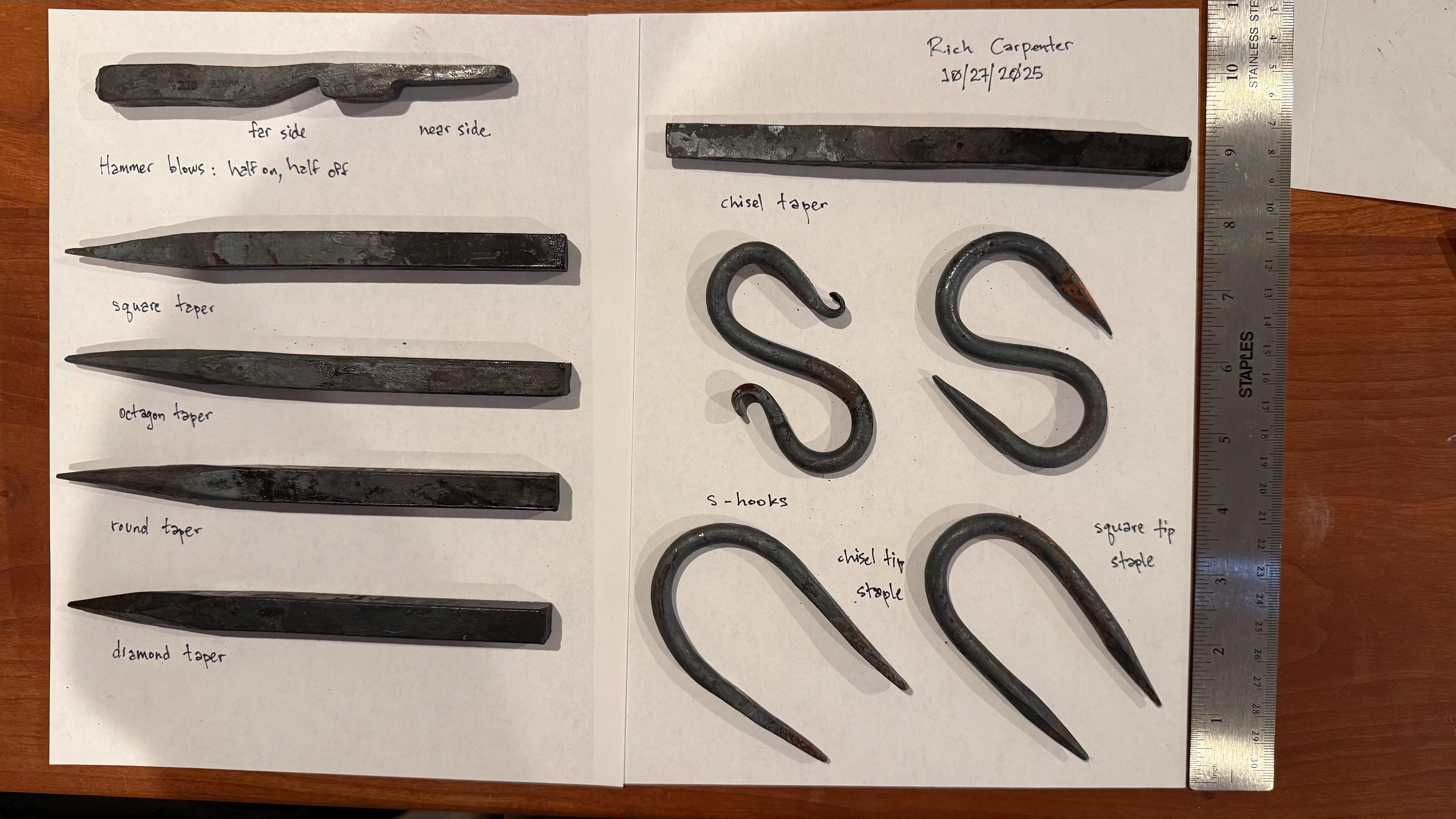

I worked on the ABANA NC Level 1 projects.  Tapers were good, but I still need to work on making staples and s-hooks.

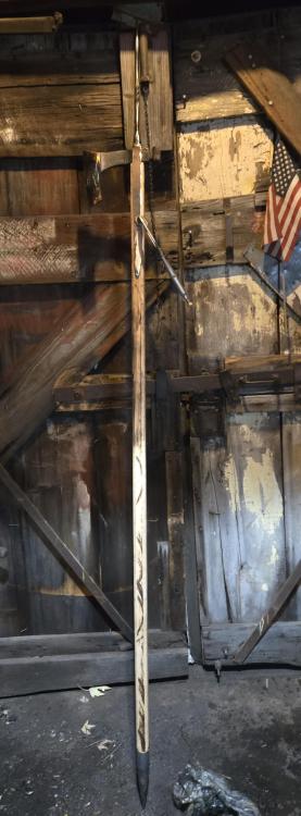

I did my first dry fit off the complete pole ax last night as well as doing a pair of heat treats in the blade.   I say a pair because the bit didn't harden in oil, I had to use water to get it right then torch tempered to purple twice.  I have 2 weeks to get this ready for the UMBA conference and the friendly completion of zombie slayer weapons.   The staff is hickory,  spike is 1/4 inch sheet,  and the spike is mystery metal that sparks similar to a medium to high carbon.
Forge welded langettes, a spiked ferrule on bottom, and a pole arm approaching the right length? Very pretty. I've often thought my favorite anti-zombie weapon would be a Lochaber axe for standoff distance and maybe a shorter bec de corbin for close in work.
The langettes and top spike are one piece.   Split and drawn out.  Punching and riveting or welding will be how I do it next time just to make it easier to handle.
