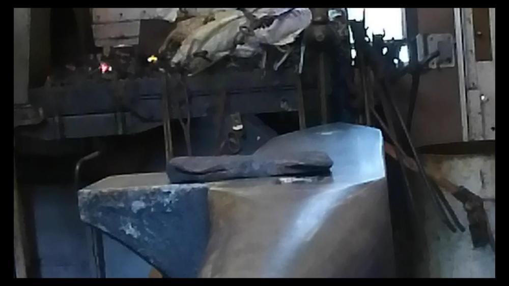

After some more cleanup of the armorer’s swage block with the die grinder, I did a little preforming of some bowl blanks:

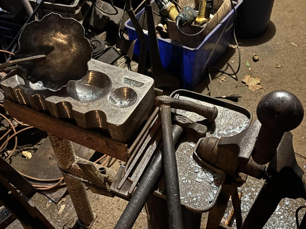

Bowl making with the new swage block setup and a mushroom stake in the vise.
Addendum: After taking these photos, I welded a bit of scrap onto the side of the stake's stem, to keep it from pivoting in the vise. Much improved.

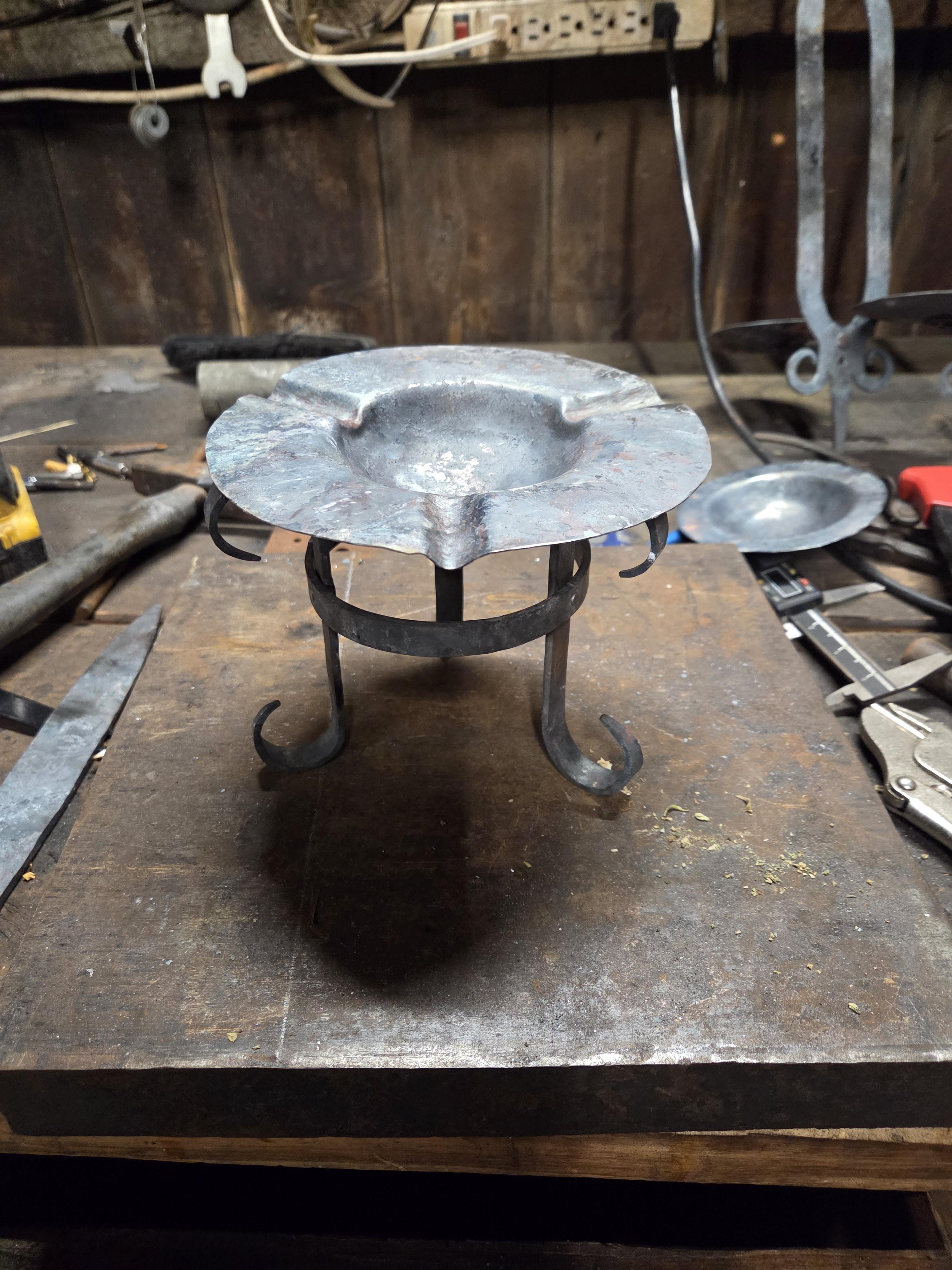

Finished the ashtray i was working on. Also got 5 rings made for trivets i will be giving for Christmas. They will look more or less like the base of the ashtray. A bit shorter mostly. Wrist is still a bit sore so it did take me a bit longer to make the rings, about 45mins each. And they still need the wobbles and bobbles taken out and made round. But 5 for 5 welds so a pretty productive or at least satisfying day in the shop.

That was a pretty darned productive day for a recovering gimp Billy, good on ya. It's normal to have to true up forged rings, hooks etc. It's almost the only thing I use the horn for.

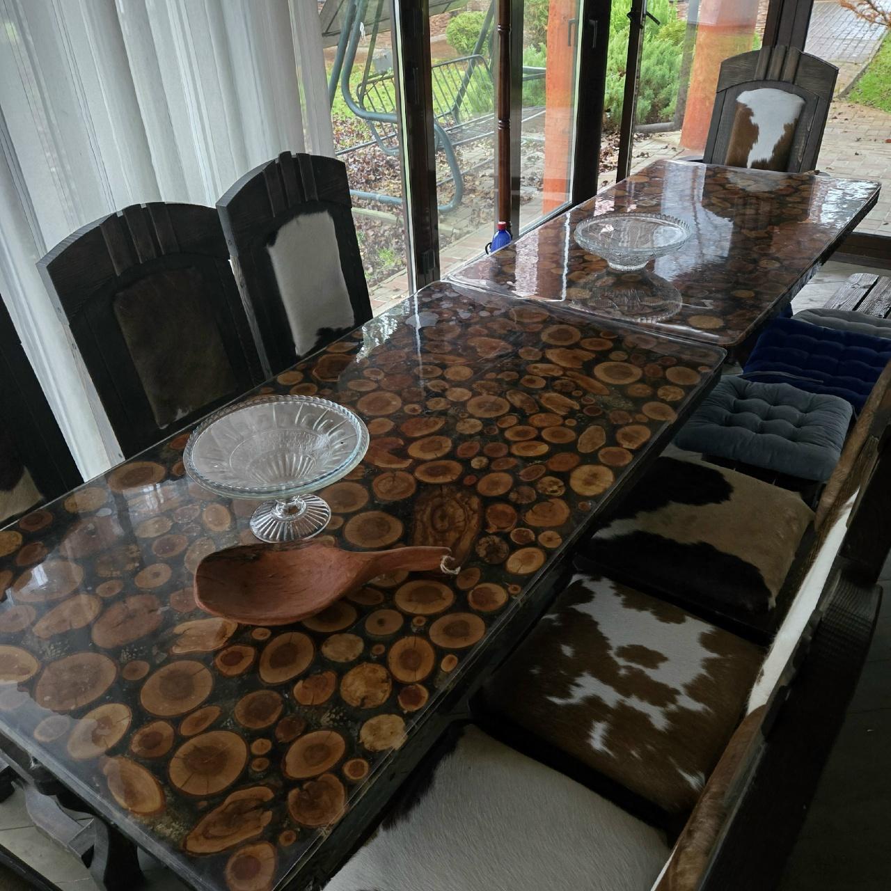

I delivered the table lamp to the location and agreed on a new job. I also took some photos of my previous work. I've been working with this client for about 10 years.

Another successful installation I see Alex, happy customers area treasure.
