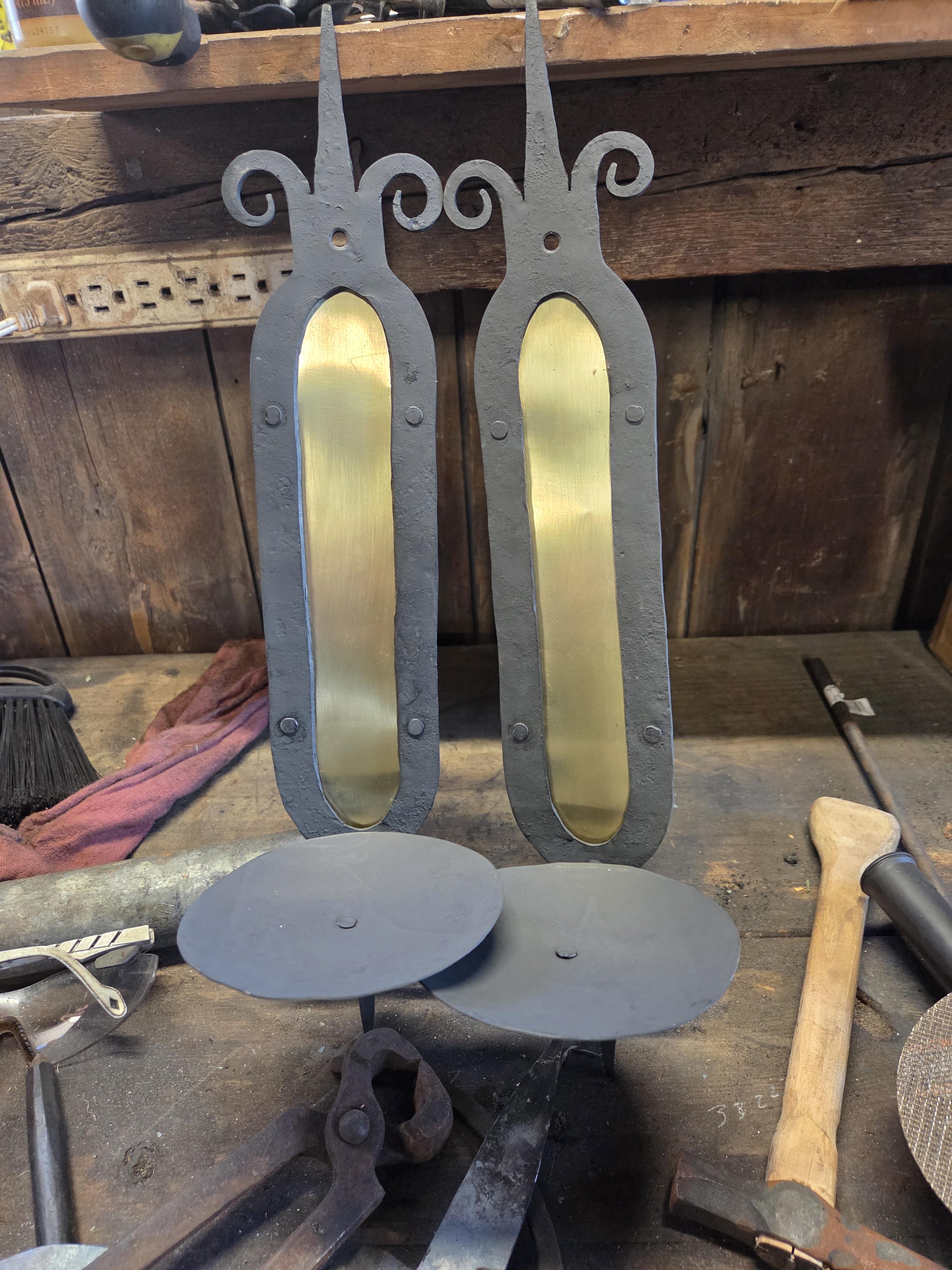

Got my sconces fininished. Finally able to go somewhere and get a piece of brass sheet. This is actually a kick panel for the bottom of a door i found on clearance at the local Ace. Got home, started to cut the sheet and my band saw blade broke. And of course i did not have another on hand. So i finished with the old angle grinder. I did polish it a bit but the sheet is thin and i did not want to be too aggressive. So just a quick sanding with 800 then onto the buffing wheel.
The one on the right i somehow got a little ding in that sticks out like a sore thumb to me.

Nah Billy, that's a beauty mark, every artist puts one in their work as a reward for people who look closely at their work. They came out nice, just enough variances to make them a set. Hand forged shouldn't be identical you know. ;)

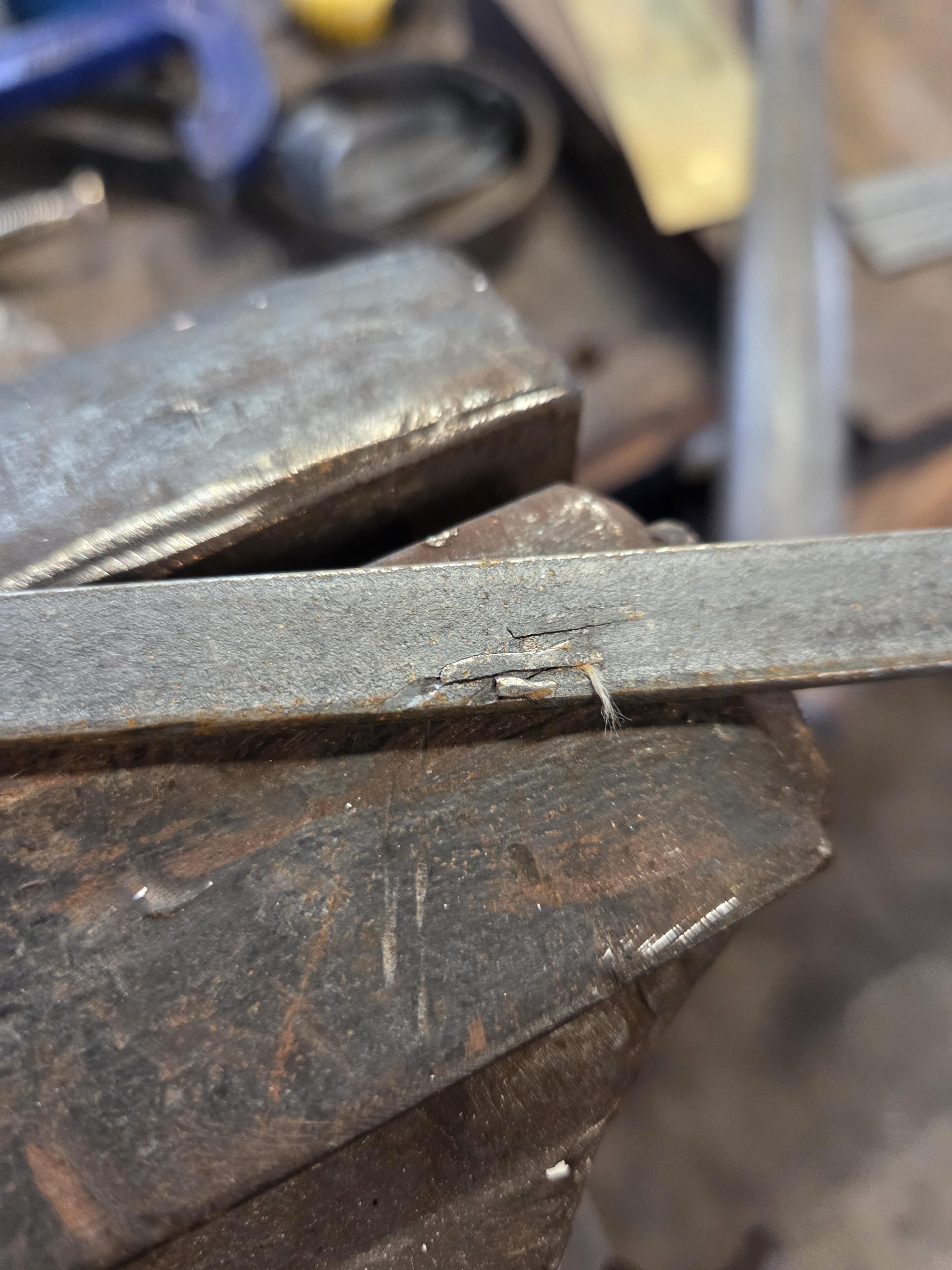

This is why we use gloves or at least a folded up rag when handling stock in the shop i work in. It has been a while but i have seen some pretty nasty cuts requiring many stiches from flaws in stock. This is from some new bars of 1/2 x 1/8 flat i got.
The first flaw is what we called a mill defect and the second is a gouge / shaving. I like roping or other single ply unlined leather gloves when handling stock. A layer of leather will stop all but the worst from flaws like Billy posted.
Billy I ended up with a bunch of bars from china that were completely hideious to work with, burrs, delams, etc, etc,  Your not kidding about wearing gloves..
