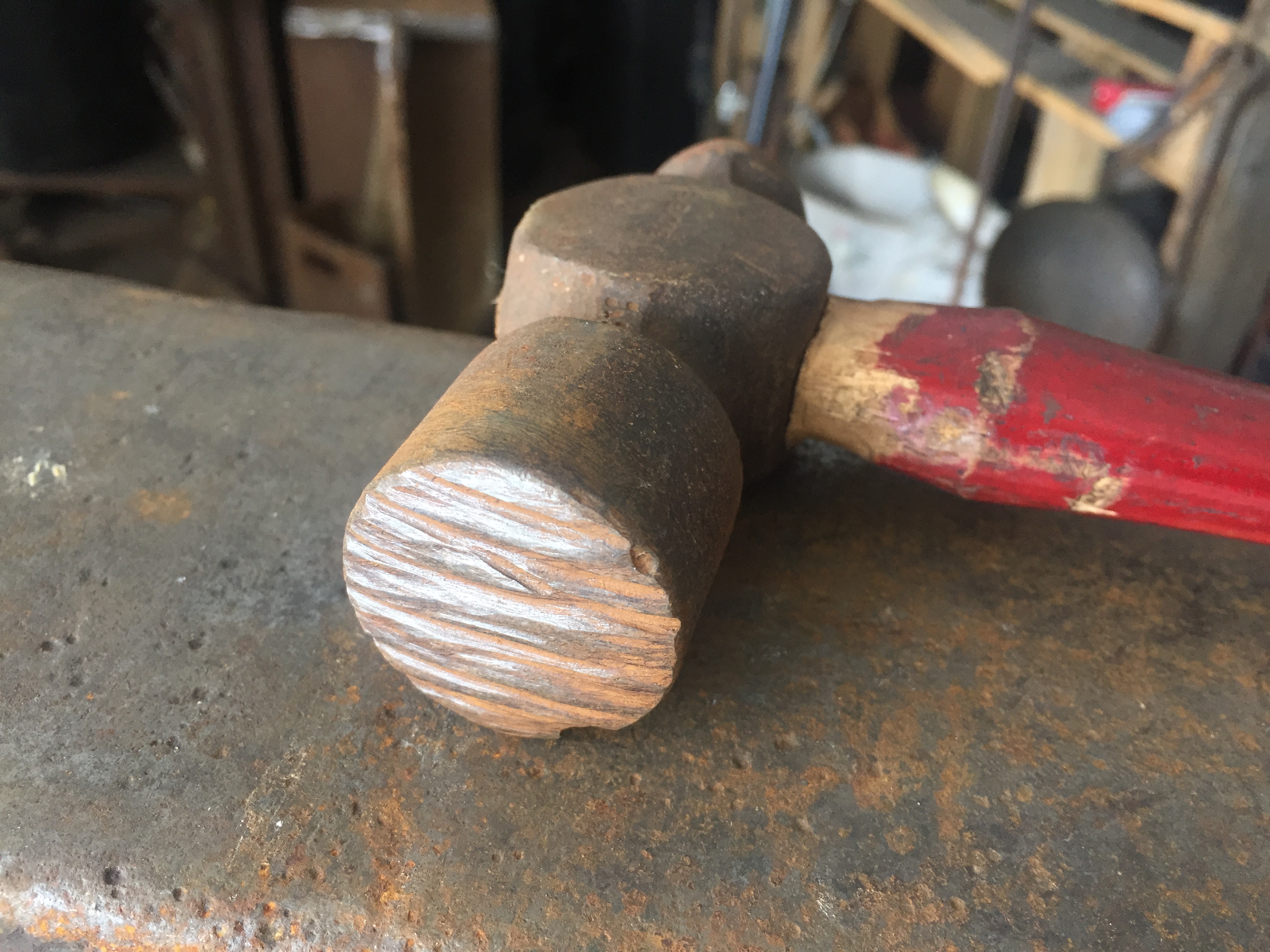

ausfire Posted February 5, 2018 Share Posted February 5, 2018 And doesn't the pulley work well as a base! That cross would have been pretty heavy hammering by hand, Das. Nice texturing. Quote Link to comment Share on other sites More sharing options...
Daswulf Posted February 5, 2018 Share Posted February 5, 2018 Yeah I thought it was a good match. With some of the even heavier hammering I've toyed with it went pretty easily. The texturing was with a junky ball pien that I ground grooves into the face of. Been a while since I used it. ( actually I just recently found it again while cleaning up) I have a bunch sold as soon as I make them. Quote Link to comment Share on other sites More sharing options...
ausfire Posted February 5, 2018 Share Posted February 5, 2018 I'm going out to the scrap to find an old ball pien hammer and I'll make one of those texturing hammers. You always come up with great ideas, Das. Thanks for the inspiration. Quote Link to comment Share on other sites More sharing options...
Daswulf Posted February 5, 2018 Share Posted February 5, 2018 It wasn't my original idea but glad to pass it along. I used the texturing ball pien as a struck tool so you don't want it really hard. You could use it as a hammer too. The lines just come out more even using it as a struck tool. Quote Link to comment Share on other sites More sharing options...

JHCC Posted February 5, 2018 Share Posted February 5, 2018 13 hours ago, ausfire said: I'm going out to the scrap to find an old ball pien hammer and I'll make one of those texturing hammers. Here’s one I made a little while back from a fleamarket ball peen, with a bunch of semi-random grooves carved with a cutoff disc in an angle grinder. I use it as a hammer rather a struck tool. 6 hours ago, loneronin said: yesterday I made this steel striker out of an old, useless file. Very nice, loneronin. The distorted teeth make an appealing snakeskin or fishscale texture, which is very pleasing to the eye. Quote Link to comment Share on other sites More sharing options...

Daswulf Posted February 6, 2018 Share Posted February 6, 2018 Second cross using the new portabandsaw. I got the cut a little crooked but it still turned out somewhat "ok". An experiment on the top with a square punch ( which I like.) Brass brushed and a square nail bail. Just the cross is 8 3/4" tall 5" wide. Made from 3/4" square MS stock. My fine lady helped in holding while I textured it. Aus, my texturing hammer is much like the one JHCC showed. I mostly use it as a struck tool tho. I plan to get many more junk ball piens and other hammers to convert this spring and summer. Most hammer heads I have are too good to " convert" Quote Link to comment Share on other sites More sharing options...

ausfire Posted February 6, 2018 Share Posted February 6, 2018 6 hours ago, Daswulf said: Aus, my texturing hammer is much like the one JHCC showed. I mostly use it as a struck tool tho. I plan to get many more junk ball piens and other hammers to convert this spring and summer. Most hammer heads I have are too good to " convert" I made one today similar to the one JHCC posted. I tested it on a lead sheet and the texturing is pretty much what I wanted. I'll try it on the real deal tomorrow. Also had a hunt around in the scrap some hammers to make a dog head hammer. Found about 30 claw hammers. I reckon four of those would make the most awesome nippers for a giant scorpion. They would also weld together nicely to make an interesting coffee table top. I might even put a handle on one and make a hammer. Quote Link to comment Share on other sites More sharing options...
