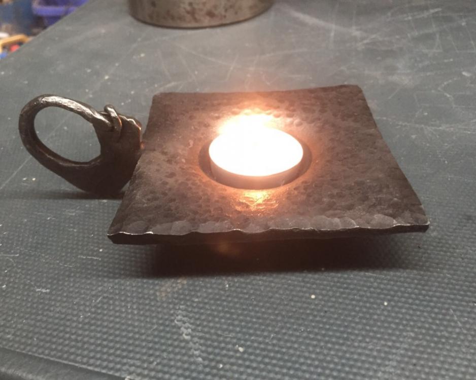

Tried out a tea light holder with parts I'm willing to send to a friend so i don't waste his time. 1/4" plate stock. Tried several ideas with the handle but this is what I ended up with.
Das, nice candle holders. The handle is not welded on?? Forged from one piece?

I have made a few . They make great presents . No welds I chunk of 12g.  No need for 1/4 stock.
You's gots a plasma... . ;)   Nice work..

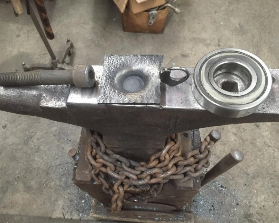

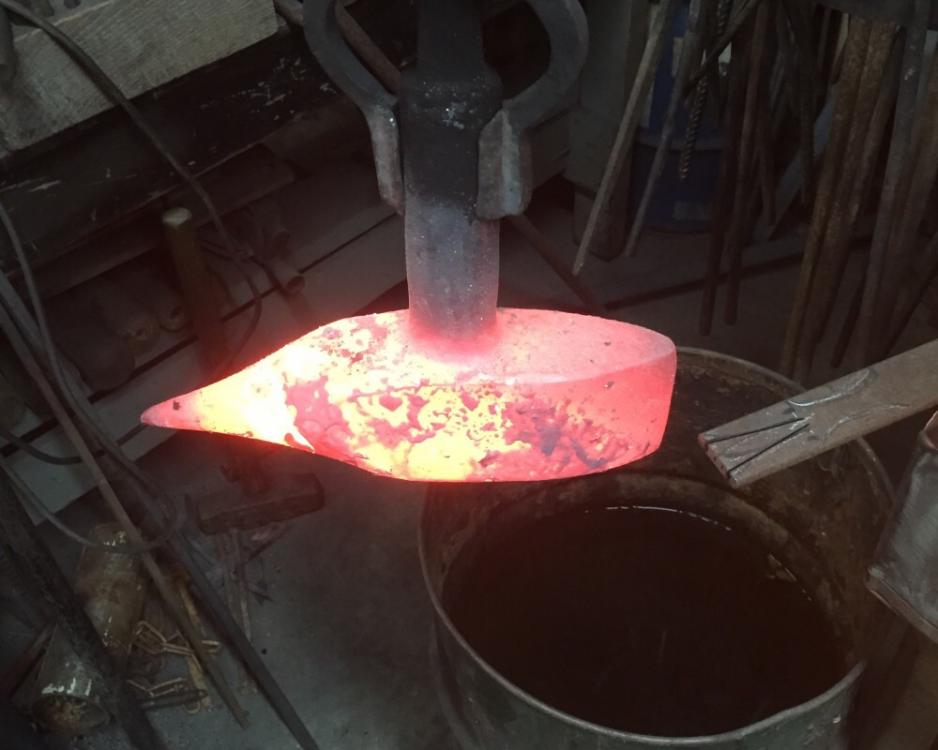

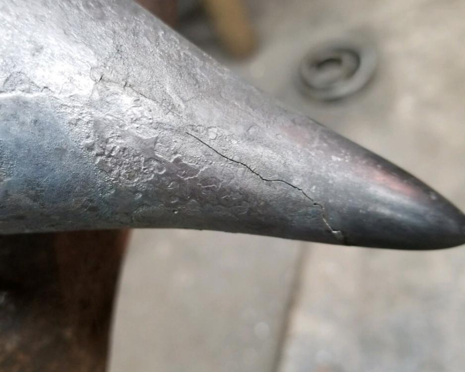

Well I botched the heat treat on the post anvil. Hammer head unknown, post 4140, and horn was torsion bar welded on. From the looks it cracked 2/3 into the torsion bar horn. The rest leaves minor divots with a ball pien and file barely bites in. Never heard or felt the crack and I did go more aggressively with the water quench then I had originally planned. Live and learn. Think I could have gone about that way better!
I'm going to try to regrind in a horn where it broke off for a shorter one.
Happy fun times with mystery metal. And mixed metal guesstimate quench. I think Thomas's idea of a block anvil is more wise ;) I'll salvage this mess.
After mounting in the stump and running over it with a da sander with 150 grit I played with a ball bearing on it. The hammer head part is anywhere from 60% down to about 40%. The center 4140 part is close to around 90% and there is just no testing the horn area now.
I will still salvage this as much as I can. I'm thinking I was a bit off on the hammer head spark test. And I was deffinately stupid with the quench.
