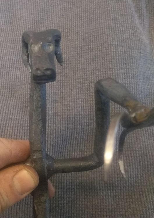

Well, I've decided to make a new years resolution to make 100 animal heads this year. Mostly to give me practice forge welding, but the sculpting practice it gives me won't hurt. Here is 1 and 2 for this year (4 and 5 of my total animal head count)539083885_IMG_20200117_1417082332.thumb.jpg.4fd336456d115ed5bad3249c74d177c2.jpg1710877432_IMG_20200117_1417179412.thumb.jpg.380b252765d858662baae545c6cf41e8.jpg

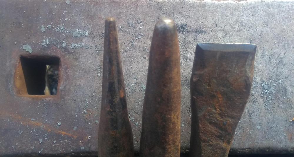

As requested, here are the 3 punches I used for the first 2 heads386795194_IMG_20200118_1205311682.thumb.jpg.615d2a3ab15e61a0ce33ed5c156b335e.jpg
The chisel is just over an inch wide, not sure of diameter of the punches. I'm guessing 1/16 inch and 1/4 inch.

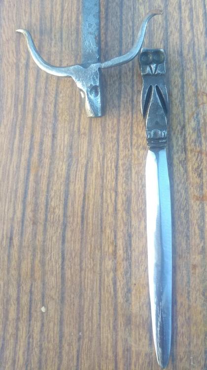

Here's numbers 3 and 4. An owl letter opener and a longhorn. Same punches as before. Both from 1/2 inch square bar.339763849_IMG_20200122_1550185712.thumb.jpg.25f5005ef8863465acd8013dfb02ee0d.jpg

Thanks everyone. The owl started as a Brian Brazeal 3d horse head, but I messed up and made the cheek way too long and I used the wrong edge for some of the half face blows, so I just winged it. The lips of the horse became the brow of the owl, and the cheek became the body.

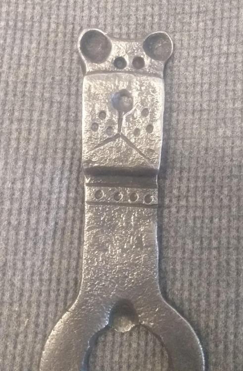

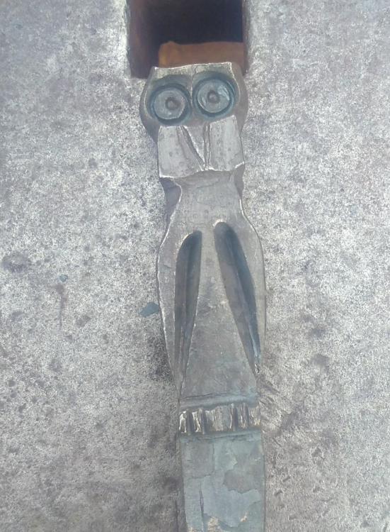

#5 is another owl, tried it with a new eye punch I found at a yard sale with a center punched pupil. The eye punch just so happens to be the same size as my large round punch, so I set in the socket with the round, then the eye punch to define. Also tried defining the neck more, though I think it looks too stretched out for my tastes. I prefer the shallower cut for the wings on the first one too. Somtimes simpler is gooder.1730960922_IMG_20200125_1329060822.thumb.jpg.9705d2a503777c5c03c8843d21c1f739.jpg

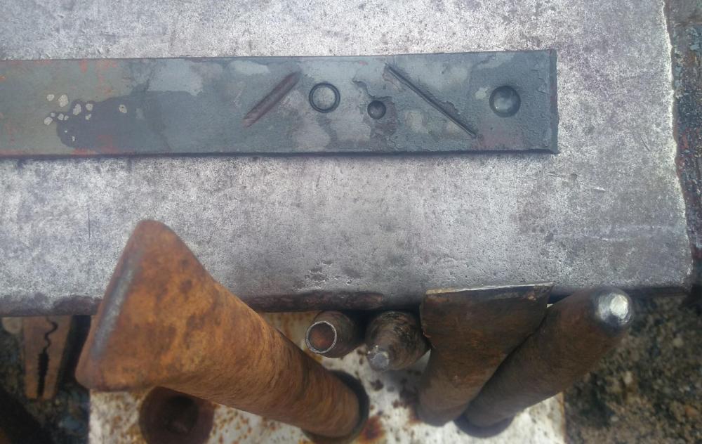

And as requested, here is each chisel I have next to it's mark. Haven't used the rock chisel? yet, but I want to use it as is before I decide to alter it.
Thank you for the stamp display.  Loving this thread!
Your welcome, and thanks for the support.
