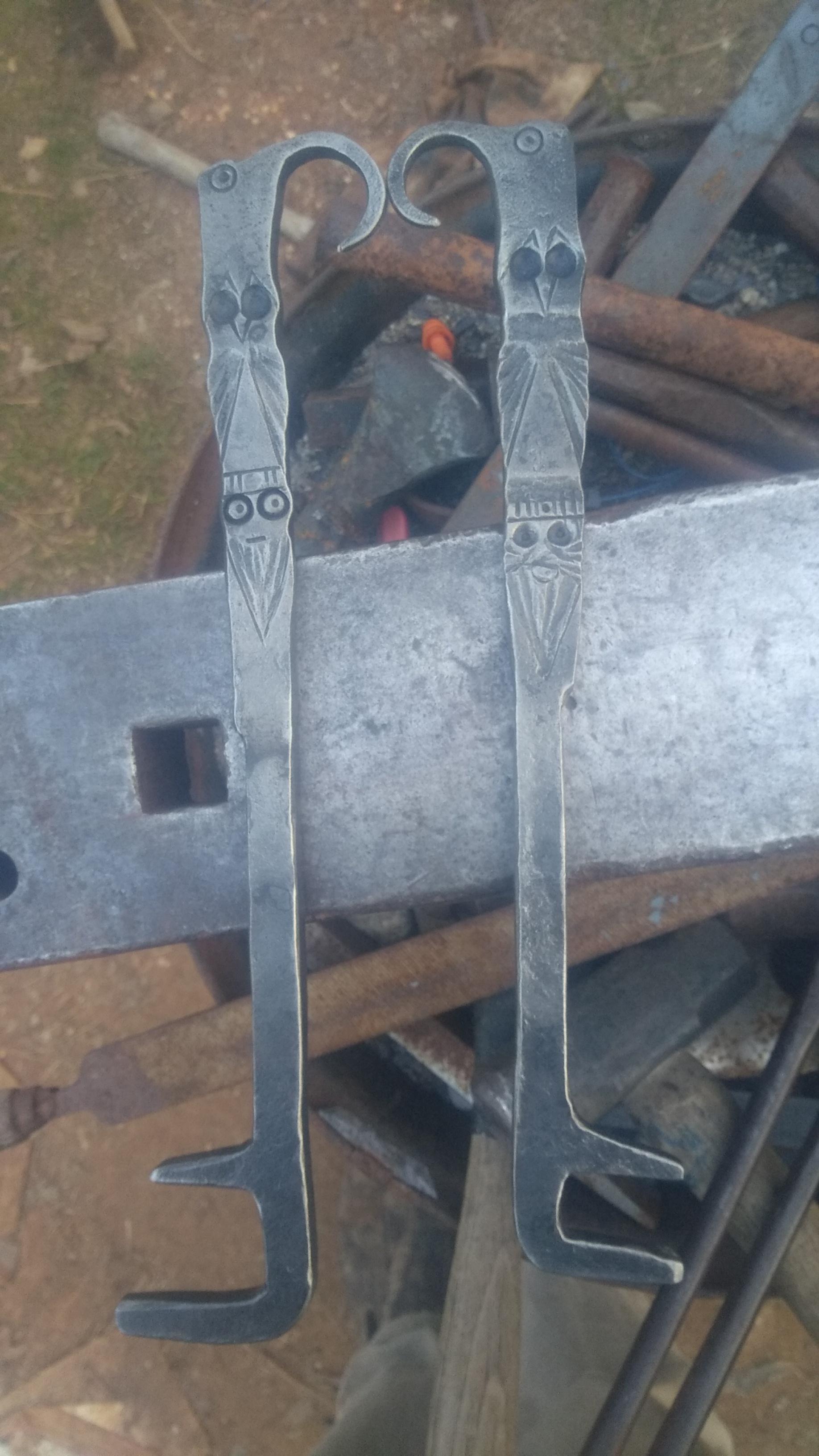

Shabumi Posted February 21, 2020 Author Share Posted February 21, 2020 #6-#11 are freehand embeleshments on the handles of my scrolling forks. Got to try out the new rock chisel fuller from above for the wings and wizards beards. Im liking it's marks so I don't think I will change the head, yet. I do need to shorten the handle on the fuller though, I was striking the tool around bicep height. Much too high. Also need to figure out a better way to do mustaches, it didn't come out as well as I thought it would Quote Link to comment Share on other sites More sharing options...
BillyBones Posted February 21, 2020 Share Posted February 21, 2020 I think the one on the right, your wizard looks like something from the "Fabulous Furry Freak Brothers." Both are most totem pole looking, quite cool. Quote Link to comment Share on other sites More sharing options...

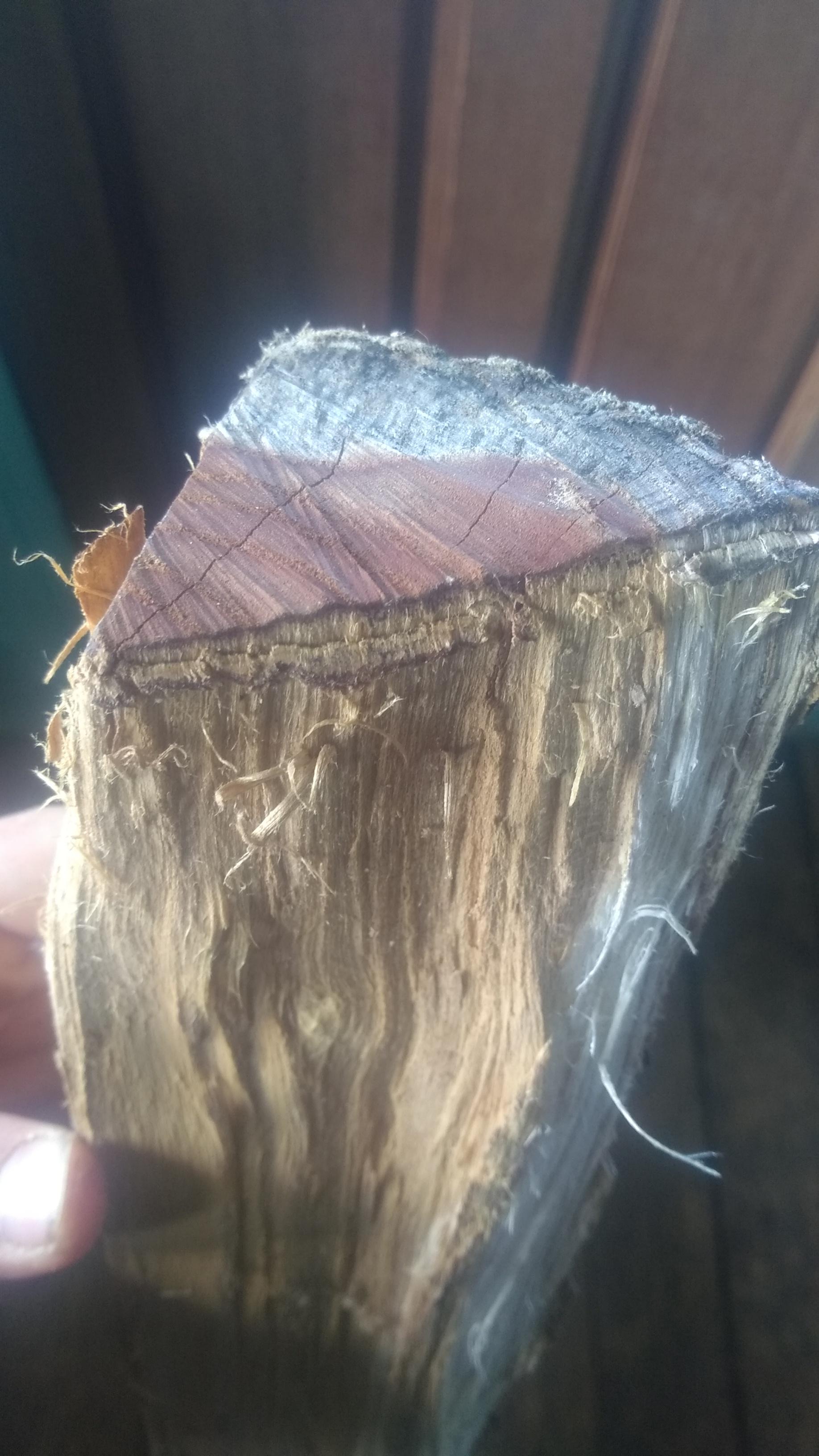

Shabumi Posted March 2, 2020 Author Share Posted March 2, 2020 Now that you mention it, Locust would make good handles. I have a few nice pieces in the firewood pile a can pull aside to try. I wonder if the yellow color in the middle of the pieces will stay after it's worked into a handle. Quote Link to comment Share on other sites More sharing options...
ThomasPowers Posted March 2, 2020 Share Posted March 2, 2020 UV usually turns it brown. I have a small ballpeen hammer I made a handle for from Osage Orange---BRIGHT YELLOW when installed, now a dark orange brown after years of UV, oxidation and use. Quote Link to comment Share on other sites More sharing options...
Shabumi Posted March 2, 2020 Author Share Posted March 2, 2020 I guess I could have looked at the wood to answer my question. Here's a piece I was talking about. Yellow inside on the "fresh" cut, but a nice chocolate brown color on the end exposed to the elements. Quote Link to comment Share on other sites More sharing options...
