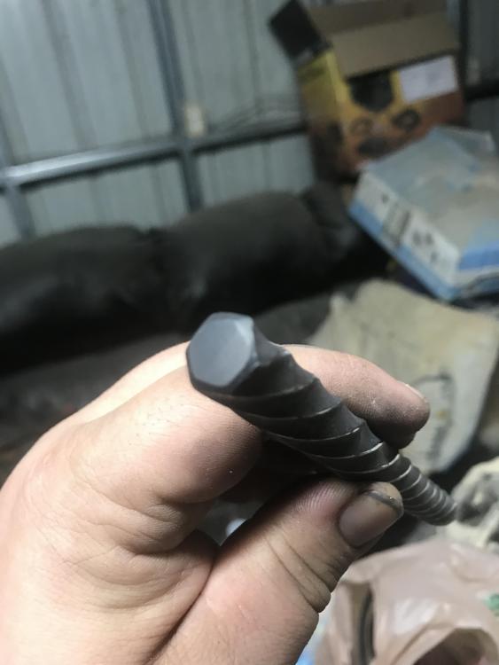

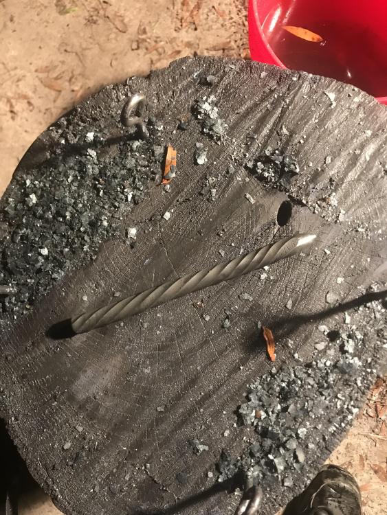

Eventlessbox Posted December 18, 2019 Share Posted December 18, 2019 First centerpunch. Made from a large Allen key I picked up a while back. Quote Link to comment Share on other sites More sharing options...
anvil Posted December 18, 2019 Share Posted December 18, 2019 The hammer end needs to be domed. Is this for hot work or cold? For my preferences it's too long for cold work and too short for hot work. I do like your twist! It's pretty even and a nice touch. Quote Link to comment Share on other sites More sharing options...
Randy Griffin Posted December 18, 2019 Share Posted December 18, 2019 Anvil, just for my information, why would you dome the hammer end? I would have thought flat would have more contact with the hammer and transfer more energy to the tip. There i go thinking again. Quote Link to comment Share on other sites More sharing options...
ThomasPowers Posted December 18, 2019 Share Posted December 18, 2019 Dome: less mushrooming in use. Can you tell us the heat treat you used on it? Quote Link to comment Share on other sites More sharing options...
Eventlessbox Posted December 18, 2019 Author Share Posted December 18, 2019 I’ve always done a camphered(sp?) edge heat treated the first inch to non metallic. Quenched in oil. Quick hit with a belt to clear scale. Then slow heated the shank in the dragons breath of the forge till the temper line got to right where the spiral ends and then stopped the heat spread. Buffed on a belt for apperiance Quote Link to comment Share on other sites More sharing options...
ThomasPowers Posted December 18, 2019 Share Posted December 18, 2019 Differential hardening, differential tempering: Good. What colour did the point end up? It probably needs some tempering unless it will be used on hot metal which will do it in use. Quote Link to comment Share on other sites More sharing options...
JHCC Posted December 18, 2019 Share Posted December 18, 2019 1 hour ago, Eventlessbox said: I’ve always done a camphered(sp?) edge Chamfered. 1 hour ago, Eventlessbox said: heat treated the first inch to non metallic. Non-magnetic? Quote Link to comment Share on other sites More sharing options...
Eventlessbox Posted December 18, 2019 Author Share Posted December 18, 2019 Lol. Yes. I need to proof read better. Very much non magnetic. If I could make it nonmetallic I’d win a Nobel prize prolly. Lol. The tip picked up a light straw. Quote Link to comment Share on other sites More sharing options...
ThomasPowers Posted December 18, 2019 Share Posted December 18, 2019 Actually, no. I've seen a number of beginning smiths leave stuff in the forge so long that it scales away to non-metallic. You can also burn it to that state. Perhaps an Ignoble Piece Prize? Quote Link to comment Share on other sites More sharing options...
anvil Posted December 20, 2019 Share Posted December 20, 2019 On 12/18/2019 at 7:48 AM, Randy Griffin said: why would you dome the hammer end What Thomas said. I will add one more critical reason. With a domed head your hammer head is more likely to strike point on point. With a flat struck surface, your flat faced hammer has a greater chance of striking on a diagonal. This will cause your tool to go flying. Quote Link to comment Share on other sites More sharing options...
