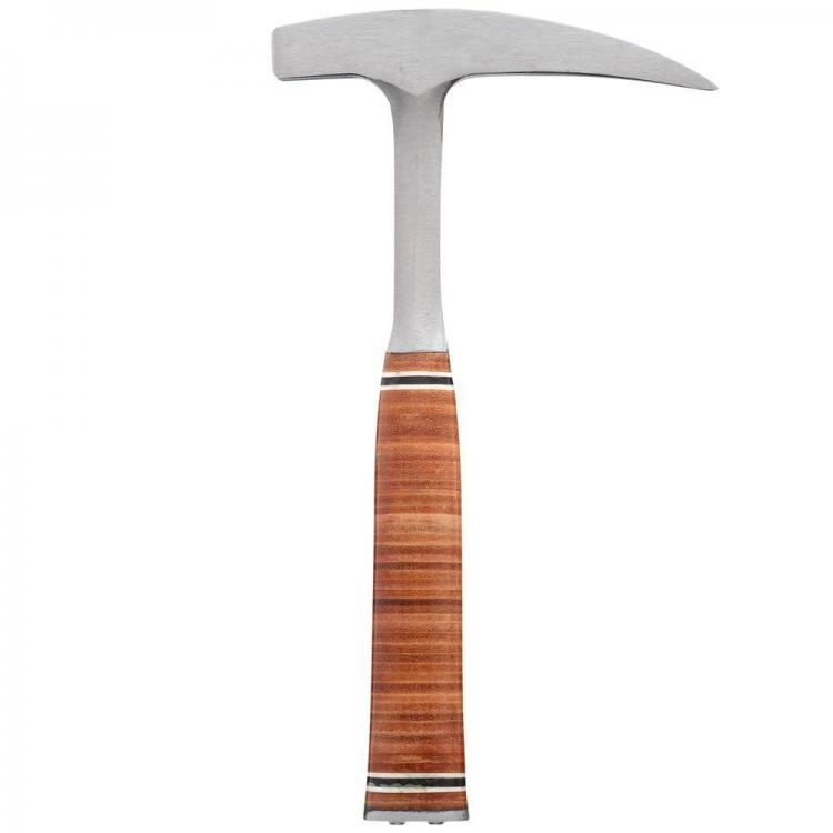

       I am a geologist and an amateur blacksmith. I got into blacksmithing so I can make my own field tools and tailor the tool to the exact job I need it for. I have been doing a bit of reading and it seems like S5 or S7 would be the best steel to make rock hammers and chisels out of. I was wondering if anyone has any advice on other steels that would work for this application? Another aspect of making rock hammers versus "normal" hammers is that the handle and the head is all one piece of steel. The head has a side for striking and breaking the rock and the other end is more of a pick. I attached a picture of a general rock hammer. Any advice would be awesome! Thanks in advanced.
The hammer depicted is manufactured by Estwing.

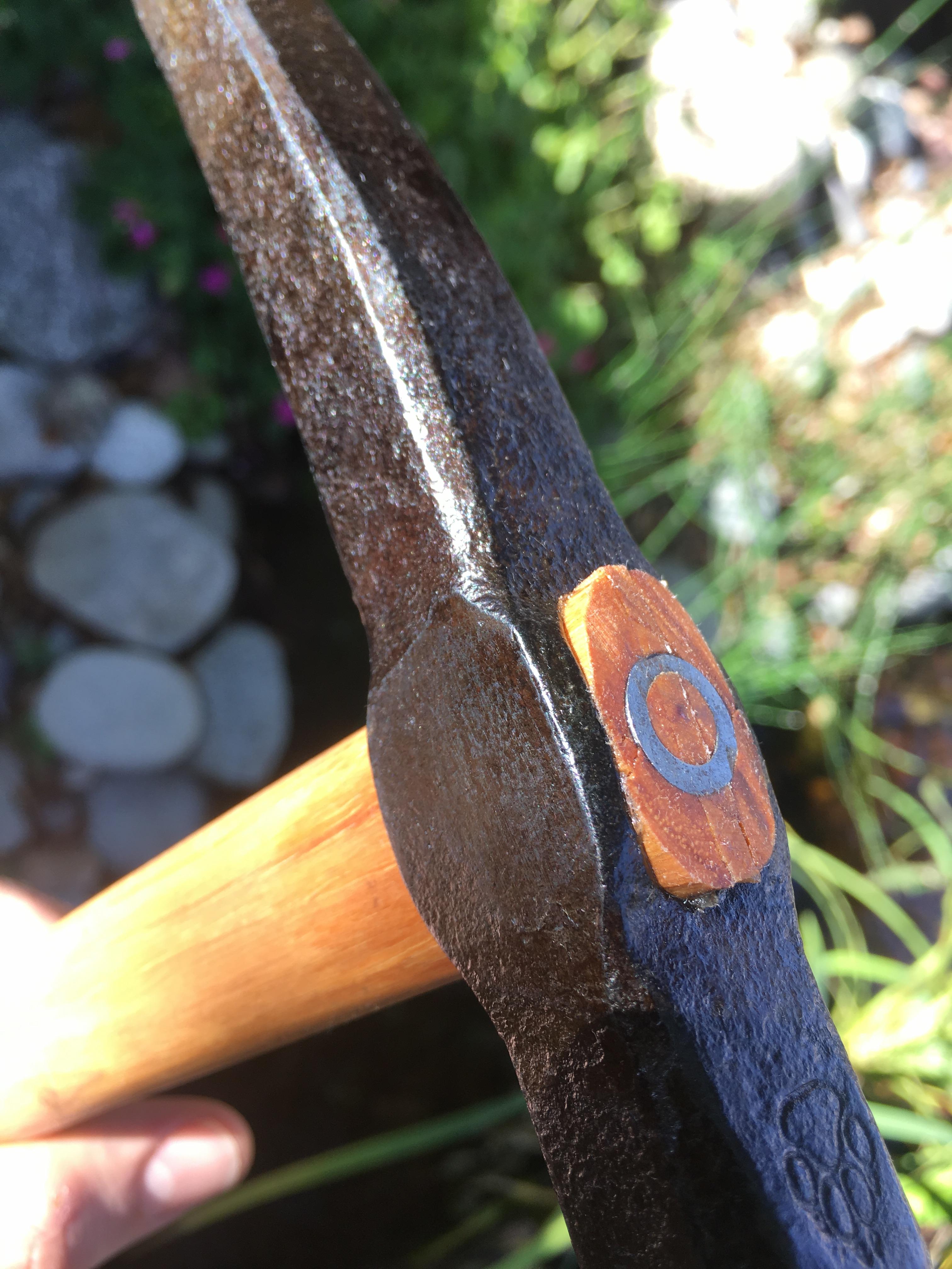

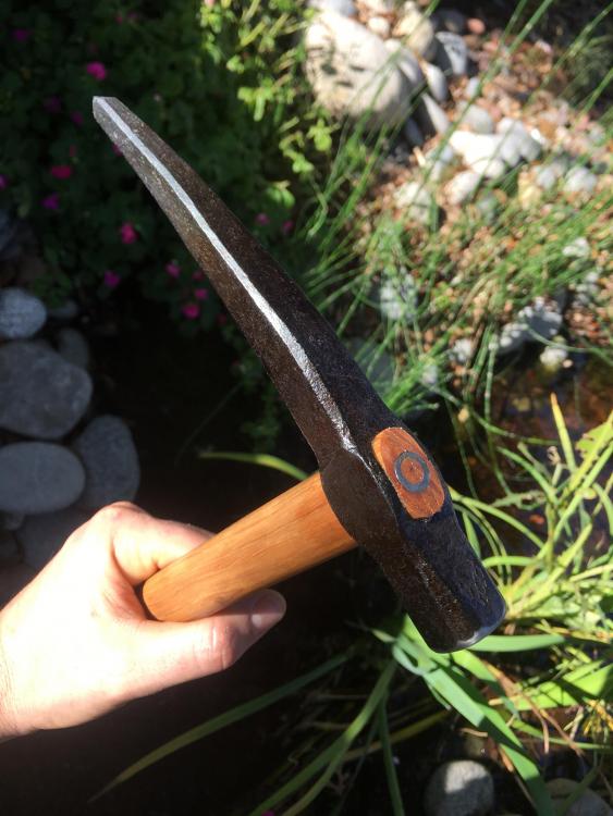

Here’s one I forged with a striker.  The metal is sucker rod.
It was given to another friend who has done lots of gem prospecting and he is happy with it.

My concern with one piece hammers like the Estwing is the stress is transferred to your hand & arm through the handle.
Estwing started making the one piece hammers with a rubber-type, shock absorbing handle which helped dramatically over the leather type. My hammer from about 1963 is the "rubber" type and still great shape.
As a hand forged project, this is a  very complex forging. A one piece hammer/handle combo is better done with an industrial setup.
Heat treating will also be rather complex. You will need to ht both ends as well as the transition  from hammer to handle.
Not that it can't be done in a one man shop. Keep us informed.
