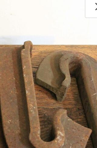

 pandrol clips are shaped like an s. They are easy to identify.    I just looked up pandrol clips and they are different than what a railroad worker showed me  just a couple weeks ago. I guess he was telling me bad info or this is another difference between u.s. and u.k. terminology. I'm going to post a pic of what he showed me as soon as I can find it.
They were close to this just s shaped.
Glenn ,  the pic you posted is the one I found when I looked it up. The clips I posted are what I was shown by a R R maintenance crew who were staying at the hotel where I work. When I asked about pandrol clips that is what he showed me. Guess you gotta watch who you listen to.    Sorry for the confusion.
Pnut (Mike)
I also think I seen one lying on top of the other and thought it was s shaped. Oops.
Mike, those are track anchors (this specific version is called a FAIR anchor). They clip on the underside of the track, dig into the ballast (gravel), and keep the track from shifting lengthwise.
Thanks for the info. I looked em up. I don't know why the guy told me they were pandrol clips. He was friendly enough. I started taking to him to see if he had any old stock on his truck. He didn't have anything old  but he gave me a couple new spikes.  They were leaving one morning when I was heading in to start work. They had one of those trucks with the hydraulic wheels for the tracks so I kinda lingered a bit hoping to score some scrap. .
 I wish I would have looked it up BEFORE I posted but I didn't see any reason to since the guy works for the RR.
Oh well lesson learned.
Thanks for letting me know. And sorry for the confusion
