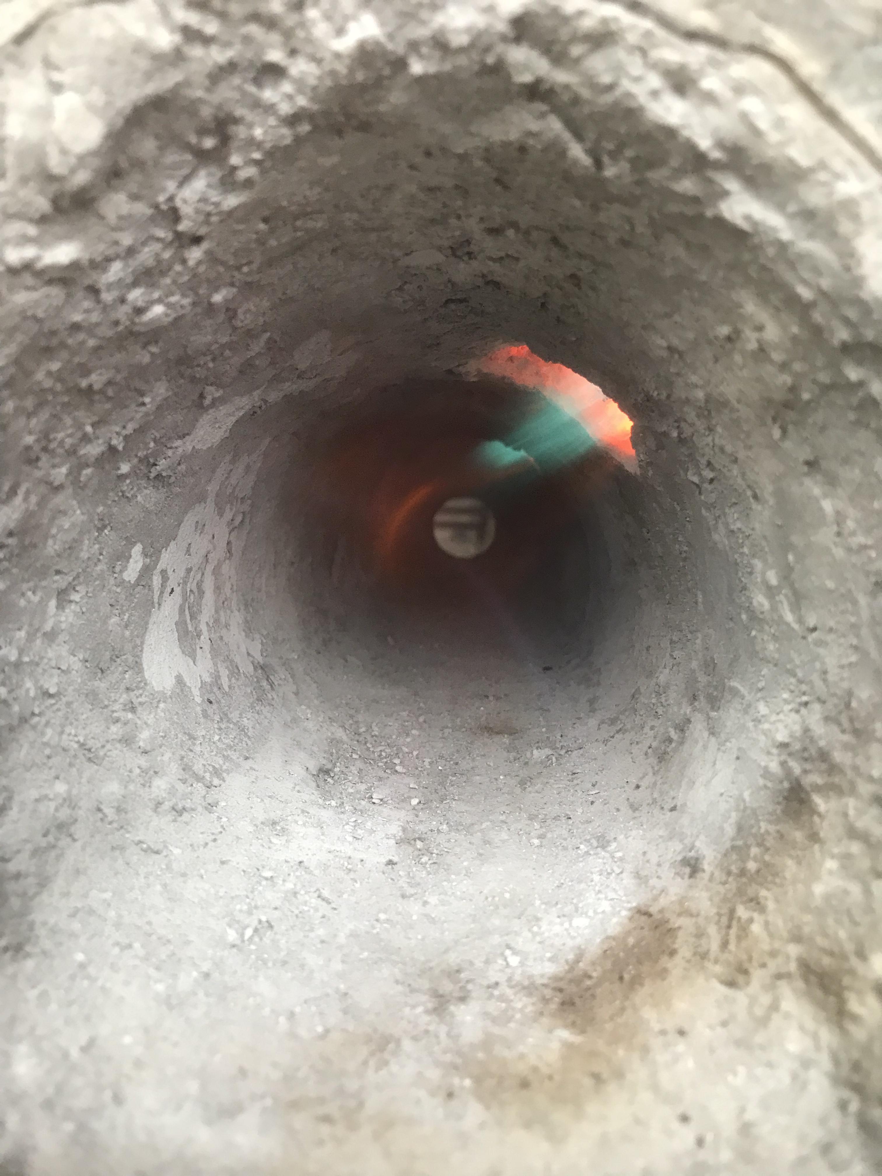

  19. Well, I drug it back out and cut down the mixing tubes to 6 inches, got the jets aimed perfect, but it was just bothering on how little space I was left. As I'm taking pictures to share with the class of how much I managed to get my dragons breath down, plus the much nicer shade of blue it was, I took a pic of the jet while it was running. The first pic here is that picture... Um, that red on my weld ain't supposed to be there... So I go back to the front, still bugging myself about the room inside... Here's that pic... Something ain't right... now it makes sense. Where I thought I had only added a half inch of the castable refractory, I added over an inch... And it shifted while setting, making the flame kiss the refrac before it even got into the chamber, heating up everything wrong. The flame was firing off an inch OUTSIDE the forge. so I tore it out. Question, can I reuse the kaowool that's inside here, I've got enough tucked away that I never used to wrap a smooth layer around everything you see here, but I'm not sure if it's ok to reuse this bit?
  20. Fantastic. The mig tip is slightly off center, not as much as it appears in the pic, but it was. The jet tubes aren't set in stone, so to speak, do I can play with that easily, and I'm currently searching for a way to actually make it set in stone, so to speak. I'm thinking of using JB weld to get them to stay where I set them, seeing as the set screw idea is ok at best in theory in my experience. I'm going to cut the mixing tube two inches also, hopefully these will cure the problem. If I need to, then I'll just chip the floor up, cut the keg opening on the bottom a couple of inches lower, and then just put the castable refractory over the ceramic wool itself and not buffer the two with the brick as I did here. This picture I'm including is how everything looked before I used the HyMor. I only used maybe a half an inch in thickness of the HyMor, however I just didn't think that it would eat up as much of a space as it did. I'm only running the forge in the garage for testing, with fans on, door open, fire extinguisher within arms reach, and for maybe 2-3 minutes. I agree whole heartedly that it shouldn't be run in there at all, and for actual forging use, it will be in the backyard, where half the yard is concrete slab, next to the metal gazebo. No excuses for safety however, I shouldn't run it in there at all and knew better. Complacency kills. I'll update this soon and let y'all know how its running. Appreciate you guys, and this site, so incredibly much.
