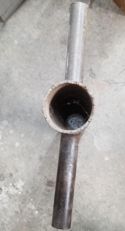

Angiolino: The easy way if you don't insist on using a square post on the gate is to set a round post in the ground with a flat cap welded to the top end. Use a drill bit to make a very shallow divot in the center of the cap as a bearing race. This is to retain a bearing ball.
The post on the gate itself needs to be round and large enough to slip over the post set in the ground. It also needs a welded flat cap with a bearing race on the inside. Place a ball bearing in the "bearing race, a gob of grease to keep it in position is a good idea.
The gate will swing easily on the bearing ball and being a close fit over the post won't rattle or wobble.
You can make  any size or shape gate you wish and won't need any power in the field to install, just a couple people to help lift it. You DO want the gate heavy enough folks aren't going to lift it off to trespass.
If you want to, you can cut a slot around the bottom of the gate's hinge post(?) a bolt can pass through. Install the gate and put a bolt in the permanent post. This hole needs to be drilled and tapped of course, if you don't want anyone to remove the lock bolt saw the head off the bolt so they can't put a wrench on it. The slot in the hinge post can also limit how far the gate can open so you want to use a pretty large bolt to prevent it shearing off.

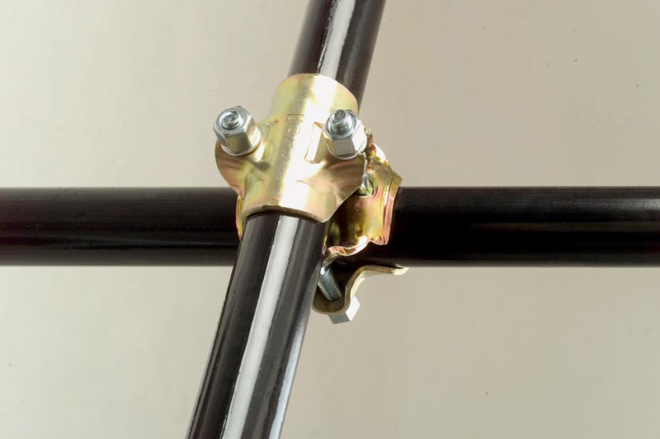

thanks for the right suggestions, I should create a hinged hinge and a right jumper, a friend of mine suggested me to use metal pipes for metallic carpentry like those used to make temporary scaffolding on construction sites that you think? thanks again for the right suggestions
