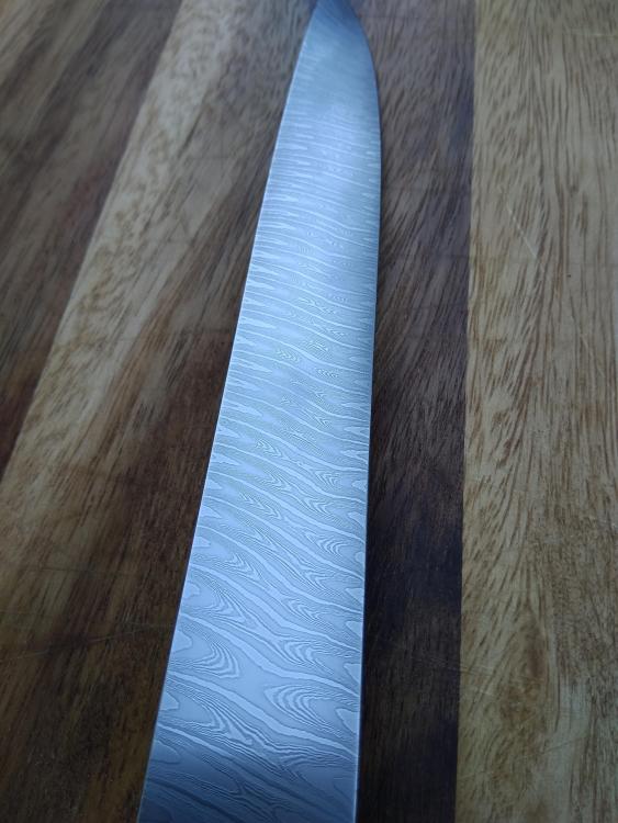

Foundryman Posted September 30, 2018 Posted September 30, 2018 My brother asked me to make a knife for him to cut the cake for his wedding. Both he and his wife to be wanted to be involved in the making of the knife so they came over and struck for me when I was drawing out the Damascus billet. The knife is 15 inches long and made up from 13 layers of 15n20, 1095 and 20C (two of the inner layers are made of up of 15 layers each) twisted tightly and forged to shape with an integral bolster. The handle is African blackwood and stainless steel pins. I deliberately left the knife blunt to avoid any accidents on the big day however it's still more than sharp enough to cut cake. This is my first time doing an integral bolster, it's also the longest, thinnest knife I've made so far. Quote

Lou L Posted October 3, 2018 Posted October 3, 2018 Beautiful fit on the bolster/handle transition. Gorgeous knife all around. What a nice sentiment too. Quote
Foundryman Posted October 3, 2018 Author Posted October 3, 2018 Thanks, it's the first time I've made a knife with any kind of bolster, it took lots of careful filing! Quote

templehound Posted October 5, 2018 Posted October 5, 2018 Most impressive cake knife I have seen.... the damascus is simply stunning! Quote

Foundryman Posted October 8, 2018 Author Posted October 8, 2018 Thank you for the kind comments. The wedding went off without a hitch and the knife was very well received. It has now been sharpened ready for a lifetime of service as a carving knife. Quote
