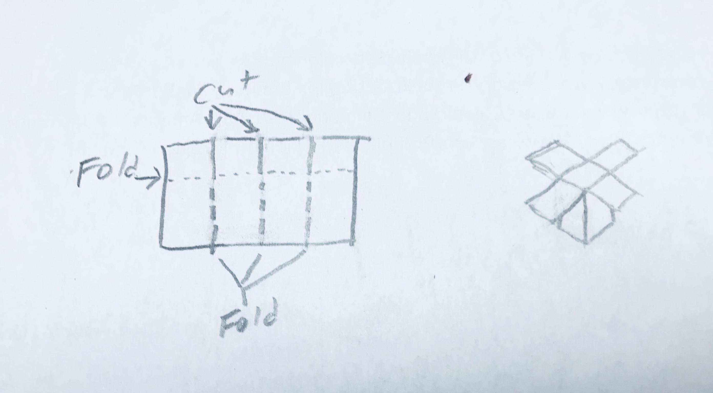

foundryguy Posted October 15, 2018 Author Share Posted October 15, 2018 On 10/12/2018 at 8:18 AM, Cincinnatus said: I like them both - looks good. Any thoughts on a 1 1/4" shank on the cone? The shank is only going to be offered in 1 inch, at least for now Quote Link to comment Share on other sites More sharing options...
JHCC Posted October 15, 2018 Share Posted October 15, 2018 You can always make an adapter out of 1/8" sheet. Quote Link to comment Share on other sites More sharing options...
Cincinnatus Posted October 15, 2018 Share Posted October 15, 2018 Thanks - trying to think of the best way to do that. Quote Link to comment Share on other sites More sharing options...
JHCC Posted October 15, 2018 Share Posted October 15, 2018 Get a piece of 1/8” sheet. Cut and bend as shown. Quote Link to comment Share on other sites More sharing options...
Cincinnatus Posted October 15, 2018 Share Posted October 15, 2018 Thanks for the tip. Much appreciated. Quote Link to comment Share on other sites More sharing options...
