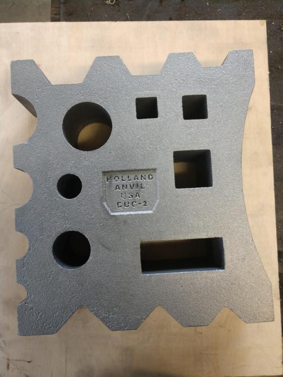

My son drew this pattern up and cut the tool last week. Pretty happy with what he came up with. These are ductile iron and 50 lbs. We are thinking about pouring a few out of H13 tool steel and hardening them up like the anvils. A big block with round and square holes is in the works. Cheers

That is a really nice clean casting, big enough to do some real work, small enough to move around for hobby smiths or guys that need to travel with it for demos.
thanks again for taking on these projects and offering ‘smiths another source of quality, American made tools.

Nice casting. I'm not sure about the 90* swages, maybe for doing canister damascus welds? I use one angle of a hex swage 120* to profile slitters more often than I need a 90. I'd vote for the side of or at east one of the more acute V swages for setting anvil devils, hardies, etc. and one 120* swage to profile Brian Brazeal slitters.
I don't think a H-13 swage block is worth the material $ difference, they just don't get the kind of hammering an anvil gets. Mine is ductile iron and been around a least 65 years and it was a journeyman project for a Railroad foundry man back in the Alaska Road Commission days rather coming out of a foundry that makes such things. The Railroad gave the blocks to the Road Commission highway maint. shops and mine was going to the scrapper if I didn't take it.

We had several people request this design and weight. Affordability was our main goal, simple and quick you might say. Thanks for the support.
Frosty I like your idea.
Replace the one edge with the French curl cut out with another angle of “V” , having all three angles AND the semi-circles that are there would be useful.
Agree ductile iron is plenty good.
You are welcome sir!
What is the thickness on this block?
actually, we may modify that side and put several half hexes. The block is 3 inches thick. My son is drawing up a big block this week. On the H13, several folks have made requests for it so it might be a luxury item we could make for a couple folks that want it.

Gorgeous casting, and I love how you got it so clean.  Everyone I've see from other suppliers has a parting line right down the middle of the block that needs grinding away.  No idea how you pulled it off, but it's impressive!  It's on my list.

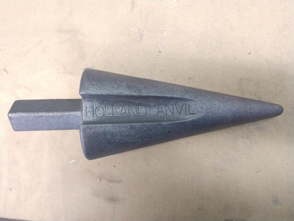

Are you going to start offering cones as well?  Might as well go for the Trifecta, right?
