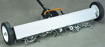

Marc1 Posted April 7, 2018 Share Posted April 7, 2018 On 4/6/2018 at 8:45 AM, Meridianfrost said: I was wondering what you all use as transition from your shop to your house to make sure the metal stays away from the living area. Josh, I use a magnetic 'broom' consistently every time I finish for fear of the little one getting something in their feet. Not sure what you call it but mine is just a big long magnet attached to a long handle a bit like a rake. Some have wheels to keep it above the floor, others like mine has no wheels and I take it back and forth picking up everything in it's path. You can hear it getting all the little bits, and best of all even the filings from the grinder. It's amazing how much metal you can pick up after just one day of work. As for walking in and out of the house, I leave the working boots at the door. Quote Link to comment Share on other sites More sharing options...
Smoggy Posted April 7, 2018 Share Posted April 7, 2018 Change area and work clothes are the key, but shop cleanlyness also helps. For magnetic brooms wands or plates, just make them out of steel, your choice of section, and place a strong magnet on it away from the working end. Once you have completed your sweep hold it over a swarf bin and pull the magnet of, a quick tap and it will all unload. I use this method to clean my lathe bed and seperate steel and brass swarf I've vacuumed out of those presky little inaccessible crevices. (I use the brass chips for heat treatments.) Quote Link to comment Share on other sites More sharing options...
