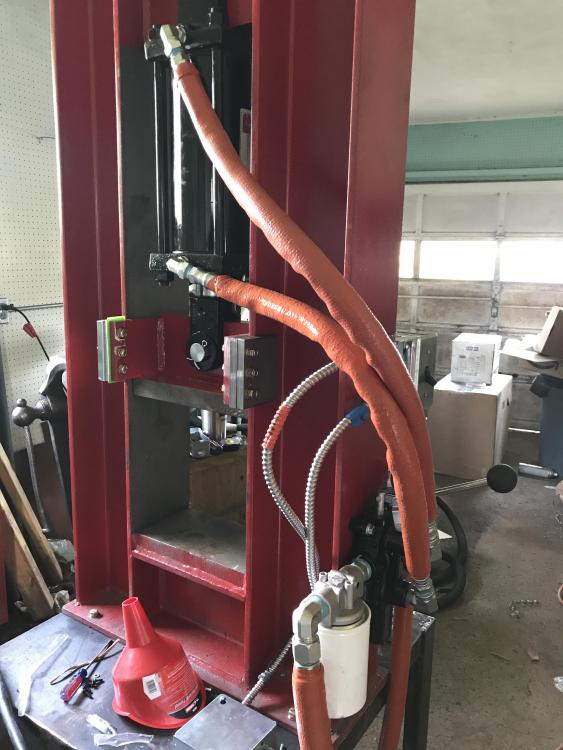

  2. The filter is on the return line, not the intake line. You suggested to put it on the pickup line. Is that not the intake? Sorry if i'm not understanding what you mean. I appreciate your patience! I'm asking because i have done everything according to the manufacturer's instructions, and I am having a problem. I lack the testing equiptment to see what the pressures at the filter are when it's in use. so I was hoping that someone might see something that immediately looks off to them, or who have had a similar problem. Thanks for that. Yeah yeahs, ill get a tripod lol. I have ordered a new filter and manifold, so I am going to try replacing the whole housing. THanks very much for the input! Thanks very much for the input. Its the nature of a forge press to have those pressure spikes, and that was a concern going in to it. I will check out the back pressure tomorrow, and get back to you. I don't know why I didn't think of that.

  4. Hello!! i am having a problem with my hydraulic press. After normal, periodic use, I blew out a filter and thought the filter must just be defective. But now the new filter is deforming, and I don’t know what the problem is. I made a YouTube video explaining my system, and the problem more in detail. Any advice anyone could give me would be amazing. Thanks for your help. -joshua

  6. They are wrapped in protective fire sleeve in case they accidentally come in to contact with hot steel. I thought it was a necessary safety feature given the environment they are operating in. -joshua

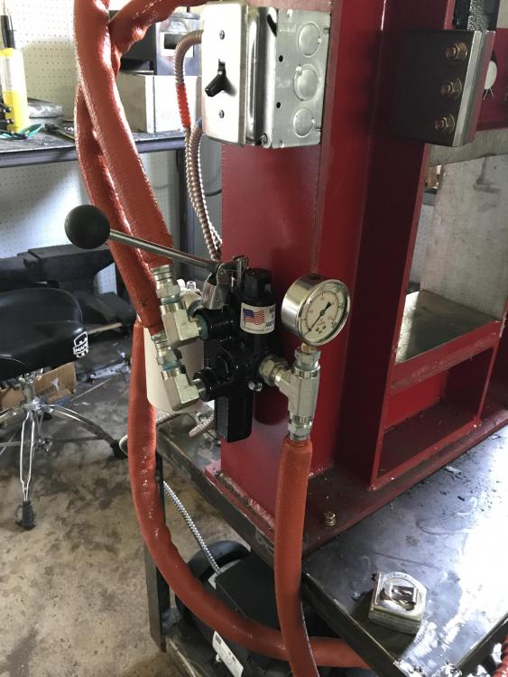

  7. Omg DUH. I can’t believe I didn’t think of the volume of the rod taking up space in the cylinder on the return stroke! Thanks for pointing that out. Now I feel like an idiot. I don’t think it’s a problem with the valve, although I’d love a power stroke option too!! And I don’t know, maybe the action of the lever is something that I can get used to. Your point about safety is well taken. Thanks very much for the reply!! -Joshua
  8. I’m running the system at about 2750psi. It’s a 5” bore, 2” ram, 8” stroke.
  9. Hello! I have a question about a 4-way directional control valve. I have build a forge press for my smithy, and I’m wondering if there is a power stroke port on my control valve. The system is a 25 ton press, but I don’t feel like I am getting the power that the system is designed for. I’ll attach some pictures. I’m wondering if I have my hoses from the control valve and DA cylinder connected correctly. I installed everything to the manufacturers specifications. Also, regarding the control valve, I have to lift up on the handle to articulate the cylinder downward, and push down on the handle to articulate the ram upward. Can I reverse the hose positions on the control valve ports to reverse the direction without sacrificing tonnage force? Is the force equal on both ports? I think I remember reading something on the cylinder spec that the return stroke is much less powerful than the pressing stroke. Any help would be greatly appreciated. Than you!! -Joshua Frost
