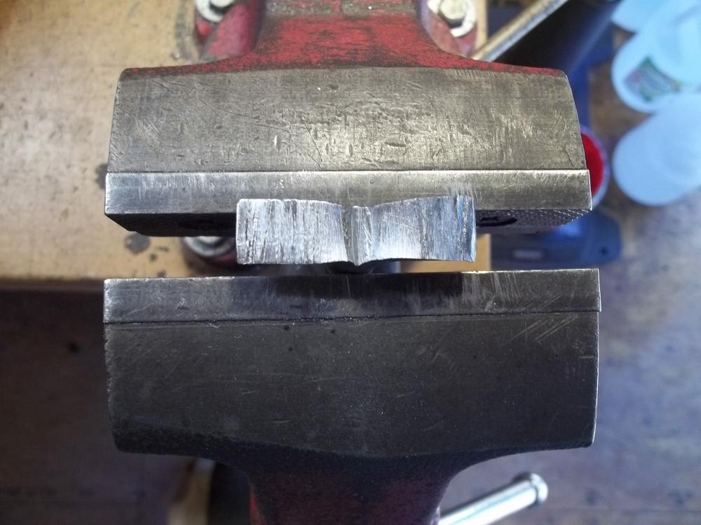

So I have been working this scrap metal it is rebar that was in a WW2 tank factory and when I was working it is noticed an odd texture under a top layer of metal. I have not worked with wrought or seen it so wondered what people thought about this.
Thanks,
Zeroclick

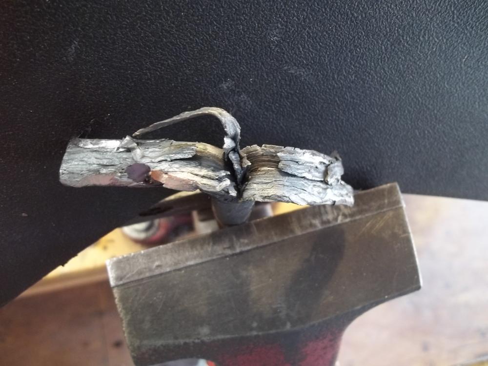

Take a little bit of a longer piece and cut half way through it about 2 inches from an end then chuck that in a vise and bend it over.  Wrought iron should bend and tear like a fibrous structure instead of breaking clean. I'm not sure if all wrought iron is like that but that's what I have seen it do.

The longitudinal striations, clearly visible in the photo, are often but not always indicative of wrought iron.  It could just be abrasion or funny corrosion from the concrete.  Those striations are what most of the other posters are referring to when they say "grain".  When talking about the antique material of wrought iron this is correct terminology, and it is visible to the naked eye.  "Grain" in modern steels is generally not.
I have taken (and passed!) college level material science classes AND forged a lot of wrought iron over the last 25 years, and that looks like it could be wrought to me.

Some comparisons of wrought iron and mild steel.  The WI has striations on the weathered surface and fibrous texture on the split sample.  The mild steel has a fine crystalline structure, not fibrous.

The higher the grade the wrought iron the more difficult it is to tell by rust striations; very high grade wrought iron can have over 250000 slag spicules per each cross sectional inch---a bit fine for eyeballing!  (number from "Wrought Iron Its Manufacture, Characteristics and Applications"  James Aston and Edward Story)
And that's when it hits the acid bath and a little magnification. However,  I didn't need it for the original picture.
I do have some bridge material that I have to test that I've wondered about for a while. You've inspired me to take a look. 100_0347.thumb.JPG.f5d2bf9daf59f2b5e5866407a0c888cc.JPG100_0889.thumb.JPG.36ba0728756ea30f6830e95bc7fe6b34.JPG100_0888.thumb.JPG.93b6dcafdca970b0fb0ce4b72f52d197.JPG
I've run across a few pieces where they have bushelled some steel in with the wrought iron and have both types of break in the same spot on a piece. I try to have one of those as a show&tell piece as the greenstick and "salt grain" breaks can be shown side by side.
