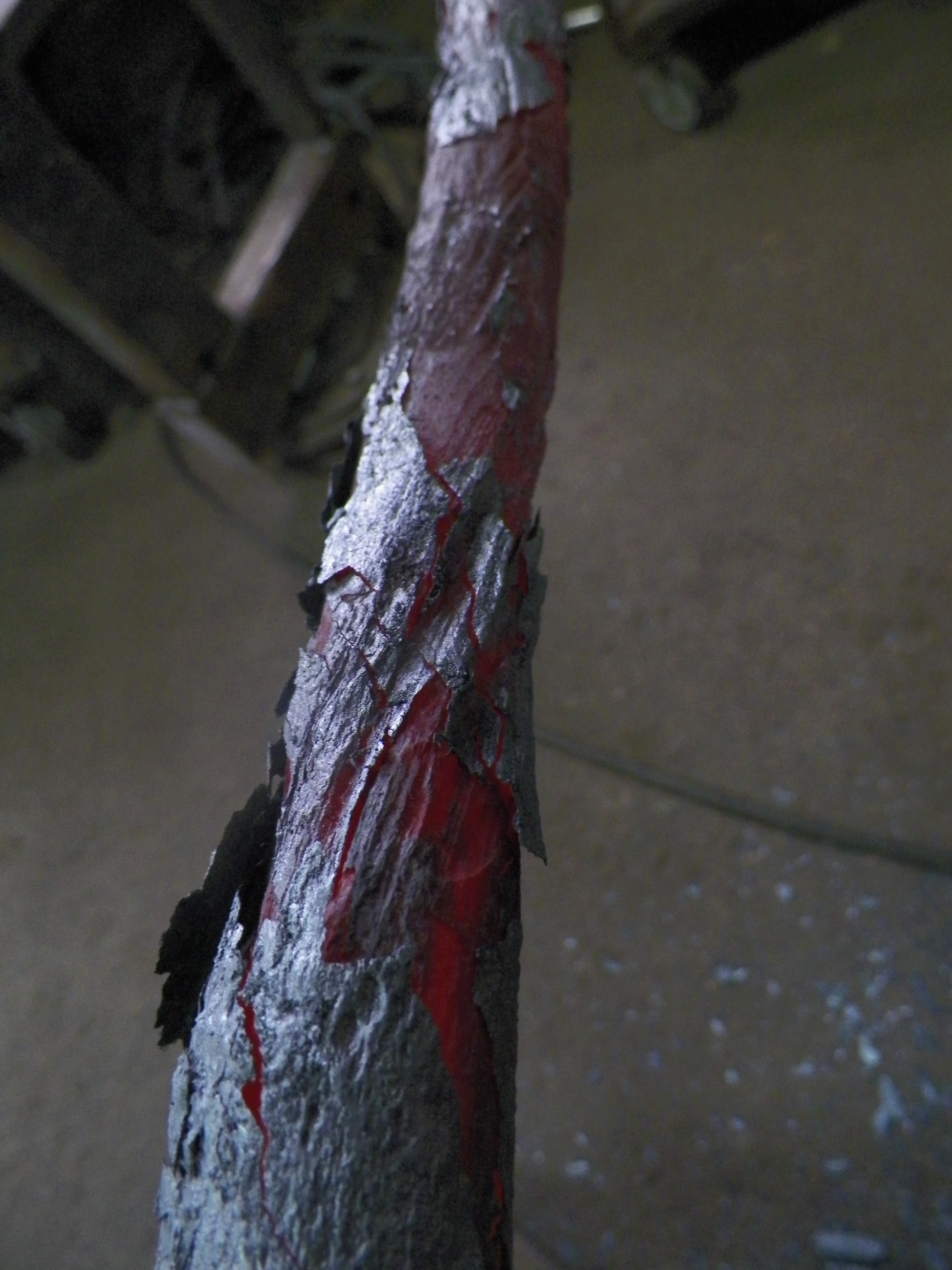

  5. And that's when it hits the acid bath and a little magnification. However, I didn't need it for the original picture. I do have some bridge material that I have to test that I've wondered about for a while. You've inspired me to take a look.

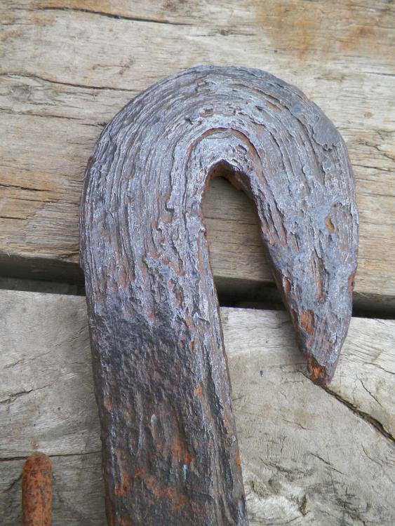

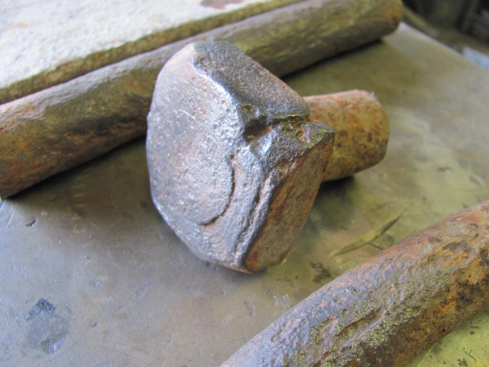

  6. Wow! Saucy smiths are we! I can indeed spot the "grain". No Xray eyes needed. After a short amount (a ton or two), you learn to spot the difference between a directional blemish that may suggest wrought fibres and the real thing. Not all wrought is exposed by a spark test. Acid etch end "grain" and sides.
  7. It's wrought. I believe I can see the grain.

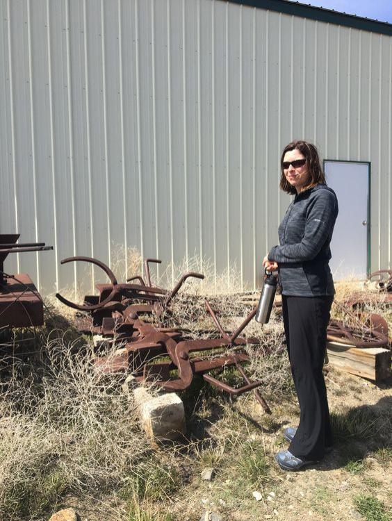

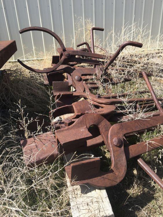

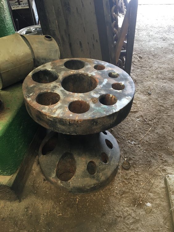

  13. Wroughton posted a topic in Swage Blocks
    I went to see a collection of XL blacksmith tools this weekend. Here's a few pictures. Anyone seen a swage like this before? I was wondering if it was for making huge J bolts. There's an extra large swage block and pattern also. I was so addled by all the piles I didn't get a picture of the actual swage, just the pattern.
