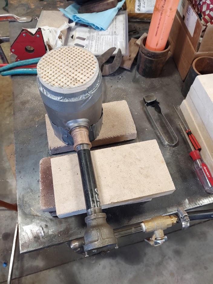

Donniev Posted March 28, 2020 Share Posted March 28, 2020 Finally got a ton of time off, getting back to this. I've got 2 sets of 14 holes on either side of center, I didn't drill the center two holes instead of using a diffuser (tho as frosty noted he didn't use one anyway) seems to be running ok for now. I've got to get a mock up made of my forge tonight so I can stick this in and see how it runs inside the forge. So far it looks ok to me, unless someone smarter than me sees something amiss I'll keep plugging away Quote Link to comment Share on other sites More sharing options...

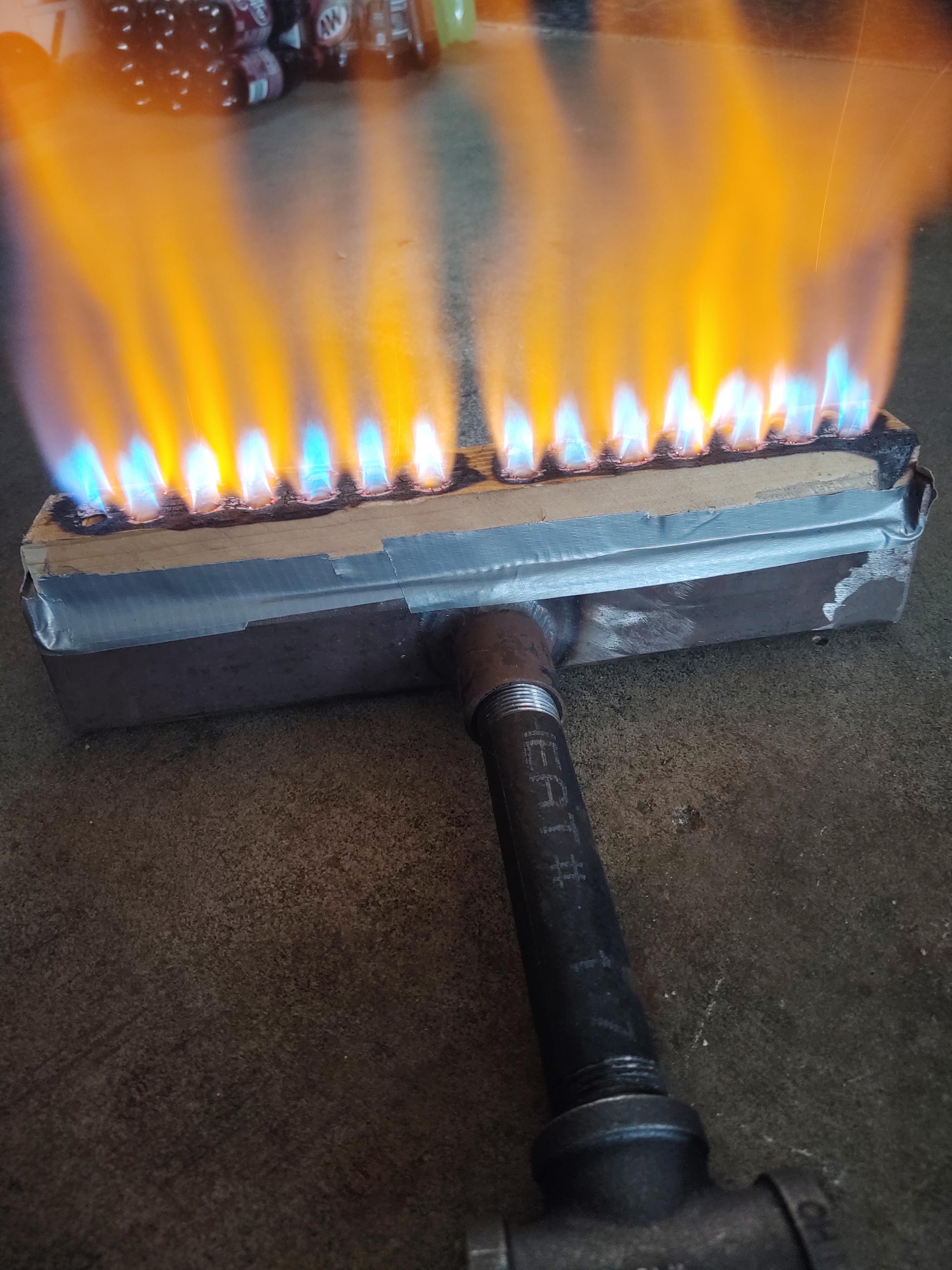

Donniev Posted March 29, 2020 Share Posted March 29, 2020 In thinking about it again I think I'll scrap that 12" burner and just go to what I know works already since this is my first gas forge. KISS right? Anyway first pic is at 5 psi 2nd is at 10 psi 7" long, 19 holes Quote Link to comment Share on other sites More sharing options...

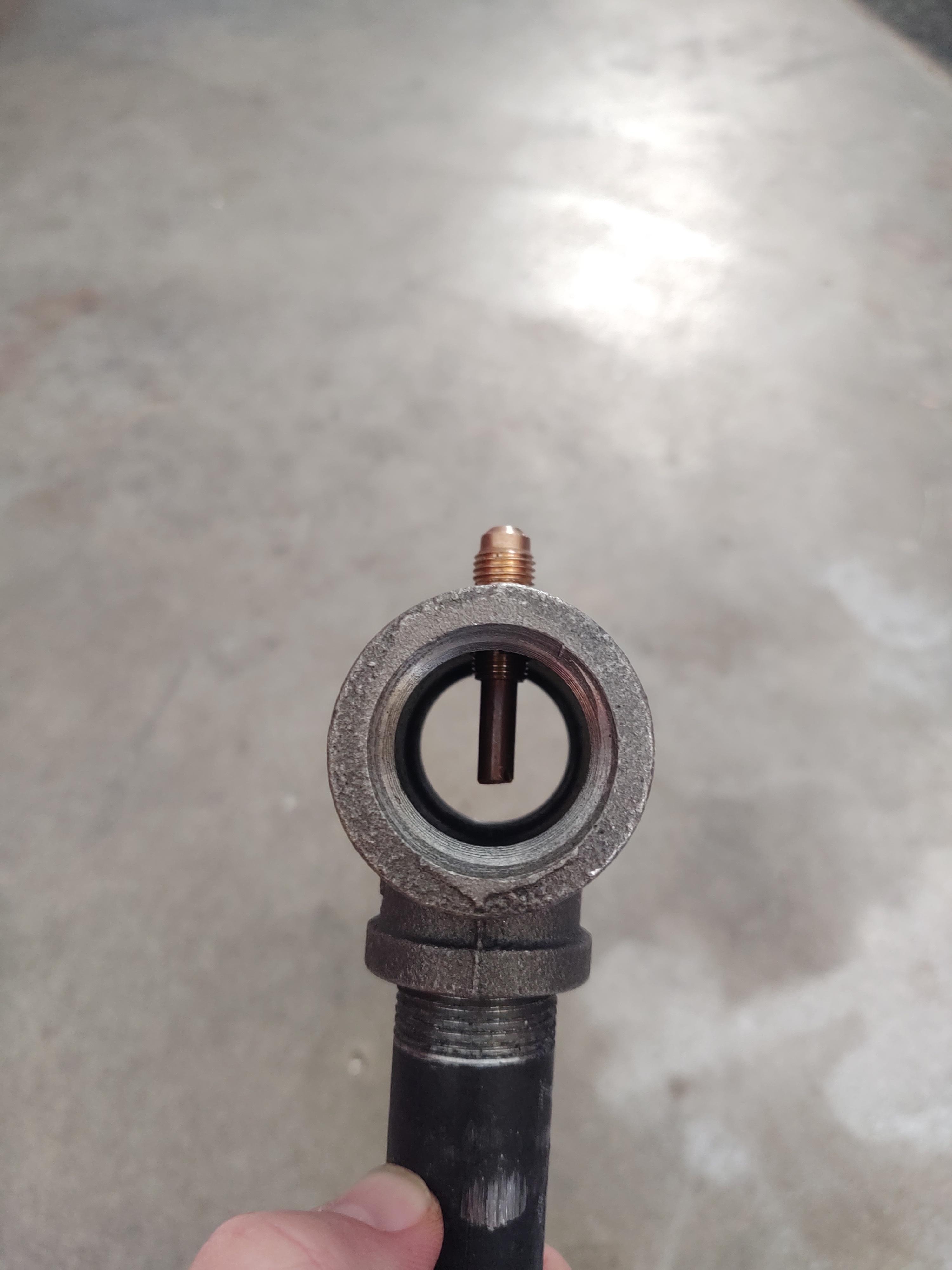

Frosty Posted March 29, 2020 Author Share Posted March 29, 2020 That is burning very rich, dangerously so in a closed building even if the vehicle door is open. That color yellow is NOT the calcites in the refractory, it's propane burning on ambient oxygen. Lean that puppy out! How close to the throat is the jet? Frosty The Lucky. Quote Link to comment Share on other sites More sharing options...
Donniev Posted March 29, 2020 Share Posted March 29, 2020 I'd say it's roughly 3/8" back from the bull head on the T. Have I taken too much off the mig tip? Quote Link to comment Share on other sites More sharing options...
JHCC Posted March 29, 2020 Share Posted March 29, 2020 My understanding is that you want it right about at the center, but Frosty will correct me if I’m off-base. Quote Link to comment Share on other sites More sharing options...
Donniev Posted March 29, 2020 Share Posted March 29, 2020 I've trimmed it up pretty close to that halfway point jhcc mentioned, flames are not as yellow as before, does this look better? 5 psi Quote Link to comment Share on other sites More sharing options...
Frosty Posted March 30, 2020 Author Share Posted March 30, 2020 The flame is still way rich but better. Nope, trim it back till it's 1/2 way back across the intake. What diameter mig contact tip is this one? Oh, there's one important correction I need to make to an earlier post by you, REALLY important. Being able to evaluate things like flames or what a spark test means or what to draw a temper, etc. Isn't about smart, it's about experience. Some of us have been playing with and tuning these things a long time and just know what we're looking at and why it's doing THAT. It's not smarts, it's a little knowledge and a lot of practice. What is smart is asking about something you're not sure of, listening, adjusting and asking again. That my friend is SMART! Remember only adjust one thing at a time, then test make comparisons and notes. One thing at a time or you'll never know what did THAT and you're lost. Been there done that, happily I was really young and got straightened out. Well as much as I straighten out. Frosty The Lucky. Quote Link to comment Share on other sites More sharing options...

JADF Posted April 17, 2020 Share Posted April 17, 2020 Been lurking on her for awhile and tried my first burner. Was pleasantly surprised. The info you guys provide is great and I look forward to getting this forge done and in use. Planning on building one of Frosty's tee burners for it. Any input would be appreciated. Thanks JADF VID_20200416_182400813.mp4 Quote Link to comment Share on other sites More sharing options...
