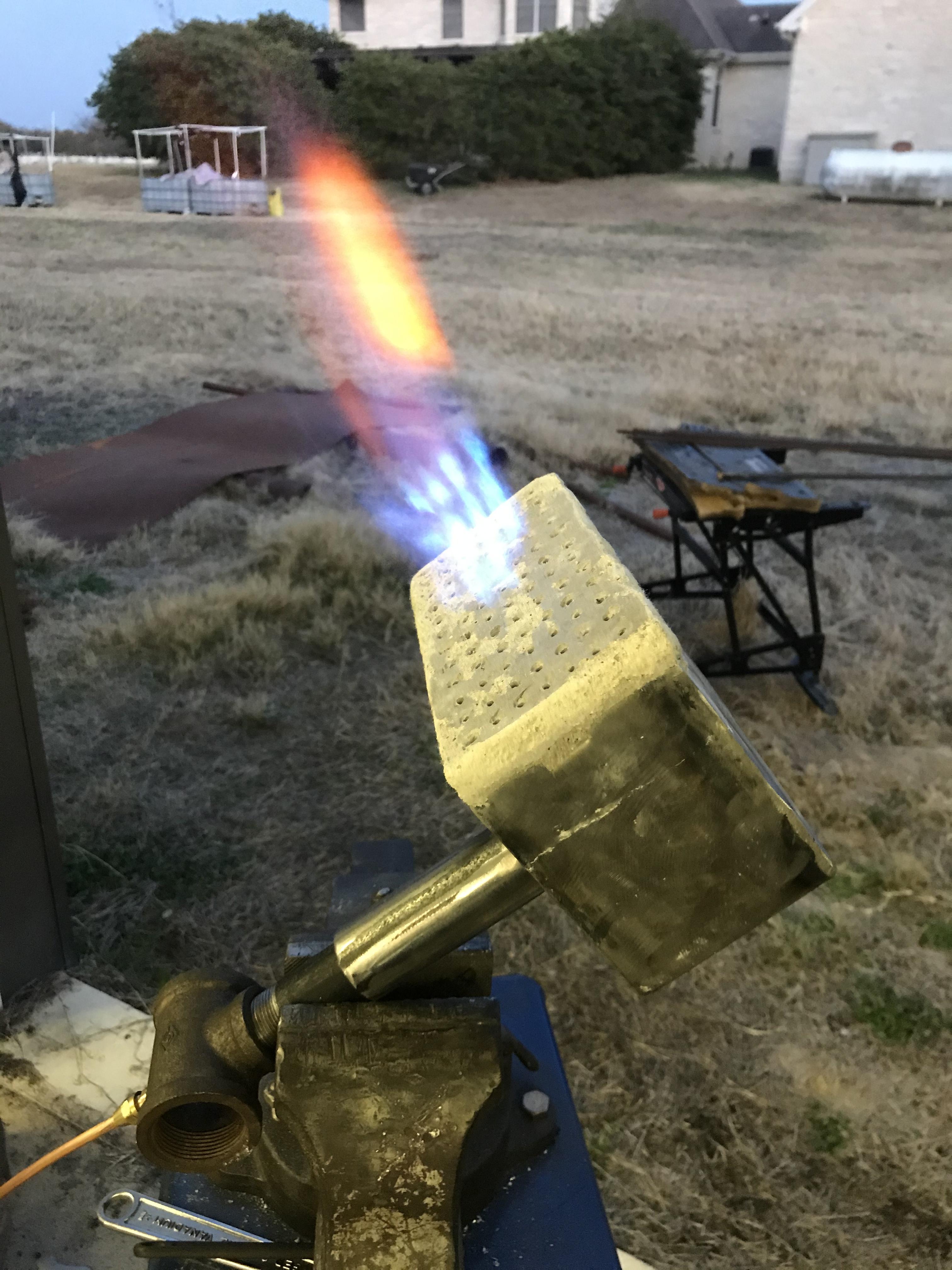

Ok, I’ve reached that phase of the project where the question of “are we having fun yet?” Has a definite no answer!  :)  But, I’m hopefully getting close.
I’ve got the forge built and lined with blanket, rigidized, and Kastolite 30.  I’ve got the Narb built after the first having a failure and loss.  And I’ve fired it for the first time to lackluster results and need to tune further.
I’m using a 1” tube with 1x1.5 T, .45 Mig tip.  I started with MIG tip dead center.  Didn’t like the flame, so I shorten it to where you see it in the picture.   The ribbon burner out of forge picture was with the Mig tip in the center.  The burner in the forge picture is the shortened tip version.  The ribbon burner is 84 1/8” holes.
First time I’ve ever fired it, so some of the orange flames could be the green Kastolite.  But it definitely not the right mixture.   Increasing the PSI didn’t seem to make much difference.
i have a 1x1.25 T ready to go, so will likely try that tomorrow.  Also need to try a new tip and start from the beginning.
i see now what you guys have said about pictures not accurately representing reality.   The Narb outside the forge seemed to have most holes with a flame, and they were almost entirely blue.  In both places, the flames were a good half inch off the surface of the burner.
any thoughts for tomorrow’s next steps?
I don't think you have enough ports.  Dan has 123 ports at 1/8th inch for his 3/4 inducer.  You are attempting 84 with a 1 inch.  That is why your flames are lifting from the block.
Perhaps.  After I make the other changes, maybe I’ll try enbiggening the holes and make another burner.  At 84, the density already feels very tight.  The process is surprisingly stressful trying to keep the spruces aligned, etc.
That's way too much T for that little burner block. Mine worked best with 19 ea. crayon sized outlets pushed by one 3/4" T. Dan tried 1/8" outlets pushed with a 3/4 inducer and settled on 123 of them, that's about 6x the outlets for the same sq" of burner tube.
If we follow that trend then doubling the inducer sq in and pushing 1/8" outlets I get a top of my head guesstimate for starting experiments at around 250 outlets.
Turning up the psi won't lean the flame out enough to matter. That size inducer feeding that few outlets is probably suffering severe back pressure.
I have a minor difference of opinion on this, but down the same trail.  Try the easy things first.  Change out your mig tip to a smaller one first.  Your "in the forge" pic has WAY too much fuel compared to the air.

Yep, I appreciate it.  I didn’t have much time today, so the only thing I got done was changing to a .25 tip from the .45 tip and it behaved much better.  The sound was much more what I was expecting and it was hotter.  Still not right, but changing the tip definitely improved it.  I noticed my regulator had a slight leak, so had to hang it up.  Ordered a new one and will resume later in the week.  Pic attached, but it was pretty bright out, so hard to see the flames.
On 11/17/2019 at 6:13 PM, Whiskeymike said:
84 1/8” holes.
J.Gonzalez made his with 90 holes @.125" and messaged me the other day that it's working fine.  You're 1" burner is just oversized for the number of holes you have.  Switch to a 3/4" burner and it may work just fine. See my discussion with J.Gonzalez over the past page or two.  I'd suggest a stock 3/4" Frosty 'T' burner as a starting point - that gives you access to the creator himself if you need help tuning it.

Frosty's territory for the 'T'.  But yes, in general the gas/air mixture and performance of naturally aspirated burners is defined by a number of variables such as jet size, mixing tube size (both width and length), intake size, jet placement, Nozzle size and length.  They all interact and, within some mysterious tolerance, all need to be right to get good performance.  Generally, if you increase the size of the mixing tube, the jet size needs to increase, as well as the intake size.  You are basically scaling up or down the whole burner.  What is recommended is the result of lots of peoples experiments, and a lot of trial and error in the community.

Whiskymike: YES diameter and length make a difference, everything's a ratio based on tube diameter at the throat. The throat is the narrowest part of the bore where the tube begins. In the case of a T burner it's the end of the mixing tube where it screws into the T.
The ratios are listed in the instructions post. If you just follow them the ONLY tuning adjustment necessary is the length of the mig contact tip jet.
You are reading so many opinions from folk who have no idea how a NA burner works but have managed to make a flame sort of. They have an internet connection and a camera so they're experts. Ron Reil won't even respond to questions from folk who won't follow his directions, he lost all patience trying to help correct problems caused by not following the directions.
Pick ONE set of plans and follow THEM. I don't mind helping but you're all over the landscape, I point out one problem and you change something else. Hmmmm?
